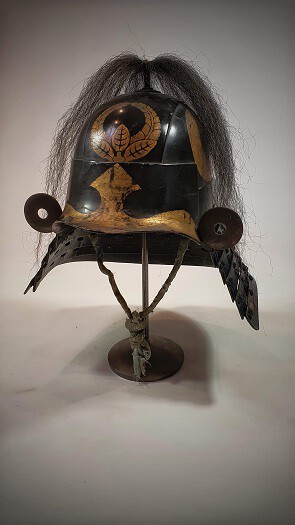

I deleted my post. And I've been musing over your comments for hours. (Although I think my lacing was pretty on the money).  I think there's another perspective. I read this a couple of months ago posted elsewhere by Dave Thatcher.
I think collectors need to understand that having an item restored traditionally is no longer their choice. Katchushi have not been supported enough over the years which has prevented younger people wanting to learn the profession. The result is that there are now less than a handful of competent katchushi remaining. The good ones are fully booked for many years in advance which only leaves the dross who will not be able to make such a good job. Skilled Katchushi also know that they can make more money from buying and repairing their own items for sale rather than take on commissions from others.
Discarding the cost of restoration even to have a skilled katchushi actually accept your item and work for you has now become a very luxury. My advice when buying is only to buy the best you can at whatever you can afford, or to buy something that has been restored. Katchu is designed to be maintained, with no maintenance it self destructs over the years and any investment you have goes with it.
So for most of us, having items restored professionally isn't an option so people will continue to do it themselves. Rather than frightening them off and turning them into closet restorers, going for a can of automotive filler and black two pack spray gloss, isn't it better to give advice and help? If it's the wrong advice I'm sure someone  like Ian B that knows better will jump in pretty fast.  Stef's lacing is pretty ordinary and people have been quick to tell him. he says he's going to give it another go and hopefully with advice, he'll do a better job. And at least he's consolidated all the parts of his kabuto!.
Just food for thought.
JB
Although, I wonder if the top band is missing from the shikoro? I'm by no means and expert.

Allow me to interject the following three principles according to David Thatcher's Katchushi Koubou about preservation,restoration and replacement wich I myself abide to,using this Kabuto Dave recently did,as an example of the first step any restorer should take.
Step 1) Preservation.
             Conservation work includes cleaning,repairing and consolidation of Urushi laquer.
Step 2)  Restoration.
              Where damage has exceeded any preservation process,thethe item can be restored,for example,rebuilding damaged Urushi,or in this case restoring the Odoshi.
Step 3)   Replacement.
               When an item has parts that are either missing or too severely damaged to repair,they can be replaced.This is the case with silk lacing and the silks used
               on armoured sleeves and thigh guards.Often with helmets,the original liners and cords are missing.Vintage materials or authentically produced substitutes
               can be sourced for missing components.
I think this Kabuto is an excellent example of history being preserved.With the Hachi having it's Urushi carefully consolidated to prevent further damage from
occuring,yet the Odoshi has been symphathetically replaced and aged to look in keeping. I totally agree with Dave's approach and adopt the same priniples.
