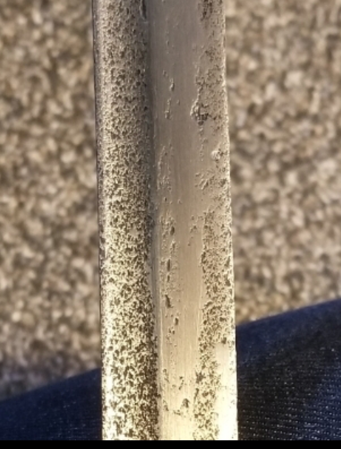

Started working in the first of these today and found pitting underneath a bunch of the gunk. Theres a decent amount both on the shinogi-ji and in the bohi. Now I'm not sure what to do exactly. Would one suggest I sand them down? Does anyone know if the surface of the swords is just polished steel or is it actually burnished? Does anyone have any suggestion about grits, products or strategies for repairing a sword like this as much as possible? Also where is the line where I should stop repairs and just let them be? Thank you for anyone who advises me through this.
I have done tons of work with cosmoline … easiest and safest way (I found ) is boil a big pot of water and place the sword tip into heat … metal heat is conveyed and it just wipes right off.    It's safer and easier than other methods I have used.   I have done entire gun barrels and as long as you get a few inches into the hot water, it should work
Adam - you can't fix pitting without modifying the sword design ... Here is a thread where I re-furbed a type 95 NCO Sword that was in SERIOUSLY bad shape, actually almost rusted to the saya.   I had a professional bladesmith (and forged in Fire champion :) ... take a look at my work during endgame and he cautioned that I could do no more on the pitting without damaging the original blade shape/design.   See link for sanding, etc....   Dan

Dave R, yeah, beyond the basic bummer about the pitting I'm fine with it. Have the desire to work on them over the next few weeks so developing that plan of action. So far all I've done is used pure alcohol and hot water with a nylon brush. Pretty much revealed what I'm working with and while not pretty it's still quite a functional and sharp sword. I'm not going to aim for removal of all the pitting as it's impossible without removing too much nikku but I'll get them to a stabilized position. Try to pretty them up a bit.

I truly respect what you guys are doing by discouraging DIY polishing, and understand why it's a really bad idea. But have you guys clicked on any of his pics and enlarged them? If this blade were a nihonto, you'd be saying "Total write-off. This blade is worthless." and I have heard it said by many on these forums. If I had the search skills of Thomas, I'd pull them up and quote each of you on that.
And this blade is worse off than any of them.
So if a blade is "ruined" and is not worth resoration (in other words - trash) honestly - what difference does it make if a guy tries to remove some of the destruction? I personally think he is honoring this blade by his efforts to try to give it a little dignity back.
Yes, if another rookie sees what he is doing, would he naively be encouraged to do the same thing to his newly acquired rusty nihonto? Possilby. But you've clearly discussed why that isn't good to do, so unlikely.
I wouldn't do metal-work on any of my 95s or 32s to remove rust spots, but they are good blades. Adam's is truly a "gonner". I don't see his work as anything but an effort to save what he can of a destroyed blade.
