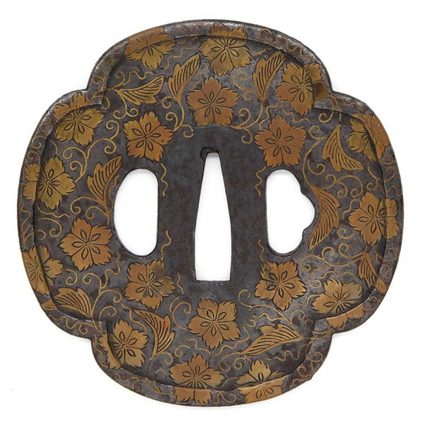

zanilu Posted January 28, 2020 Report Posted January 28, 2020 Dear All This post is mainly due to the pit of ignorance I have found myself in all of a sudden. When I found this tsuba listed on Aoi Art website I though, well here it is a nice Heianjo Zogan tsuba worth to be added to my collection regardless of the Washida school attribution reported in its description. At first I considered the attribution to the Washida school a clerical error in the compilation of the web page. This attribution is confimed by NBTHK though, as I got from a quick translation of the relevant kanji in the paper. What am I missing here? What is your opinion about it guys? Is this one of the revival pieces made in Heianjo Zogan stile at the end of the Edo period? The few information I have found on Washida School mention nothing about Heianjo Zogan and the examples I have found do not look like Heianjo Zogan at all... If the attribution is right what points lead to it and not to Heianjo Zogan? I need some enlightenment! Regards Luca 3 Quote
Guido Posted January 28, 2020 Report Posted January 28, 2020 The inlay being more or less flush with the surface, the dote-mimi, and color and texture of the iron indeed point to Washida. IMO a school that is quite underrated, I have seen some great tsuba with that attribution (and own one of them). 4 Quote
Brian Posted January 28, 2020 Report Posted January 28, 2020 I definitely prefer this to your average Heianjo. Think you did well. 3 Quote

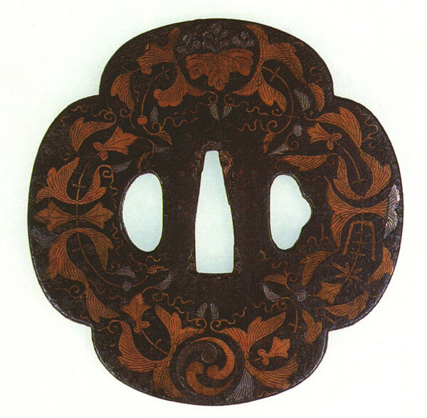

zanilu Posted January 28, 2020 Author Report Posted January 28, 2020 Guido, Brian I do appreciate your comments. What really nags me is the fact that this tsuba looks to me in most aspect not different from other Heianjo tsuba I have seen around or have in my collection. I will do some comparative study as soon as I find some spare time from everyday life... Guido you mentioned the mimi, the color and texture of the iron and the hira zogan as distinctive point for Washida school. Do you have some reading material available on that school or you can point me to some sources, or it is based on your experience? If you are willing can you post some pictures of yours? By the way I have found this tsuba also attibuted to Washida (http://world.seiyudo.com/product/tu-040517/). Also from MFA (https://collections.mfa.org/objects/11916). I am really thrilled... Best Regards Luca 2 Quote

ROKUJURO Posted January 28, 2020 Report Posted January 28, 2020 After what we see here, it seems that WASHIDA are a lot finer and more detailed than the average HEIANJO TSUBA. The workmanship shows a much higher level. Very nice!The one offered by SEIYUDO reminds me a bit of UMETADA MYOJU. 1 Quote
Brian Posted January 28, 2020 Report Posted January 28, 2020 I was also going to say the difference seems to be more care and fine inlay, with more detail. Heianjo seem more "rustic" whereas this seems to be done more carefully and more decorative.Less "wabi sabi" and more Kyoto tea-taste? 2 Quote

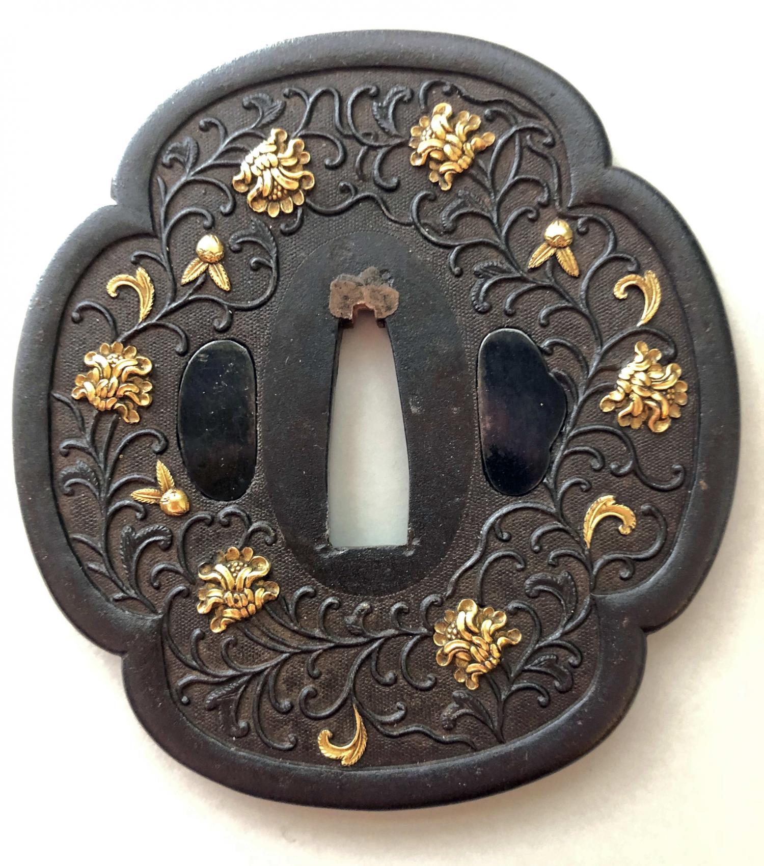

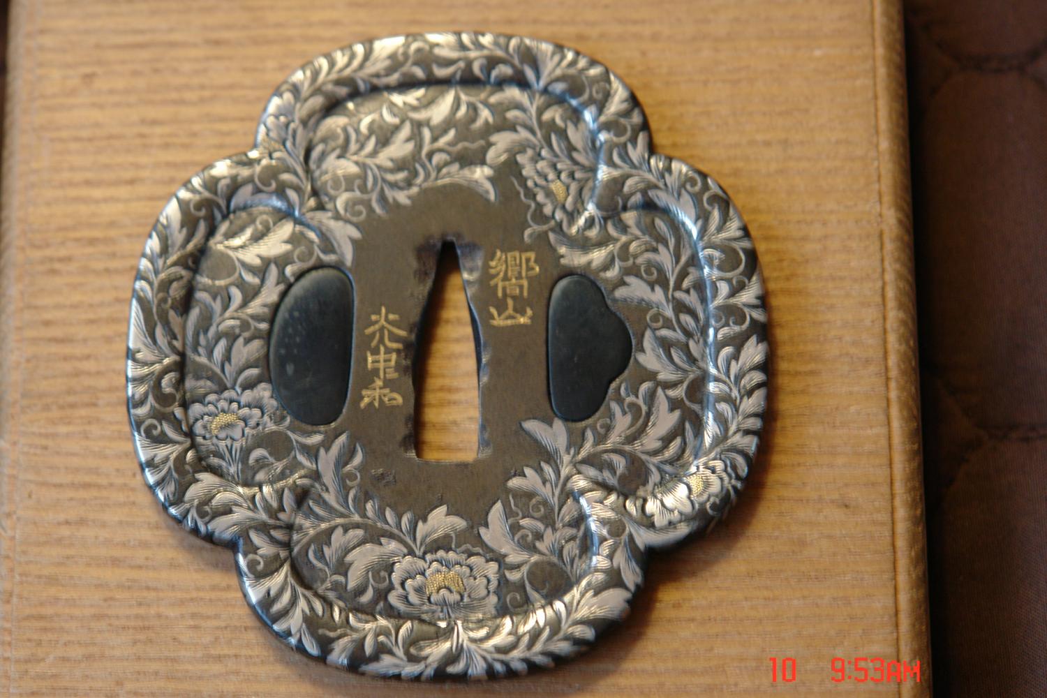

Guido Posted January 29, 2020 Report Posted January 29, 2020 Information about the Washida-ha is rather sparse – the most I could find is written in Satō Kanzan’s 庄内金工名作集 Shōnai Kinkō Meisaku-shū; as John already mentioned, Washida was part of the Shōnai group. Besides the deep brown, dense iron, dote-mimi, and flush inlay, I forgot to mention another trait: the ura is very often treated as elaborately as the omote. Many Washida tsuba are unsigned. A prominent maker was 光中 Mitsunaka – however, Hagihara-sensei told me that the proper pronunciation of those kanji is "Kōchū". He was very prolific, and actually worked at many places. Here’s a tsuba of mine, signed Uzen Shōnai jū 羽前庄内住 Watanabe Kōchū 渡辺光中 + kaō in gold (tokuho). I have another Washida tsuba, but it’s mounted on a koshirae; I’ll take pics tomorrow. 9 Quote

Ken-Hawaii Posted January 29, 2020 Report Posted January 29, 2020 That's gorgeous, Guido. From your photos, I get the impression the seppa-dai & surrounding area is relatively thin, right? Quote
zanilu Posted January 29, 2020 Author Report Posted January 29, 2020 Nice piece Guido! Thank you for the additional information! Luca Quote

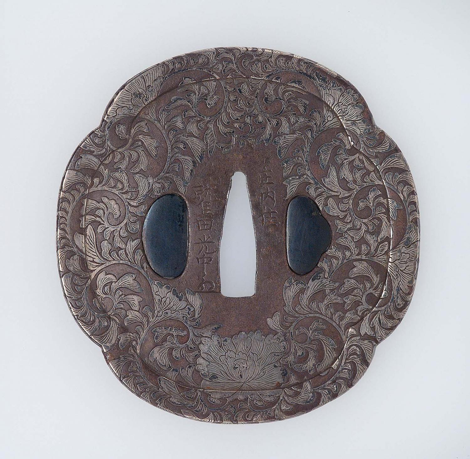

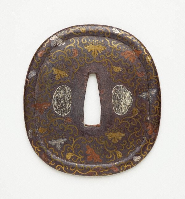

Ford Hallam Posted January 29, 2020 Report Posted January 29, 2020 There was a Washida tsuba, non ferrous, of butterflies, really complex multicoloured hira-zogan, on display in the now closed Tosogu Museum in Tokyo. It was actually unfinished, patinated but lacking any engraved final detailing. Apparently, he died before he could finish it and his son vowed to strive to reach his fathers skill to complete it but it seems he didnt feel up to it. I cant remember which generation it was though. I don't have the catalogue to hand but if someone does have it's illustrated in there. This one was sold by Ginza Seiyudo And a signed one in the MFA, thankfully not over cleaned. 3 Quote

Guido Posted January 29, 2020 Report Posted January 29, 2020 On 1/29/2020 at 7:07 PM, Pete Klein said: https://www.tsuruginoya.com/items/f00205.html I knew I had seen one here some time ago. Thanks for the link, Pete, that's actually my tsuba, I didn't know Tsurugi no Ya had it on their website! It came with the mentioned hozon papers, but I got it "upgraded" to tokubetsu hozon. 2 Quote

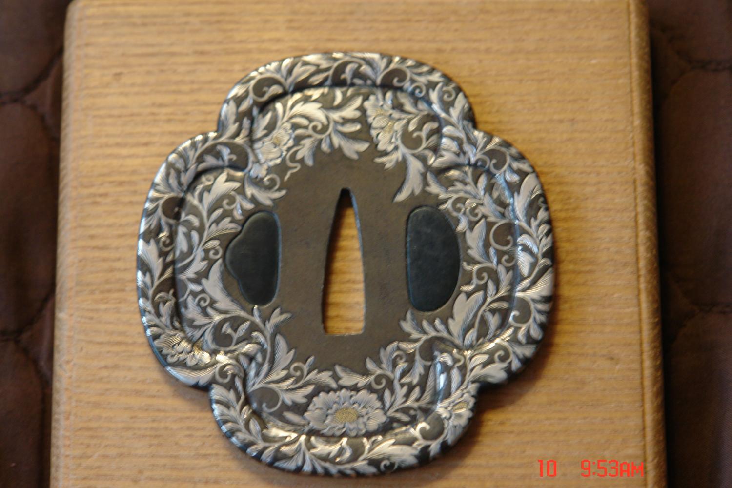

Ganko Posted January 30, 2020 Report Posted January 30, 2020 Here is another. This guy did some really nice work. There is a two part article on Shonai Kinko in the NBTHK Token Bijutsu vol 55 and 56/57 in English. 2 Quote

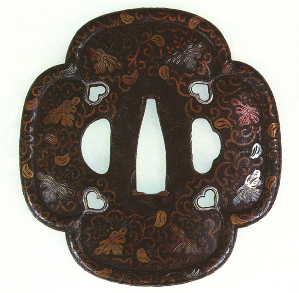

zanilu Posted January 30, 2020 Author Report Posted January 30, 2020 Wow! This tread is looking better and better at every post. With reference to the first tsuba posted by Ford (on Seyudo site) it looks similar to one in my collection: And to others attributed to Yoshiro in in the Sagagawa City Museum's Aozu Yasushi Collection http://is2.sss.fukushima-u.ac.jp/fks-db//txt/20011.002/html/00029.html or at the NSW Art Gallery https://www.artgallery.nsw.gov.au/collection/works/436.1996/ Even though the workmanship looks cruder (at least on mine for the others the pictures are not so good to judge). What do you think? Yoshiro? Not Washida... Luca 1 Quote

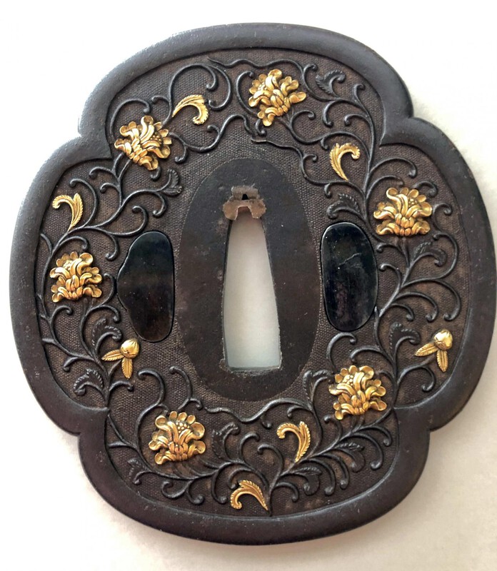

Guido Posted January 30, 2020 Report Posted January 30, 2020 Here's my second Washida; a little different from the others in that it has no hira-zōgan or kebori. And I think it was no small feat of the maker to apply the tiny nanako on an iron ground - but Ford will know if it's a lot of work, or kind of a "yeah, do it all the times on rainy afternoons" thing. 12 Quote
