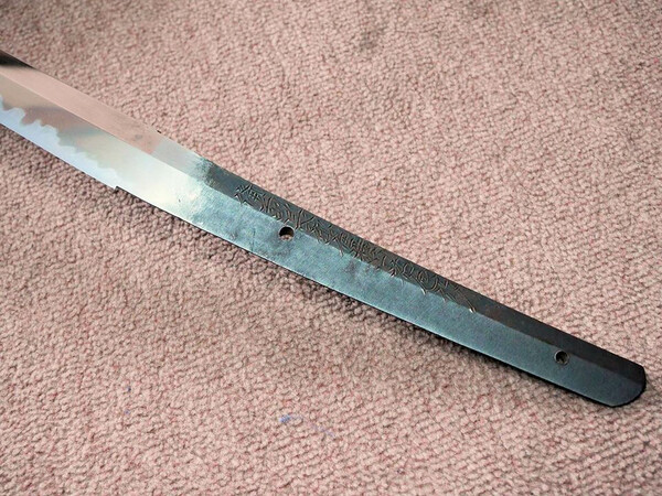

rebcannonshooter Posted January 30, 2020 Report Posted January 30, 2020 Here's a Koto Bizen, "KiyoMitsu" with a 1550 date. The bottom two ana are originals, the top one is WW2 time period to re-mount into shin gunto. Tom M. 1 Quote

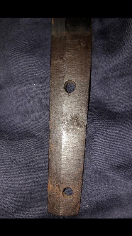

Blazeaglory Posted January 30, 2020 Author Report Posted January 30, 2020 I've yet to see a Koto, Shinto or Shinshinto tsuka with 2 mekugi ana....I can't say I've seen an actual Tsuka other than the above Gunto and others or maybe a koto Tsuka/koshirae in a book but honestly I can't say that I have seen many (or any) either. Ive seen quite a few "double ana" on Nakago but the kind I'm thinking of are different than the typical gunto or "added at a later time" for new koshirae or shirasaya. I don't know why I've got this in my head or where I even read/heard it but for some reason I've got the notion that 2 ana on Nakago (usually Koto and early Edo) were for war time use. Anyways, here's an example I have. The ana look to be chiseled and the blade appears O suriage. Quote

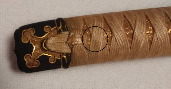

Nobody Posted January 30, 2020 Report Posted January 30, 2020 This picture shows a typical shinobi-ana on a shinshinto - Yokoyama Sukekane. 4 Quote

Blazeaglory Posted January 30, 2020 Author Report Posted January 30, 2020 koto blade1.jpg Here's a Koto Bizen, "KiyoMitsu" with a 1550 date. The bottom two ana are originals, the top one is WW2 time period to re-mount into shin gunto. Tom M. Is that Ubu or suriage? If original, maybe 2 ana were a preference of the Samurai? More often during war than not? Did Samurai have war time Koshirae vs. Peace time Koshirae? I know there were strict procedures on how to hold and transfer a Nihonto during war time vs. peace. Maybe the adding of a second Ana was more than functional? Could it also be symbolic or ritualistic? I'm just running my mouth here so don't take anything I'm saying as factual. I'm only thinking out loud for the sake of a debate. Quote

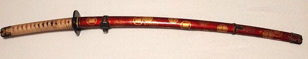

Jussi Ekholm Posted January 30, 2020 Report Posted January 30, 2020 Koshirae is not really my strong point but as I do happen to own a good selection of books, here are two original koshirae (and their blades) from Uchigatana Koshirae book. Number 63 (that gets turned sideways) - Sword made by Kiyomitsu in 1514, koshirae can be dated somewhere around Kanbun - Genroku (1661 - 1704) Number 48 - This is the first and original one (second similar one to this featured in book was copied for Heshigiri Hasebe in early 1800's) - Sword made by Sukesada in 1524, koshirae can be dated to be made between 1598 to 1604. 3 Quote

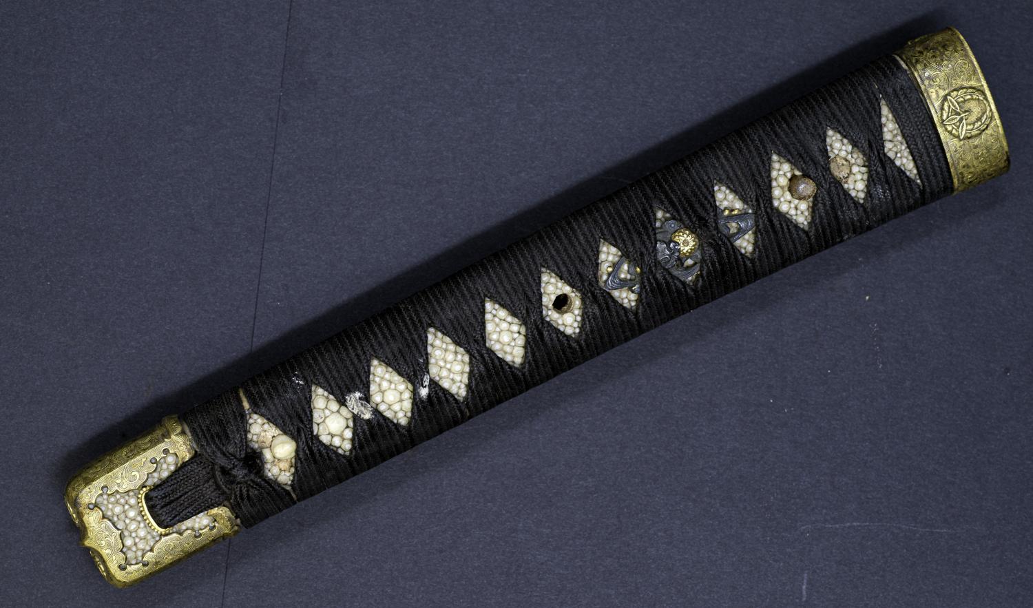

Ray Singer Posted January 30, 2020 Report Posted January 30, 2020 I don't have a photo of the reverse side of the tsuka on-hand, but this koshirae in my collection has two mekugi-ana in the tsuka. 2 Quote
Rivkin Posted January 30, 2020 Report Posted January 30, 2020 There are two mekugi coming as a set. Could it be some weird reuse of a tsuka? I don't have the blade unfortunately, so no proof, but I don't think so. Kirill R. Quote
Tom Darling Posted January 30, 2020 Report Posted January 30, 2020 Kirill, it appears to have three mekugi-ana? Tom D. Quote
Rivkin Posted January 31, 2020 Report Posted January 31, 2020 Yes, it is, but I've got only two mekugi coming with it. Kirill R. Quote
