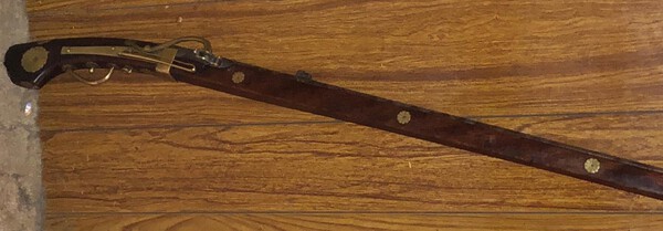

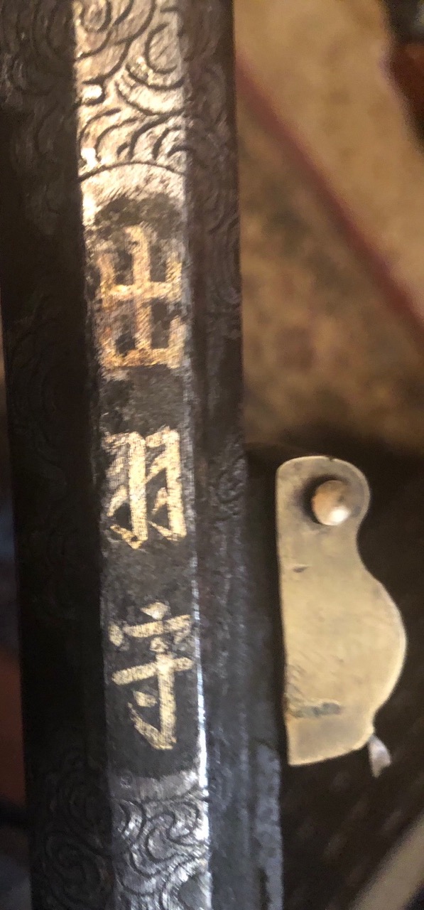

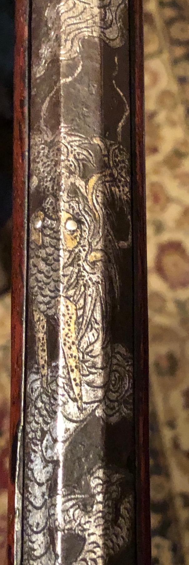

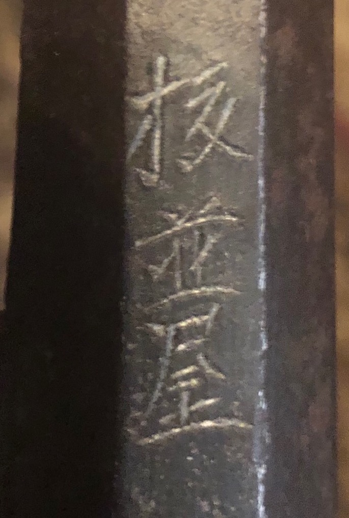

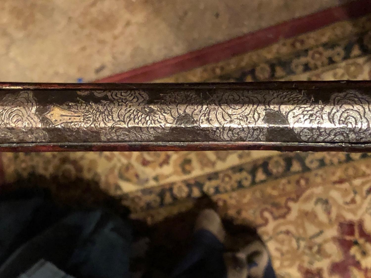

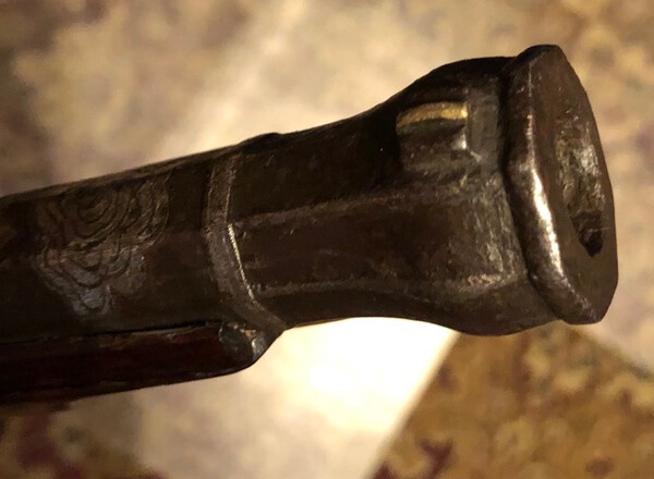

Need help with translation marked on top of barrel and underside. Top of barrel sliver and gold inlay of Dragon,fireballs,clouds and tip of spear. Any help would be great.
Thank you.
Hi, the writing on the top of the barrel has probably been added later for decoration. It says 出羽守 Dewa no kami.

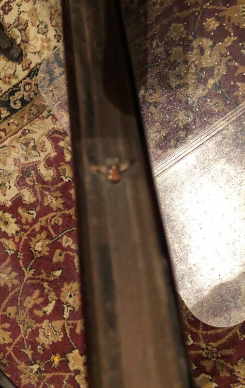

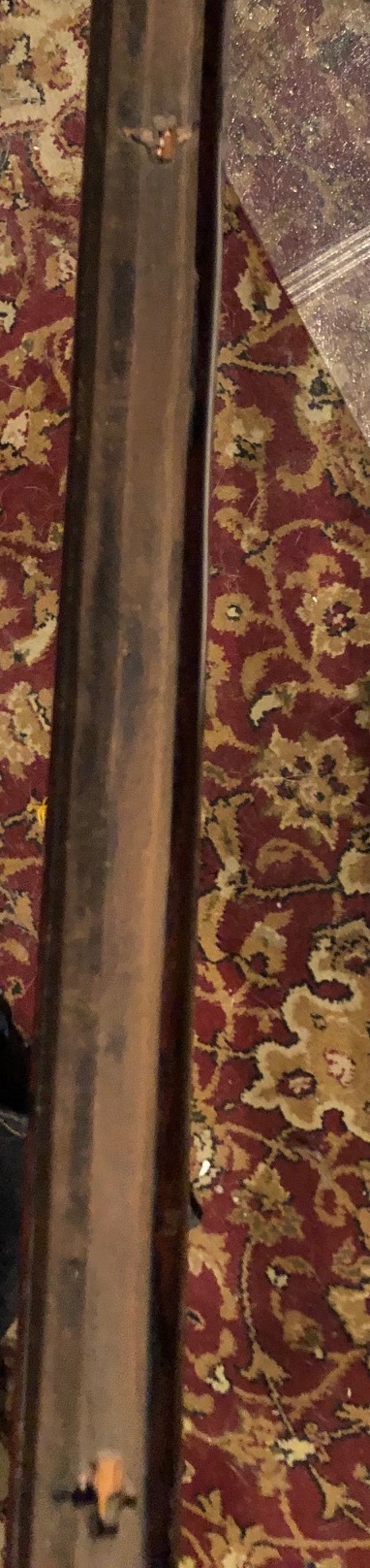

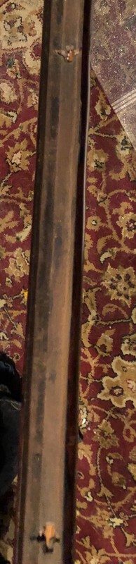

Underneath is Sahei or Sahyoei, one of the Enamiya smiths of Sakai/Settsu/Izumi. 榎並屋佐兵衛作 'Enamiya Sahei Saku'.
Protector of Dewa Province, a grand-sounding title conferred upon certain people, or later in some instances self-awarded, and later still used as artistic decoration to give the impression it was owned by a Lord or someone rich. Best to ignore that for the time being.
The gun itself (without seeing it) was probably made sometime in the Edo Period before Western guns came flooding in. Taking a stab, 1600-1850 as a start. The short name on its own does suggest a gun from the earlier part of Edo.
PS We’re a trusting lot here and use real first names and at least a real initial for the family name. ;8)
Thanks for the additional shots.

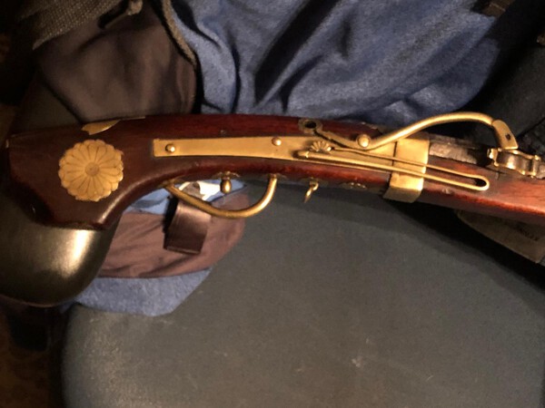

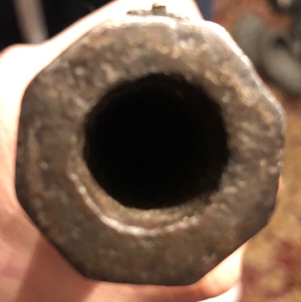

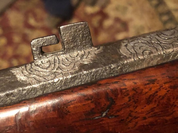

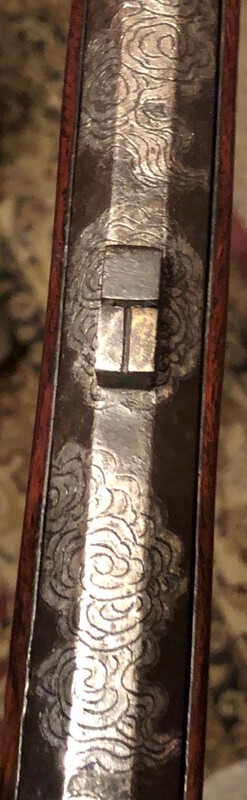

Your gun has most of the flamboyant features of Sakai (the Osaka area) which back up the signature, such as the large chrysanthemum mekugi-ana surrounds and the octagonal poppy head muzzle with silver stripes of inlay. Well-used, it is a good example of this rather smaller bore type. There should be a thread somewhere on this area of manufacture.
As to date, these were produced over a couple of hundred years, so it not really possible to pin it down any further with those shots alone. Without a lower name we have to consider that this was made by the founder of the line, which on its own might push it back to the 1600s.
Interestingly there is said to be a 6 Monme gun made by this smith in the In-no-Shima Suigun Jo, where the Murakami Suigun (pirates) have their exhibition rooms.

This is going to sound weird, but I do not think there is anyone out there who can tell you much more than you've learned in this thread. The zogan barrel inlay fancy decoration was probably added later in the gun's history. So no, I do not think it would be worth it for this specific gun. There are more detailed criticisms or words of praise that could be made, but so far no-one else has joined this thread! There is a fascinating general story behind guns in Japan which would be worth reading up on, and any history of guns in Osaka, Sakai and Negoro too.

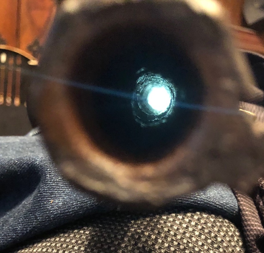

You could try (re)moving the Bisen barrel plug, and then see if the barrel is clean, and it would of course be useful to measure the internal barrel bore/caliber as that really defines its specific purpose. People like to keep a record of the overall measurement, and barrel length too.

I was able to remove plug here are some pics of plug and port.
Port is around12-13 mm sorry did not have calipers for exact.
Plug threads are 50mm long and around 12-13mm wide
Barrel is 1016mm long without plug
Long rifle with barrel in stock is1295.5mm
With measurements any ideas it was used for?
Thank you
Ace H.
Yes, they are consistent with the photographs so far. With those proportions it was probably used for game shooting by some wealthy, perhaps merchant. In this case you were luckily able to remove the Bisen breech screw. That is a relief. Needs an internal clean, though!  :thumbsup:

Normal cleaning is done with very hot water and a few drops of detergent. Use a ramrod or scouring stick. Wrap a towel around the barrel to avoid burns when handling hot iron and hot water. The residual heat will allow the barrel to dry itself. Use pressure blow around the lockwork to remove trapped water.
Your barrel is heavily rusted and pitted inside, so no need to worry too much on what type of brush you use, but copper or brass wire should be good, and steel if necessary. Be prepared to wear out good brushes in the process. Repeat hot water scouring multiple times until the water loses those red and black discolorations and starts to run clear. Allow to cool and clean bore with new kitchen towel, cloths and new brushes and when (somewhat) satisfied, polish out, applying rust preventive gun oil. Just remember, most of these barrels are heavily pitted, so do not expect miracles. If you are hoping to fire it, get it checked by a testing authority.
In all the Tanegashima matchlock barrels that I have handled, only two still had a bore with an internal partly-mirror finish.
