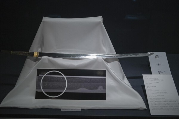

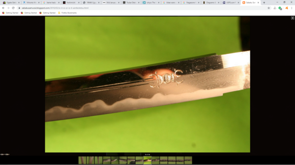

Kotetsu and his tekogane. Take a look at the photo from the blade and where to find it.

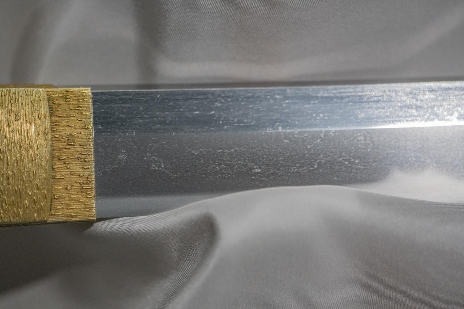

Interesting, I pictured it more like the hada in the pic below
Do you think this is an attempt to reproduce Kotetsu's Ohada? I found this picture from someone who claimed to have found a Kotetsu at a garage sale
My sword mentor has a Kotetsu, & yes, there's o-hada on both sides, although not exactly opposite. In hand, those areas really do look literally "rougher."
Thanks. So it's something he did on purpose, almost like a signature right?

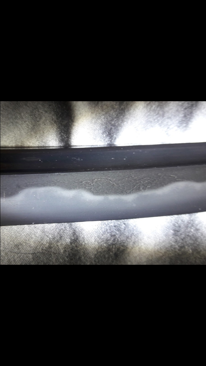

After learning all this, I chose to look at one of my wakizashi that resembles a Kotetsu. The forging is so tight that there are no kitae-ware, or very tiny and few, even in the bohi. Its hard to find any pattern on the ji because it's smooth as glass and always looks wet but the jihada that can be seen points to Kotetsu. The Nakago, 2 different hamon's and Boshi point to kotetsu as well. The only pattern that really stands out from the rest is what looks to be Ohada, roughly 3 inches from the mune machi. Other than some minor scratches and old polish, its in great shape and as sharp as my early Mino/Shizu blade, if not sharper.
Now before I get crucified and the usual members start slanging insults or jumping to conclusions, I'm not saying its a genuine Kotetsu. What I am saying is every Kantei I've done on this always finishes at Kotetsu.
I'm well aware of his fame and the majority of counterfeits. I'm still a rookie in the Nihonto world but I've handled my fair share of blades in person and have examined hundreds online, as well as read constantly. I know quality when I see it and this wakizashi is quality.
So, imho, this wakizashi is either one of his unsigned, from his school and someone close to him or a forgery by a really good smith who was familiar with Kotetsu style.
Please, if you're going to debate, which I welcome, please do it respectfully using Kantei points and not just heresay or bitterness. I say this because many times, even now, I've seen others claim fake or not genuine mei based off pictures while the blade was actually papered to the smith the person said was not.
Anyways, please forgive my ramble and feel free to critique. I'm not trying to say I own a Kotetsu or brag, I only want to talk Nihonto using a blade that's close to me

No, its not a Kotetsu. Don't take my word on it, especially based on a photograph. But it is not a high quality sword. Jigane varies randomly, hamon is in nioi save for some sparkles of nie here and there.
Kirill R.
So one person says they need more pics for a proper kantei but I guess you got it all figured out from this pic alone.
Like I said, not trying to brag, but every time a person comes over and looks at the blades I have listed for sale, they always choose this one (which isnt for sale). Last week I was offered 2000$ for this "not high quality" mumei sword. I guess that must be the going rate for horrible swords then haha
Anyways, Im not opening this can of worms again...Forget I even mentioned it
