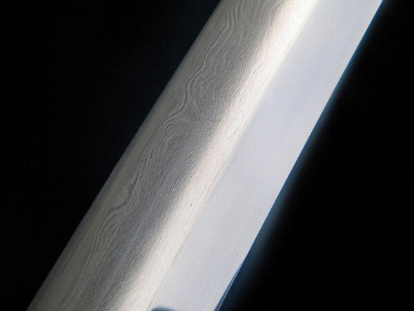

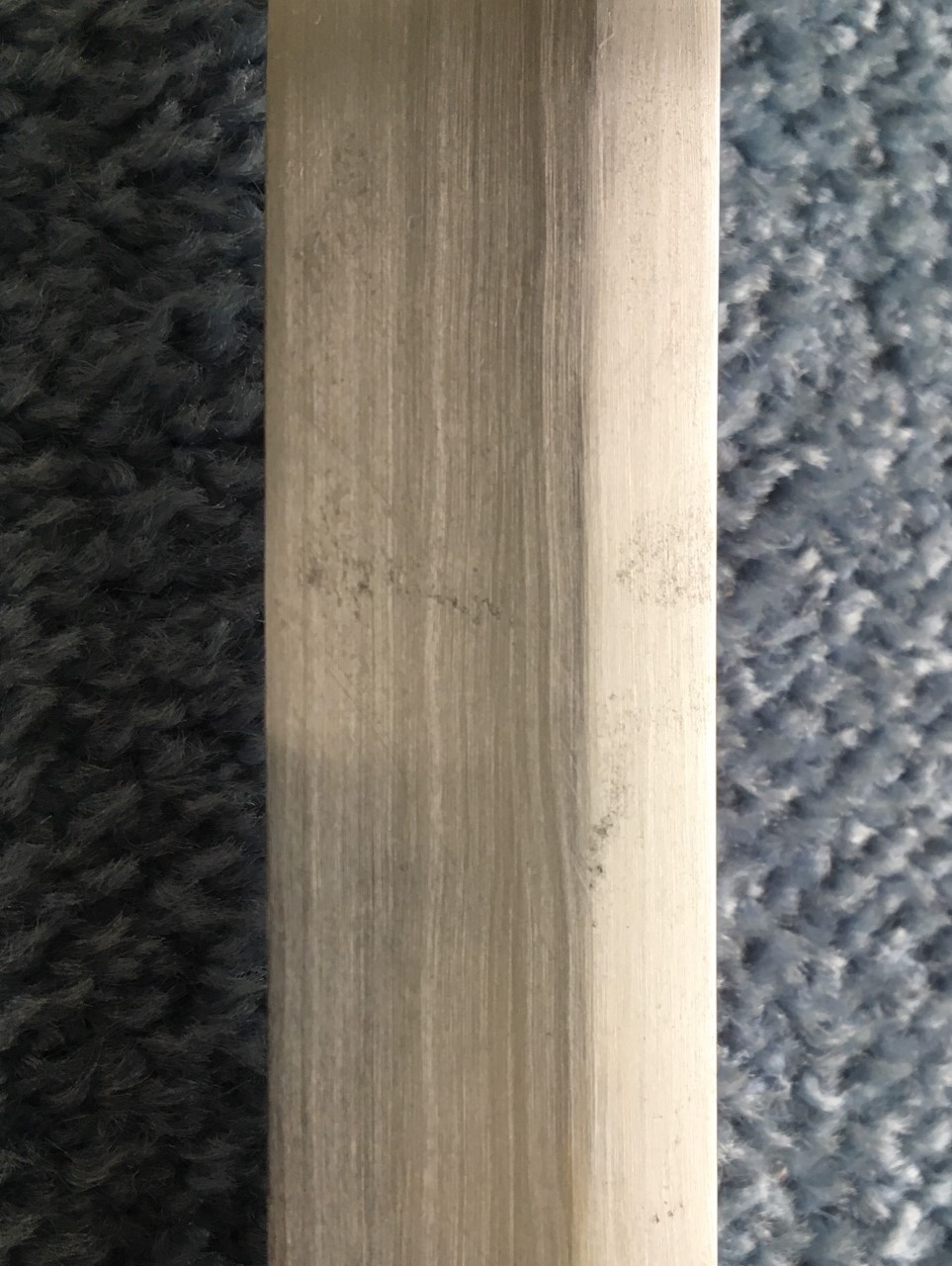

 "Hamfish" has an excellent example of one of these, but I will wait for him to post pic's  and looking at that and others, the most obvious difference is a very clear and coarse grain, possible even to mistake for a modern Chinese damascus.... as has happened on this site.

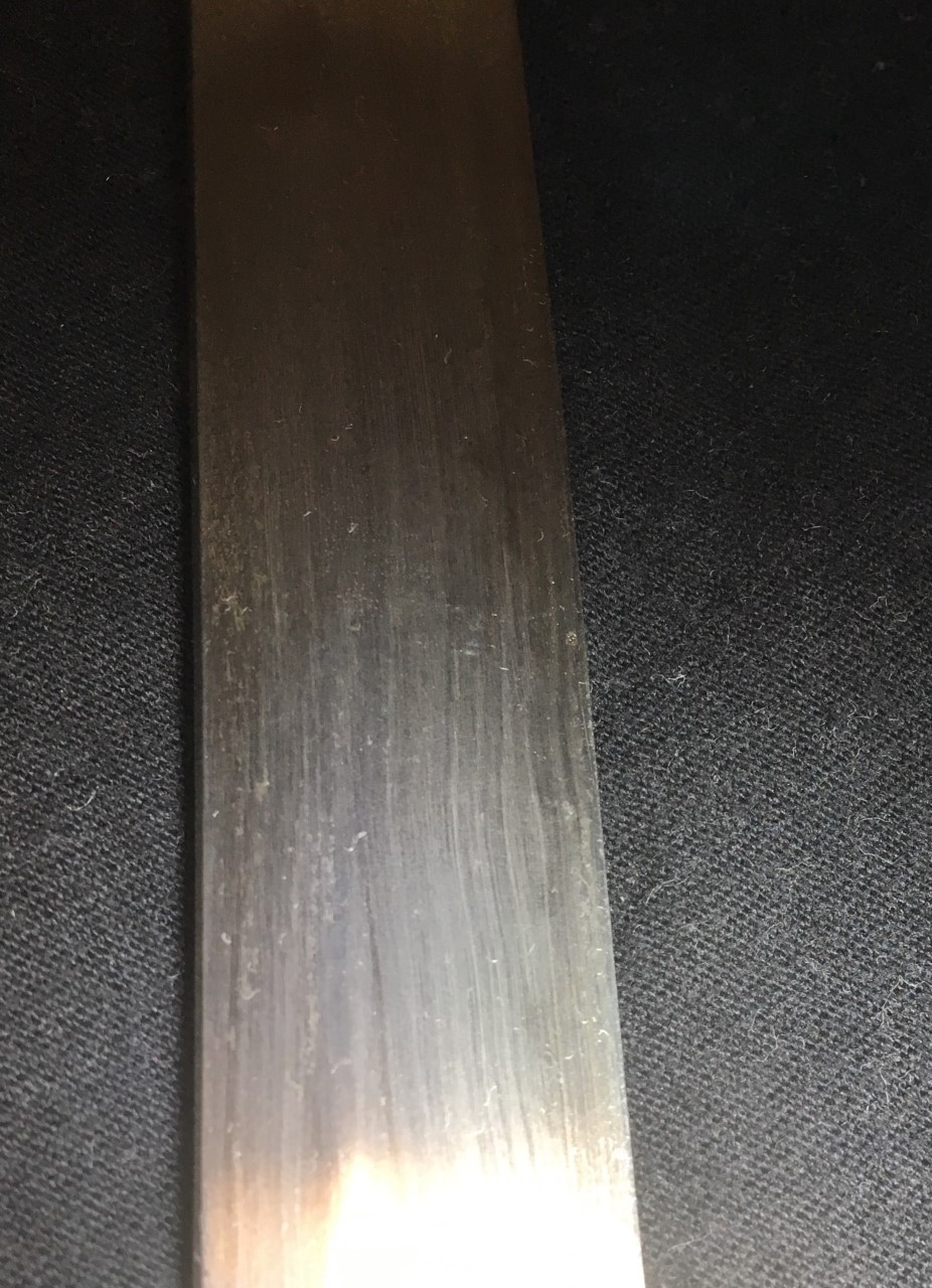

 I think a fair few of Amahida' swords fall under this description as well. This pic' is from an online sellers page.
if I’d been shown this picture, I’d have said it’s a Chinese copy.

So, Chris, what makes this a Hantanren? I have two Showato that look exactly like that. How would you ,are the difference?
 Yep, but if you study them you can see the difference. If you are "in to" Showato, it's worth getting to know them.

Yes, but a Showato with oil remperimg made in Seki isn’t necessarily a Hantanren. Here, they say it is, but how can they know? I see no difference between a Sunobe blade and a Hantanren on this picture.
Yes, in fact one of the distictive problems faced during the war were really well made showato. It's the reason the govt started the stamping system.
The site doesn't say. Maybe the provenance from the family actually said it when talking of the purchase for the family member? Otherwise, who could know?

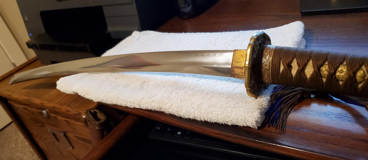

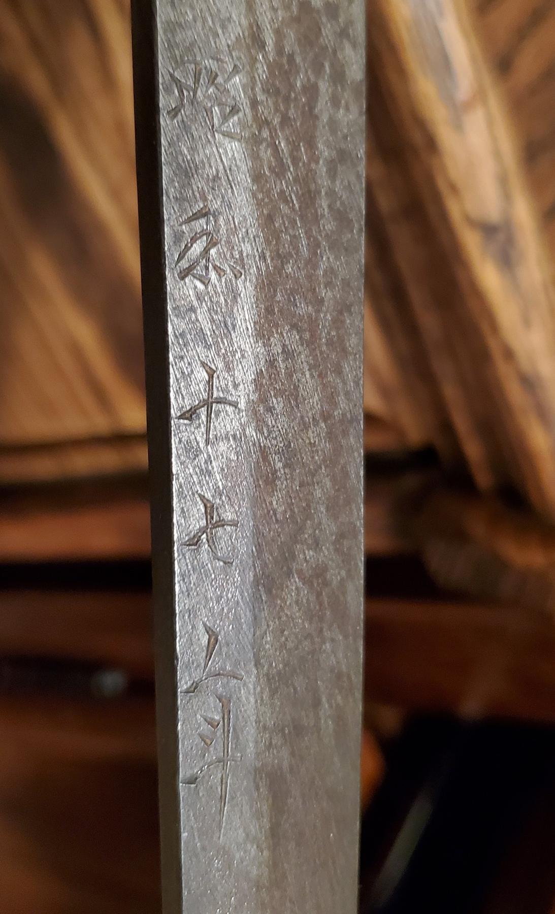

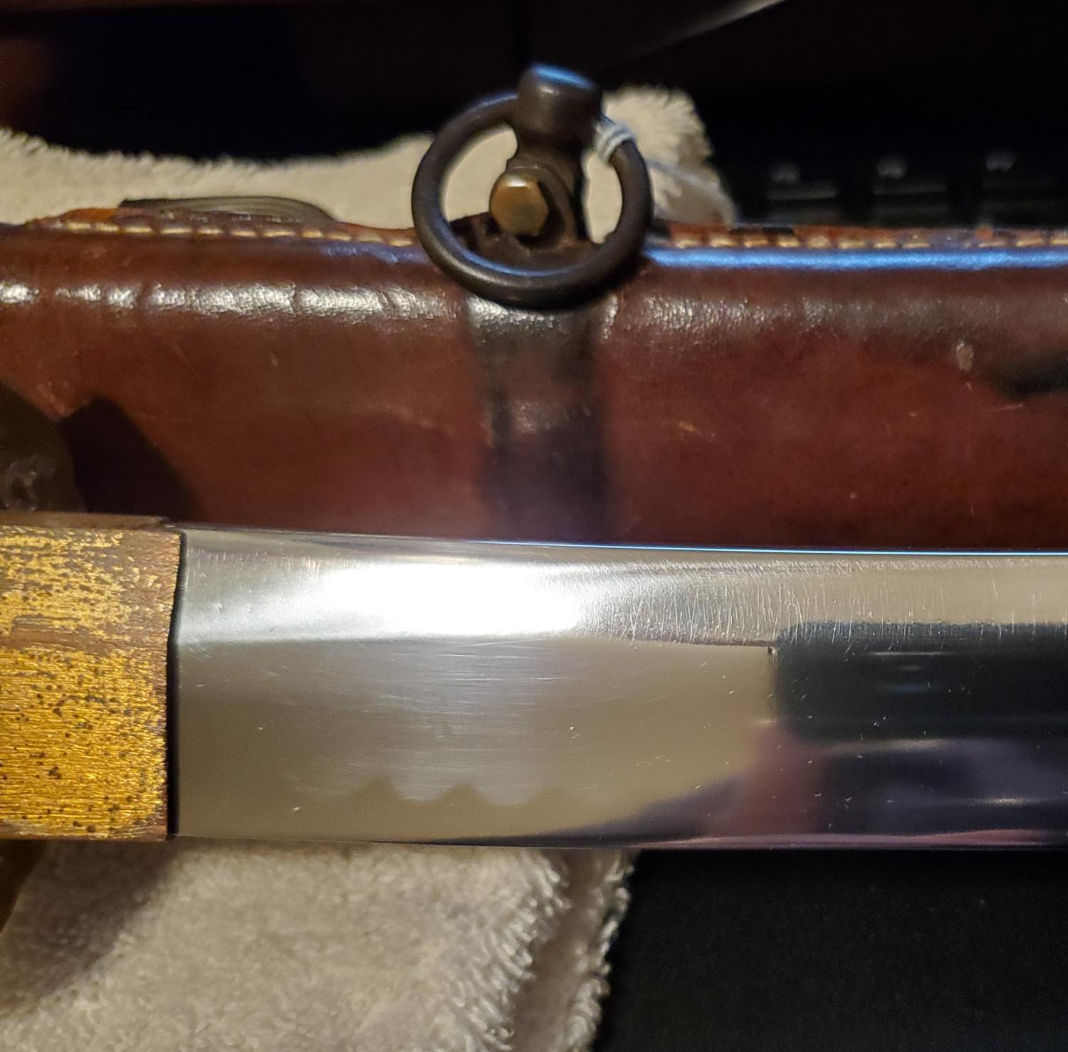

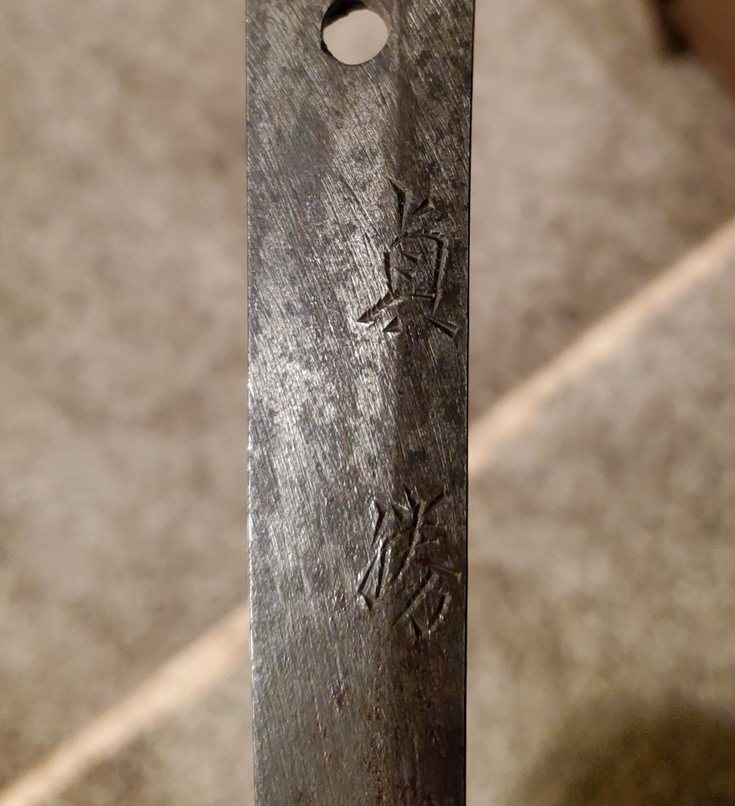

This is a Yamamura Yoshimichi, made March 1942.
The blade looks so much like Damascus steel. I don't like it, but keep it as an example of WW2 manufacturing, mounts are great however.
In the end, you have to look at the entire package, and if you are lucky you might have a decent backstory to validate the blade..... I do wonder though, if han-tanren blades have influenced the Chinese fakers in their blind imitation of "Damascus"?
We need to see more of showato to know the difference, but sadly there ain't many to see :(
The surface lines are the evidence of forging, so han tanren to.

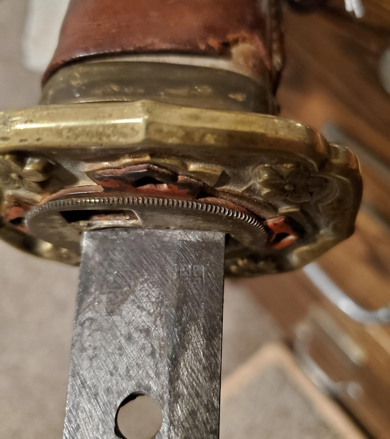

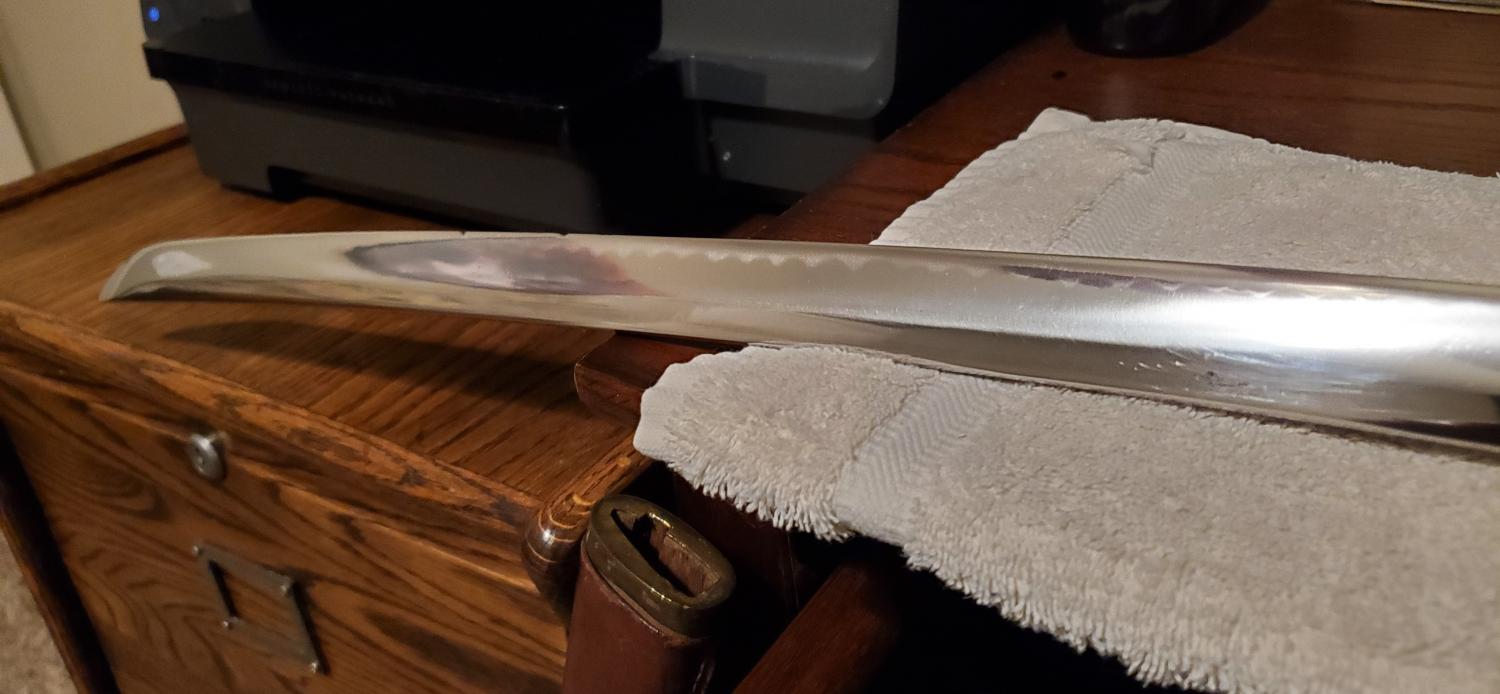

That s indeed not one of the most beautiful sword I’ve seen, but nice to have one in your collection, Neil!
JP, thanks, I actually thought that posting pictures of this sword may have gotten more comment. The koshirae is almost mint, and good quality, so why in 1942 would an officer buy such a poor quality blade? Yes it is very roughly folded and forged, almost no hamon, but the smith took time to sign and date it. I have seen better NCO blades.Was there a blade shortage? Was it due to price?
As you say, I keep it not for its beauty, but part of Japanese sword history.
Neil,
Like collectors have many varied tastes, I'm sure you'll find just as much variation in taste in the WWII IJA officer. Steve's idea could very well explain it - he had enough money to buy good looking koshirae, but not enough for a great blade. So he looks good to all appearances.
A slight variation is that he wanted to look good, but wanted a blade that he didn't mind putting into battle, a weapon, not an art-piece.

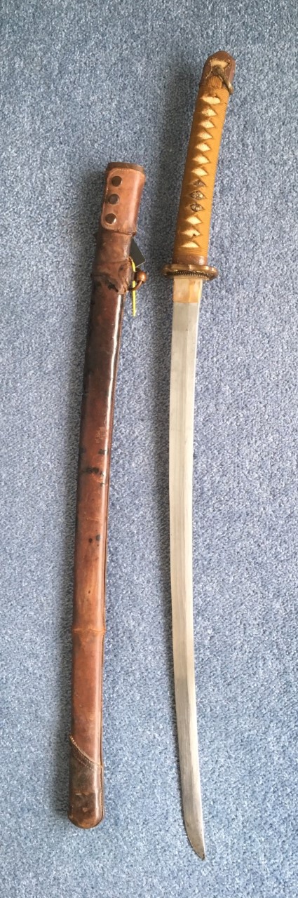

This is a Showa 17 Seki showato. I'm not sure whether it will contribute to the topic or not. I've shown it to many knowledgeable individuals at gun and sword shows over the years. It has more often than not, (even though likely a misnomer), been classified a Han-tan-to gunto. In Dave R's post # 10, the exposition does an excellent job of describing mis-used terms and explanations of such. For example, what exactly would be a half folded blade.. Han-tanren-to???
As explained to me, Han-tan-to would be considered a non-folded blade, oil quenched, with a certain level of swordsmith work applied...Seki showato.
Interesting example Dave! I wonder if the different colorations in the nakago reveal the mixed steels? The blade definitely doesn't look folded, which to my very-inexperienced eyes, would have said sunobe-to. But if guys with experienced eyes at seeing variations in blades/steels see the han-tan, then yours is a good example.
Bruce, I'm normally 99% wrong with all shin gunto opinions and have to lean heavily on others in fear of going a complete 100%.
However, after reading Dave R's exposition in post 10 ( a couple of times) hopefully I/we can have a little better understanding of showato terms.
I'm getting the han-tan-to may be just a variation of sunobe-to.
