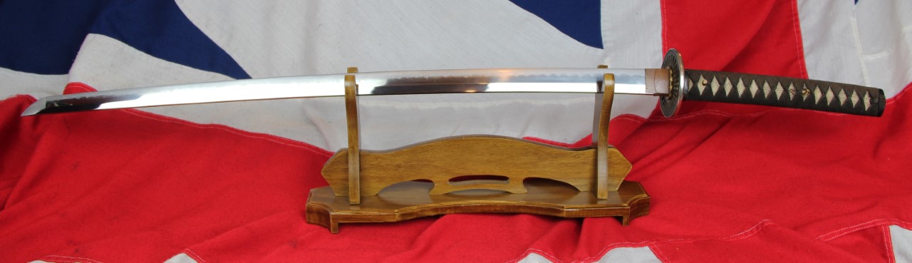

ScottyT Posted January 14, 2020 Report Posted January 14, 2020 I'm thinking of buying the attached Katana however it is unsigned and without papers.....It looks amazing! £5000 though.....What ya think? Thanks click for more images A Spectacular Long Bladed Koto Katana Circa 1490 With Amazing Hamon With a simply glorious finely polished blade showing within it's Edo polish a deep gully wavy gunome hamon of breath-taking beauty. Original Edo wrap over gilt menuki with pure gold decorated fushi collar [sword hilt mount] depicting deeply chissled takebori Soten fighting samurai in armour, carved horn kashira [pommel]. The tsuba has a silvered applied rim and the design is sukashi piercings showing a circle of arrow flights to complement the fittings. It has a most elegant original Edo lacquer saya most deeply ribbed in black, with light age marks. Copper double habaki blade collar. 29 inch blade tsuba to tip. Signs of light wear but overall superb for age. 29 inch blade tsuba to tip Quote

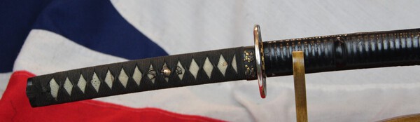

raaay Posted January 14, 2020 Report Posted January 14, 2020 Hi Scotty sorry but this sword has had an acid polish and over priced IMHO. If you are willing to spend good money on a sword I suggest you politely look around some of the Uk reputable dealers or collectors you can do much better . from your statement it is amazing ! at 5K , you need to hit the books and politely do a bit more research /study don't be tempted to jump in and buy on impulse , lots of help around the UK. I am not trying to be to negative here but it feels like you are new to collecting swords, so shop around and be patient , plenty of good deals to be had if you look in the right places. And also sorry to say this, but the Edo polish was done in the UK, look also at the Tsuka the Fuchi is larger than the handle including the Ito,and this internet site is knowing too many for there amazing right up's !!! just my two pence worth, 3 Quote
Brian Posted January 14, 2020 Report Posted January 14, 2020 Wow that is a bad "polish"Everything to avoid in a blade.Just have a look through our own for sale section to see lots far better and cheaper. 1 Quote
paulb Posted January 14, 2020 Report Posted January 14, 2020 Can I suggest you take a look at the for sale section here and links to other dealers listed on the site just to see what is available for the money you are thinking of spending. £5000 for an unpapered blade with an acid polish is a very high price IMHO edit: sorry others beat me too it but I think the consistent message is very clear 2 Quote
Brian Posted January 14, 2020 Report Posted January 14, 2020 For example: http://www.militaria.co.za/nmb/topic/30328-late-kamakura-yamato-taima-blade-tokubetsu-hozon/ Quote
Fuuten Posted January 14, 2020 Report Posted January 14, 2020 Well no papers, no studying yet. I think everyone will suggest buying a couple of books first. Quote

Rivkin Posted January 14, 2020 Report Posted January 14, 2020 Tsuka looks new, but with old fk (not paired), tsuba, saya, not sure about menuki. The blade is in very tight itame with rather bright and very characteristically looking hamon... Probably shinto, say around 1630-1640. Remote second chance - shinshinto. Bizen imitation. It is bright, but 5k pound is just a tad ambitious here. There is some question regarding the polishing quality also, but its not a deal breaker here. I often read about hitting the books, but was never able to see this theory actually working. But after one studies extensively 1,000 or so swords with the help of a few books and hopefully someone who can give advise on how to look at swords, some understanding does tend to settle in. Out of the three components (books, advisor, blades) books are the solid third place. If you are looking for similar blade with a much better investment potential, I would consider signed early Ishido school works (Korekazu, Mitsuhira, etc.etc.), maybe trying to pick up something that has pronounced utsuri - these blades sometimes are very good and very much undervalued today. Aiming at a higher price point, Chounsai Tsunatoshi is also a good choice if you are looking for a bright Bizen Ichimonji imitation. Kirill R. Quote
