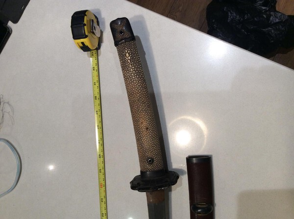

Kmad Posted January 10, 2020 Report Posted January 10, 2020 I am not sure what attached is I was wondering how to remove the handle to see what is underneath or if it is worth looking at This came with a load of antique muskets as part of a job lot out of an old theatre The sword feels right it has a nice balance but it is a lot thinner blade than any Japanese sword I had previously The ray skin handle feels correct and the saya looks and feels correct. The handle seems to be held on with screws with no obvious way of opening them Blade length comes in at just under 25 inches and the hamon is quiet linear with no discernible pattern It is evening here so hard to take better pictures on the tablet Any info appreciated Regards Ken 1 Quote

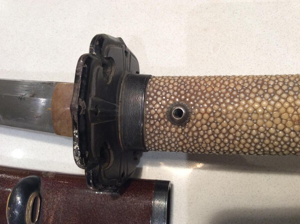

Ganko Posted January 10, 2020 Report Posted January 10, 2020 The handle should be held on with a pin which goes through the silver ferrules just to the rear of the hand guard(tsuba). If you look through the ferrules and you can see light through them, then the pin is not there. If there is a pin in there it must be removed to take the handle off, also the handle may still be stuck very tightly. Removing the handle should be done carefully or you may cause damage to it. You should take it to a person familiar with Japanese swords. It appears to be a koto sword(pre 1600) to me. Quote
Kmad Posted January 10, 2020 Author Report Posted January 10, 2020 Looks like the peg is not there so I guess the handle is just v tight Picture from both sides attached I will take more pictures of the tsuba a in better light tomorrow Regards Ken Quote

Ganko Posted January 11, 2020 Report Posted January 11, 2020 Do not put pliers on it as it looks like a decorative ferrule for the peg. If you can see all the way through it to the other side then the peg is gone. The only thing holding it on should then be the rust on the tang, however I have seen swords that have had the handles glued on by unknowing individuals. Read the link from Grey Doffin above before you do any harm to it. 1 Quote

Geraint Posted January 11, 2020 Report Posted January 11, 2020 Dear Ken. Late to the party but to answer some of your questions...... I don't think your sword was ever wrapped but it would have had menuki, I think I can see a pale shadow on one image just above the reluctant mekugi where one would have been. I would add my vote to the pre 1600 camp though be aware that age alone, while fascinating is not a guarantee of quality. I think we expect this sword to have been shortened which in part may account for the rather straighter blade than you are used to. We always enjoy the possibilities when a sword like this pops out of the woodwork. Chuck's advice about attempting to remove the mekugi is great, there is one more possibility which is that it is in the form of two sleeves that are a friction fit in each other, really worth having someone who knows what they are doing take a look. As to what you paid for it, well I can hear the sound of a lot of people banging their heads on the table and muttering, "75 Euro, 75 Euro, why don't I ever find anything like that!" Enjoy! All the best. 3 Quote

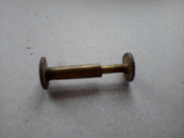

Dave R Posted January 14, 2020 Report Posted January 14, 2020 I think what you have there is the two piece metal mekugi (retaining pin). The older style is two pieces, one of which friction fits inside the other. The later style has the narrower piece screw into the other. 1 Quote

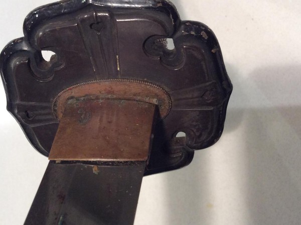

Kmad Posted January 15, 2020 Author Report Posted January 15, 2020 Yes Stephen I can see daylight through the hole Now one thing I did not mention is that the Tsuba is loose and there is space from either missing seppa or the handle has slipped downward but if I can see through the hole this implies (in my mind) the holes in the tsuka is lined up with the hole in the tang so the blade is not held by anything other than friction (or rust) the hole for the menuki are different diameter from one side to the other further implying the wedge shaped menuki would have gone here at one stage Thanks for interest, Ken Quote

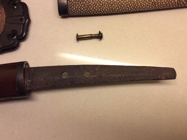

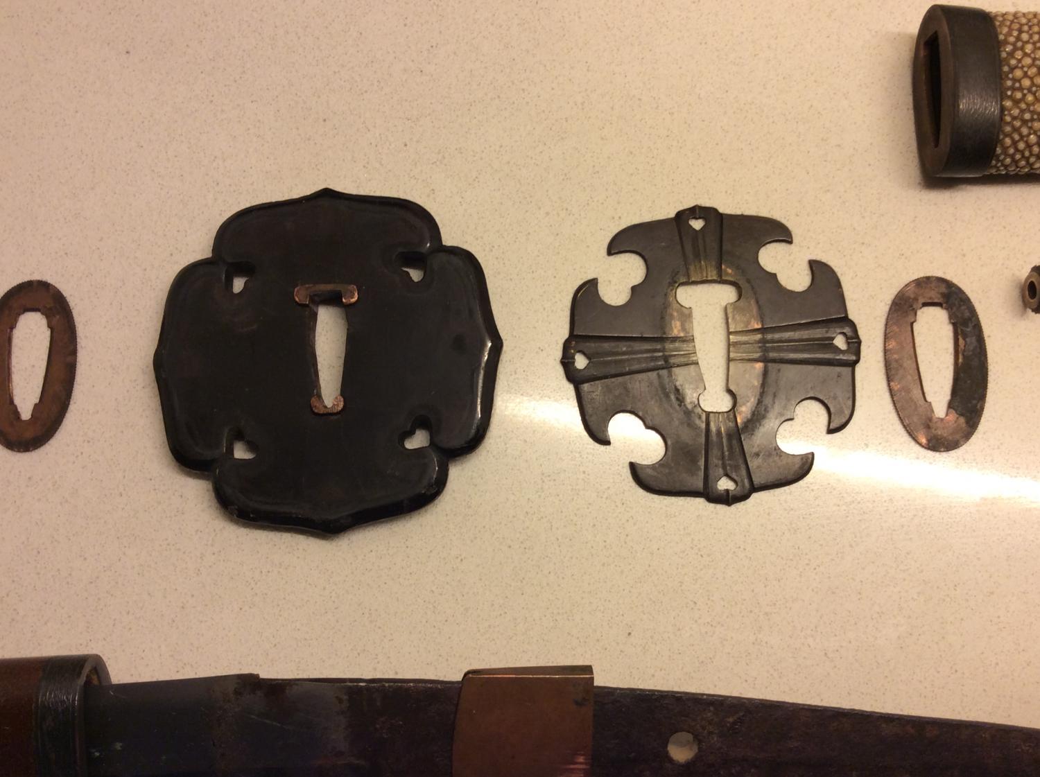

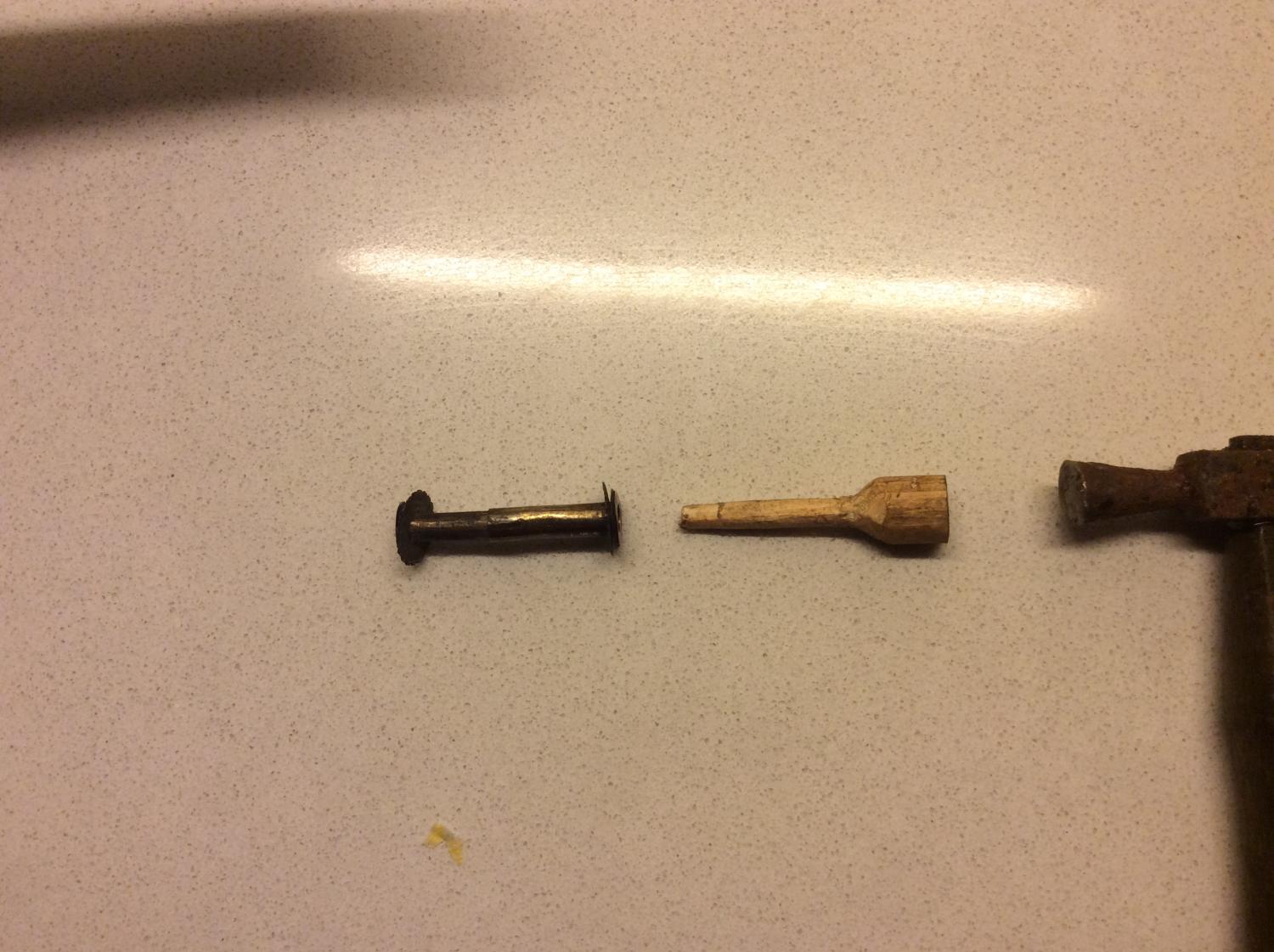

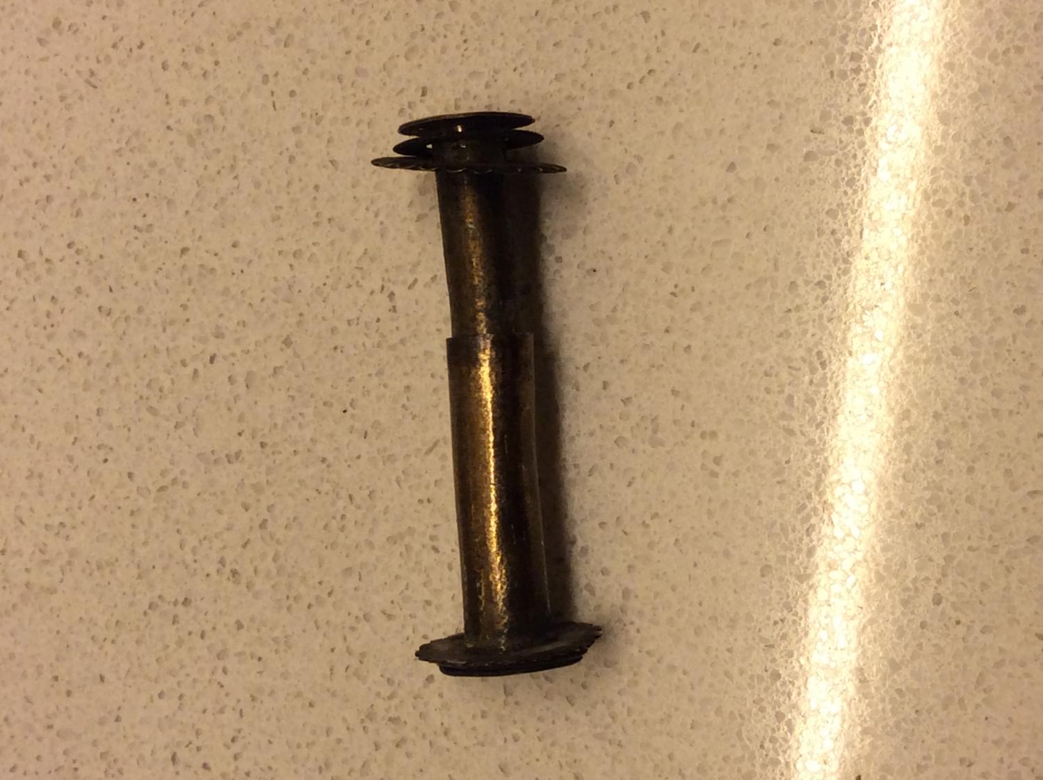

Kmad Posted January 29, 2020 Author Report Posted January 29, 2020 Well I got it apart the peg . It was a friction fit in two parts just pushed together, very tightly I made a dowel that fitted the larger hole and pushed out the smaller diameter inner sleeve came apart reasonably easily I think someone may have tried to removed handle with some force as the copper or brass was a bit dented No markings on the tang but holes from a re mount you guys will be able to discern something from the shape I hope. The tsuba is quiet nice and intricid So can anything be learned from this development Any extra pictures no issue. Thanks all for your interest. Ken 1 Quote
Kmad Posted January 29, 2020 Author Report Posted January 29, 2020 For sake of completion this is the Tool I used 2 Quote
Stephen Posted January 29, 2020 Report Posted January 29, 2020 Nice tool...table wouldn't have worked good call. Quote
Ganko Posted January 30, 2020 Report Posted January 30, 2020 Good work, looks like a koto period nakago. Quote
Rivkin Posted January 30, 2020 Report Posted January 30, 2020 Nice! My personal vote would be on Muromachi. Kirill R. 1 Quote
Tom Darling Posted January 30, 2020 Report Posted January 30, 2020 Everything is original. I agree it's Muromachi period. Tom D. Quote
