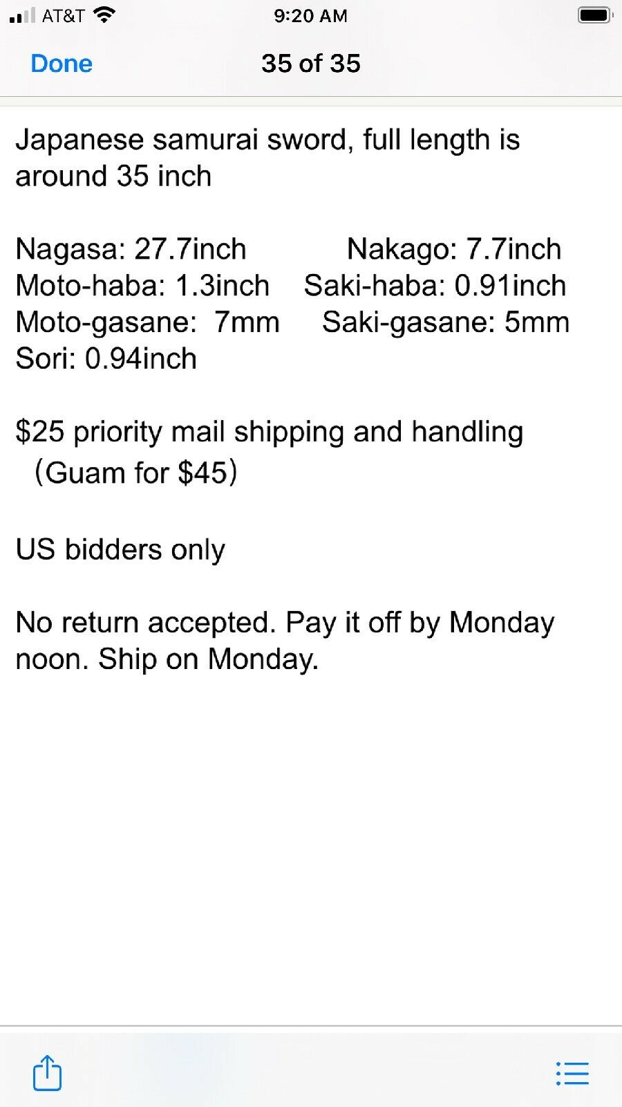

What of the sword in the actual listing? They said they gave me that mei to show  "The signature I sent was to show you what they look like new my were carbon dated and registered by the Japanese museum of swords and historical artifacts."
Which is somewhat humorous as you cannot carbon date metal.. you need a source of constituent carbon.
They claim the sword's been in their family for 250 years.
Here are the supposed measurements: (attached below)
I want an ironclad case to shut them down. In my mind, there's little chance this is legitimate.
