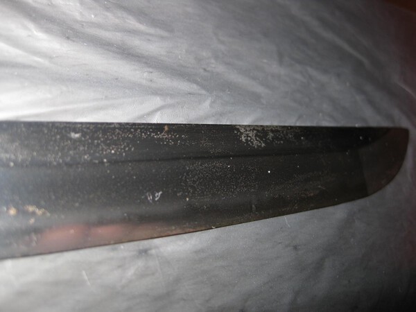

Last samurai Posted December 24, 2019 Report Posted December 24, 2019 Help please I purchased a ww2 Japanese Katana that was said to have been captured from a Japanese captain T.Kuroki and handed to a US corporal J.J.Evans, there is some paper work with the blade but I cant tie them together. My knowledge about this subject is very limited and would appreciate any help.. Quote
SAS Posted December 24, 2019 Report Posted December 24, 2019 Curious as to why a Japanese captain would surrender his sword to a US corporal, then write him a letter providing sword kantei. Quote

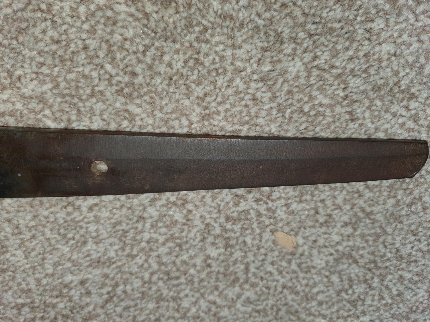

Ray Singer Posted December 24, 2019 Report Posted December 24, 2019 It is difficult in the current condition to give it an attribution. Nobukuni would not be my first call though. While the nakago makes this look at a glance like an ubu shinto blade, you have carefully osuriage nakago for older blades that can look this like as well. 1 Quote

16k Posted December 24, 2019 Report Posted December 24, 2019 Hi Mr last samurai (a name would be nice!) Others will probably tell you more, but I seriously doubt this is a Nobokuni sword, at least not THE Nobokuni. I first thought I saw a Seki Hamon, but in hindsight, this is rather a crab claw Hamon, so it could indeed be Shinto. Quote
ROKUJURO Posted December 24, 2019 Report Posted December 24, 2019 Japan surrendered on Sept 2nd, 1945. Captain KUROKI wrote his appraisal (in amazingly good English!) in 1946, October. So I do not see the act of surrendering.What I can see from the HAMON looks like oil quenched, so possibly a WWII blade. NAKAGO looks older, but not 350 years.LAST SAMURAI (is that indeed you, Tom Cruise?), please sign all posts with your first name plus an initial as we all do. Quote

Last samurai Posted December 25, 2019 Author Report Posted December 25, 2019 Sorry to all my name is Neil, would it help with a pic of the full blade ? regards Neil Quote

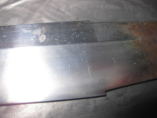

Bazza Posted December 25, 2019 Report Posted December 25, 2019 It would help if you showed us a closeup of the edge just at the notch, say at a 45 degree angle looking down at the edge. I'm looking for a hint of ububa (flattened, unsharpened edge) that would possibly signify a sword of WW2 origin. BaZZa. Quote
Rivkin Posted December 25, 2019 Report Posted December 25, 2019 Overall photo of the blade is needed, but it somewhat feels like (post 1500) Muromachi and possibly Momoyama Bizen for some reason in later suriage condition. P.S. now reading the document, yes it can theoretically be Nobukuni from say Tensho 10 (1581 or about) to 1600 or so, Momoyama period. Momoyama swords can be weird in the sense that you have that short period when you can see Odawara Soshu doing Rai, Bizen Osafune doing hitatsura Soshu, and Mino smith doing Ichimonji copy for some reason. Atypical typical, guess sometimes you had to do what Daimyo wanted to add to his collection. Kirill R. Quote

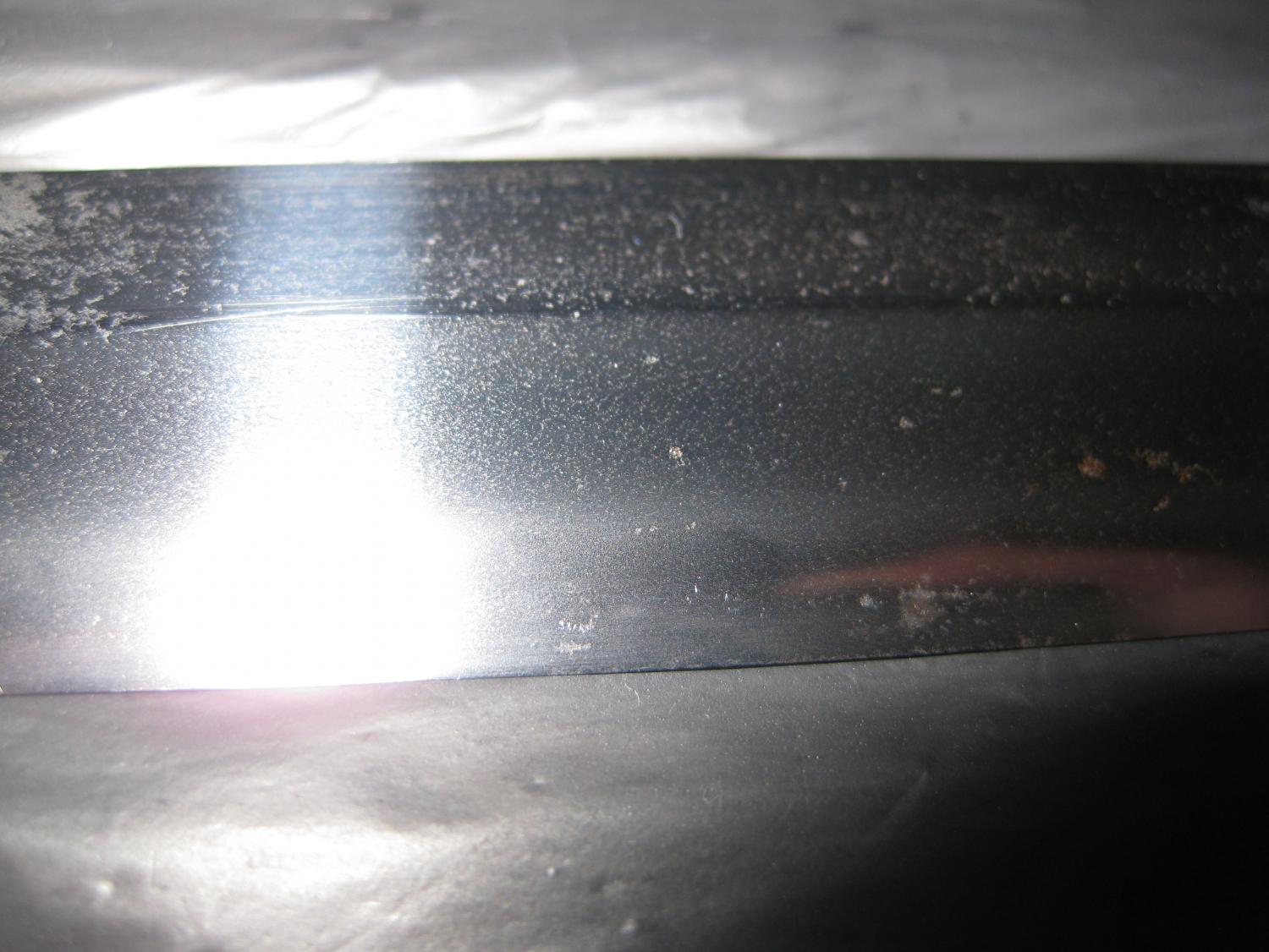

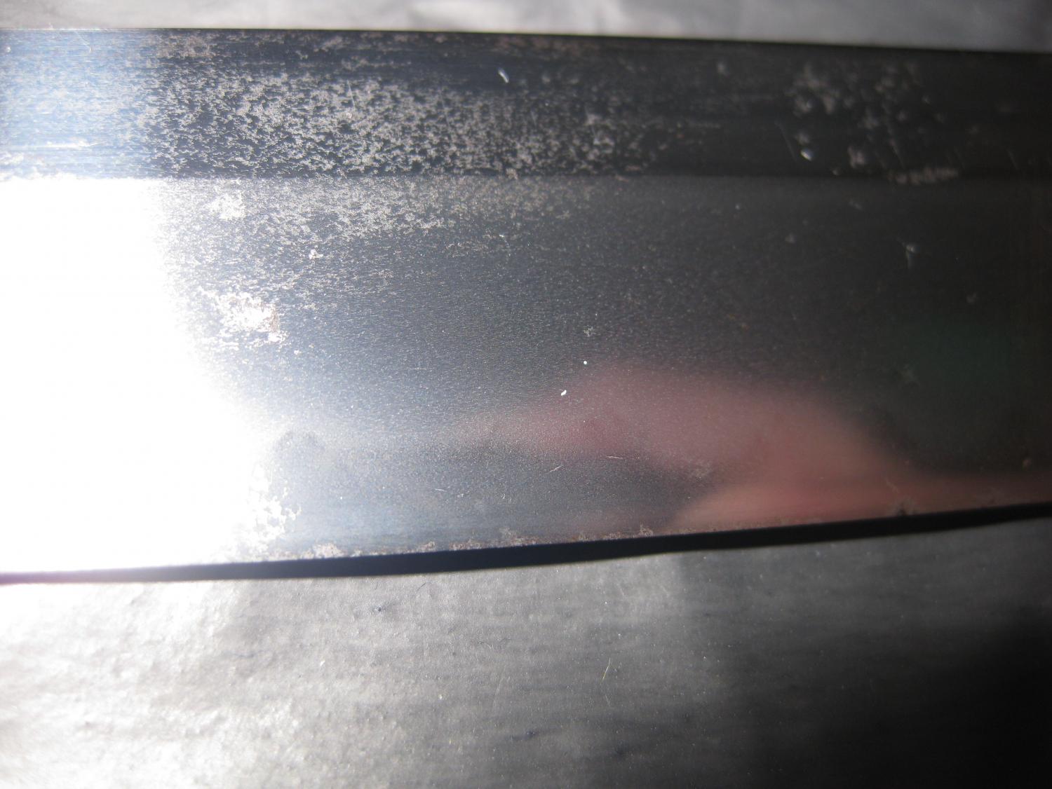

Last samurai Posted December 25, 2019 Author Report Posted December 25, 2019 Here are a few more photos if you need anything more specific just let me know. thanks Quote
Last samurai Posted December 25, 2019 Author Report Posted December 25, 2019 Here's pic of full blade. Quote

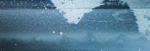

Ray Singer Posted December 25, 2019 Report Posted December 25, 2019 You have a blade in nioi/ko-nie with bo-utsuri and a hamon with areas that resemble kani-no-tsume (crab claw choji). I would be looking at something along the lines of an o-suriage mumei Bizen blade. 1 Quote
Last samurai Posted December 25, 2019 Author Report Posted December 25, 2019 Have you any idea who was the smith was and how old this blade is please.. Quote
SAS Posted December 25, 2019 Report Posted December 25, 2019 I would go with Ray's analysis, age is a bit tricky, mid to later Koto maybe. Quote
Last samurai Posted December 25, 2019 Author Report Posted December 25, 2019 As I mentioned I have very limited knowledge on the subject, am I correct in saying the blade has small straight crab claw hamon on a short or shortened unsigned blade from the Bizen school/province ? But no smith or age, I still don't think the paper work has any relevance to the blade. Quote
Jacques Posted December 25, 2019 Report Posted December 25, 2019 On 12/25/2019 at 12:21 PM, raymondsinger said: You have a blade in nioi/ko-nie with bo-utsuri and a hamon with areas that resemble kani-no-tsume (crab claw choji). I would be looking at something along the lines of an o-suriage mumei Bizen blade. Frankly, i wonder how you can see all this things... In fact i see nothing which can be descripted. Quote
Last samurai Posted December 25, 2019 Author Report Posted December 25, 2019 I used Google to try and translate as best i could Quote
16k Posted December 25, 2019 Report Posted December 25, 2019 On 12/25/2019 at 7:25 PM, Jacques D. said: Frankly, i wonder how you can see all this things... In fact i see nothing which can be descripted. The crab claw Hamon is pretty obvious, but I gotta admit I’d missed the utsuri and wouldn’t have noticed it if Ray hadn’t pointed it out. Neil, yes, you’ve understood Ray’s description very well. As for age, it’s difficult to determine without a mei and because the blade was shortened, so it’s lost it’s original shape. Some people can give you an estimate, but they need to be better than I am to imagine the original shape. Taking it to a Shinsa would be the right think to do. Quote
Geraint Posted December 25, 2019 Report Posted December 25, 2019 Dear Neil. You are well within reach of a number of members in the North of England, just waiting for one of them to chime in. An in hand conversation is what you need. All the paperwork should stay with the sword, I see no reason to doubt it's association with the history of the blade though the attribution will always remain problematic. Ray's assessment is to be trusted at this stage so go slow and find out more. All the best. 1 Quote
Last samurai Posted December 25, 2019 Author Report Posted December 25, 2019 I have no problem Rays assessment he's obviously on the ball, its just putting it in layman's terms for us novices to understand. My next question was that i have no intention of selling so would it be feasible to have blade polished and restored to how it was 1 Quote

Greg F Posted December 26, 2019 Report Posted December 26, 2019 If you have no intention of selling then I say yes if you want to fully enjoy what you have and are happy to spend money on polish and imo shirasaya. This is something only you can decide. Greg Quote
Ian B3HR2UH Posted December 27, 2019 Report Posted December 27, 2019 Neil , I am fairly sure that Evans was an English rather than a US corporal . The Brits were in Malaya not the Americans . Maj General Churcher was an English officer . The letters RASC after Evans's name indicate that he was in the Royal Army Service Corps The scratched Japanese characters on the brass fittings read Tatsuyama which is probably the surname of the swords actual owner . Soldiers who had a sword sometimes wanted to know what they had and approached English speaking Japanese for advice . Not wishing to admit ignorance about swords the Japanese told them a story . I have seen a few of these attributions and it is clear that at least some of the people giving the attribution didn't know much . I suspect that that is the case here . Still you are fortunate to have all of this paperwork For what it is worth I think that the blade is much younger than 350 years old. Ian Brooks 1 Quote
