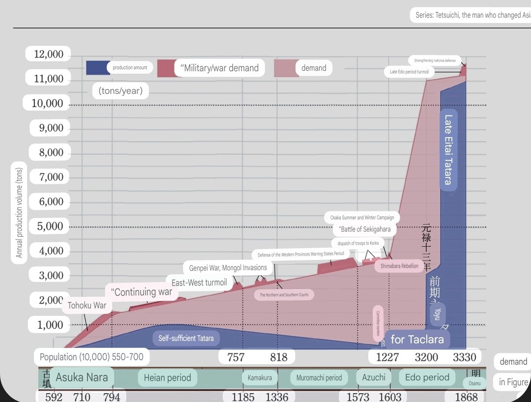

Emil Posted September 10, 2024 Report Posted September 10, 2024 On 12/26/2019 at 9:14 AM, Ken-Hawaii said: Yes, a great writeup, Jean. Thanks! My original question was raised from reading one of Turnbull's books: "As the fourteenth century gave way to the fifteenth the number of known active swordsmiths jumps to around 3,550, until with the widespread conditions of war in the Sengoku Period (conventionally dated 1467–1603), many swords were being mass-produced, with a consequent loss in artistic quality and an inevitable reduction in strength and durability. Records exist of swords being shipped in their thousands to China, with disputes arising over quality and price." Wit that many active tosho, tamahagane creation must have been massive, yet I've read very little about how that happened. This can be read in English with the help of chatgtp. I've corresponded some with Mr Ohmura from http://ohmura-study.net/003.html on this topic. Interestingly enough, tamahagane is according to him and the research he quotes an exception rather than the rule in Japanese sword making. Japan has never had enough domestic supply of sword steel to make all the katans needed. Most of time, especially during the production of Koto the steel actually came from China or Korea. I know this is quite a contradiction to the popular belief, so I recommend that you read the article. / Emil 1 Quote
