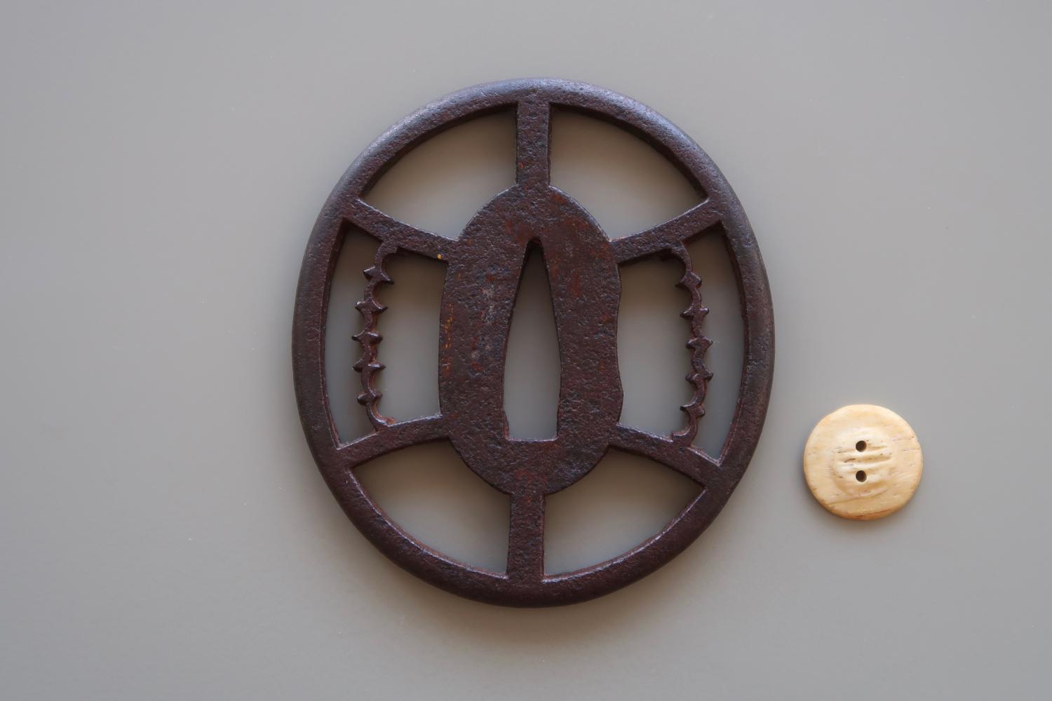

PietroParis Posted December 23, 2019 Report Posted December 23, 2019 Hi All, I thought I would buy a cheap rusty tsuba to practice "rust-removal surgery" and I ended up with this one: The picture is from the seller, more pictures – with more visible rust – can be found on eBay. Do you think this tsuba has any age or merit (apart from the one of being dirt cheap)? Can it be associated to a school? Many thanks in advance for any insight, Pietro Quote

ROKUJURO Posted December 23, 2019 Report Posted December 23, 2019 ......rubbing them with a piece of bone or ivory.... Sounds perfectly acceptable as long as you do not try to give it a metallical clean surface. That is the way to a nice patina. Concernig school or age, I think it is a late (19th century) revival piece. Look at the sharp edges, they do not show age or use. 1 Quote
PietroParis Posted December 23, 2019 Author Report Posted December 23, 2019 How similar is the rust on your newly acquired vs older nice one? Pictures of the older one can be found here. The rust is concentrated in spots, but appears to be somewhat more "raised" than in the new one. Anyway I'll get a better idea of the (dis)similarities when I receive the new one. Does anybody have any guess on age and provenance of the tsuba? Cheers, Pietro Quote
PietroParis Posted December 23, 2019 Author Report Posted December 23, 2019 Concernig school or age, I think it is a late (19th century) revival piece. Look at the sharp edges, they do not show age or use. Thanks for your assessment! I guess that for 28$ (including shipping) I should not expect too much... Any idea of what style they were trying to imitate? Cheers, Pietro Quote

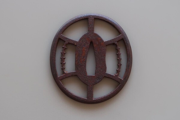

PietroParis Posted January 11, 2020 Author Report Posted January 11, 2020 For the record, these are my pictures of the rusty tsuba, after some days of light wiping with a soft cotton cloth (which did not have any noticeable effect): The front looks already acceptable to me, but there is some very red rust on the back. I have found some old ivory-looking buttons that passed the "hot needle" test, as soon as I get my hands on proper choji (or camelia?) oil I will get to work... Cheers, Pietro Quote

brannow Posted January 16, 2020 Report Posted January 16, 2020 I would use a sharpened deer antler. Quote
Ken-Hawaii Posted January 16, 2020 Report Posted January 16, 2020 Red rust is active rust, Pietro. Antler, ivory (broken piano key), or in worst case, a copper penny can be used for cleaning. Quote
SAS Posted January 16, 2020 Report Posted January 16, 2020 I have been using automatic transmission oil on tools and some other things due to its relatively low viscosity and rust inhibiting properties. Quote
PietroParis Posted January 16, 2020 Author Report Posted January 16, 2020 Thank you all for your comments. My bone button (combined with wd40) doesn’t seem to be effective in scratching away the rust, maybe I should try to break it to get a sharper edge. Quote
b.hennick Posted January 16, 2020 Report Posted January 16, 2020 Do not use a new copper penny as it is not pure copper. Arnold Frenzel decades ago gave me an old English penny that is large and pure copper. They are not expensive, easy to hold and work well. Quote
SAS Posted January 16, 2020 Report Posted January 16, 2020 US pennies 1982 and before are pure copper. Quote

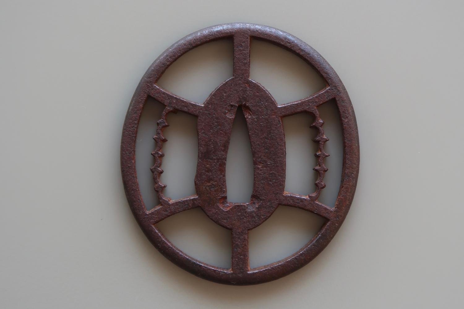

PietroParis Posted February 13, 2020 Author Report Posted February 13, 2020 I gave it another try, with repeated cycles of dabbing with camellia oil, letting rest for a few hours, scratching with a bone button and wiping with a cloth. However, I am not too pleased with the result: The "before" and "after" pictures show that quite a lot of red rust came off, but the patina appears to be damaged in one area (see the whitish spots on the left of the nakago ana). Did I scratch too hard? A more-charitable interpretation could be that the red rust had already eaten through the patina: indeed, the whitish spots showed up quite early in the process, and other areas that I scratched just as hard were not damaged. Anyway, it's just as well that I tried this procedure on a low-quality tsuba that I had bought for 26 EUR on eBay. I don't think I'll dare to try it on my "good" tsuba, I guess I'll stick to oiling and wiping... BTW, is there anything I can do now to reduce the damage to the patina, apart from waiting a few decades? Cheers, Pietro Quote
Stephen Posted February 13, 2020 Report Posted February 13, 2020 To my blind eye it looks like some type of lacquer. Lightly rub with acetone Or high grade alcohol. Quote
ROKUJURO Posted February 13, 2020 Report Posted February 13, 2020 To me it looks as if some bone material has been rubbed into the rust. It will certainly disappear if you brush your TSUBA with a (hard) tooth brush.In do not think that a bone button will ever work. In my experience it has to be something pointed, be that made from bamboo, antler, bone, ivory, or pure copper. 1 Quote
Martin Posted February 13, 2020 Report Posted February 13, 2020 Jean is correct. You will need some sharp edges. Maybe you could break the button into 2 pieces and use the edges. Quote
PietroParis Posted February 13, 2020 Author Report Posted February 13, 2020 Thank you all for your comments! I'll try breaking the button, although I would say that even the rounded edge has already removed quite a lot of rust. As for brushing the whitish area, unfortunately it has no effect. I suspect that the patina is really affected, and I am wondering if I've done something wrong or if it was an inevitable outcome. Cheers, Pietro Quote
ROKUJURO Posted February 13, 2020 Report Posted February 13, 2020 In the end, patina is not going to build up in a week or a month.....I don't think you could have done something wrong. A whitish substance has nothing to do with iron or its oxides. Quote
Brian Posted February 14, 2020 Report Posted February 14, 2020 I have seen in the past where patina loss was covered by chemicals or polish or other added surface treatments, and when you clean the tsuba, those temporary treatments are removed and the patina loss shows through. Lots of dealers out there with "tricks" to make tsuba look better for sale. I suspect that's what happened here. Quote
PietroParis Posted February 14, 2020 Author Report Posted February 14, 2020 In that case it was a waste of the seller's time, as the tsuba sold for a mere 17$ on eBay (the price I had mentioned a few posts above included shipping). Scratching with the broken edge of the button helped remove a bit more red rust, but not all of it. Anyway, I'll give it a rest now. It was a valuable experience to me, and I thank you all for comments and guidance. Cheers, Pietro Quote
