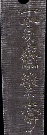

Jacob1968 Posted December 19, 2019 Report Posted December 19, 2019 Hi everyone . This is my first post. I wanted to share my happiness. This is yesterday's find at a flea market. I would like to ask for feedback to help you determine the date, read the inscription accurately. My Japanese friend encrypted the blacksmith as: Ikkansai Shigetoshi (1838-1906) Can anyone help? Quote
Ed Posted December 19, 2019 Report Posted December 19, 2019 Your friend has translated it correctly. Can't speculate on the legitimacy of the mei. The horimono look a bit lower quality than I would expect. What else are looking to find out? 1 Quote

Jacob1968 Posted December 19, 2019 Author Report Posted December 19, 2019 Is there no date in the inscription? Quote

cisco-san Posted December 19, 2019 Report Posted December 19, 2019 Hi Jacob, first of all welcome on board here !!! Here you can find some Information concerning Japanese Sword care and etiquette http://nbthk-ab.org/cleaning-maintenance.html and finally from Markus Seskos book information about Ikkansai Shigetoshi: SHIGETOSHI (繁寿), Keiō (慶応, 1865-1868), Suruga – “Ikkansai Shigetoshi” (一貫斎繁寿), “Sunpu ni oite Miyaguchi Ikkansai Shigetoshi” (於駿府宮口一貫斎繁寿), “Sunpu-jū Ikkansai Shigetoshi” (駿府住一貫斎繁寿), real name Miyaguchi Hachirō (宮口八郎), he was born in the ninth year of Tenpō (天保, 1838) in Shizuoka in Suruga province but moved later to Inaba where he was first a student and later the adopted son of Hamabe Toshinori (浜部寿格), but he later returned to Shizuoka and to his family name Miyaguchi, in Inaba he signed with Hisatoshi (寿俊), later he started to use the gō Ikkansai (一貫斎) and also signed with Shigehiro (繁広), he also worked in Odawara (小田原) in Sagami province, tradition says that he learned the art of horimono engraving from the lineage of Ozaki Suketaka (尾崎助隆), he died January 25th 1906 at the age of 69, dense itame, chōji-midare in nioi-deki or gunome-midare in ko-nie-deki, chūjō-saku 1 Quote

Curran Posted December 19, 2019 Report Posted December 19, 2019 Flip the blade over. Please show the other side of the tang. This line of smiths often dated the blade, but they usually did so on the side opposite where they signed. Quote
Stephen Posted December 19, 2019 Report Posted December 19, 2019 So no date. IMHO I would have it Polished by professional. 1 Quote

Peter Bleed Posted December 19, 2019 Report Posted December 19, 2019 Jacob, Thanks for sharing information and images about this blade. I have followed the discussion but avoided saying anything - - recalling Mother's advice "If you can't say anything nice, don't say anything at all..." But, hey. That's no fun! IMHO, this little sword has all the earmarks of a "three dollar bill." Celebrating those qualities actually reveals something about the nature and history of Japanese swords. The apparent quality of the horimono (the carving on the blade) just isn't there - in my opinion. The dragon is poorly cut, over polished, and strangely placed on the blade. This is not the sort of work that made smith and this line famous. It may be like judging a book by it cover, but I also would be surprised to find a blade by Shigetoshi et al in this kind of shirasaya with a wooden habaki. Finally, it surfaced in a Belgian flea market. Yes, yes, I know "anything can be anywhere" but that situation seems consistent - to me - with this being what has been called a "Yokohama docks" sword - that is, a piece made on the cheap and marketed to a naive audience. So that's what I think. What I find interesting to savor in this situation is the fact that Japanese swords have ALWAYS seemed to have had craftsmen and dealers who were willing to engage in fakery and misrepresentation. Its a jungle out there! Peter Quote

Brian Posted December 19, 2019 Report Posted December 19, 2019 Not just forgery, but anything where there may be something suspect.The horimono isn't brilliant work. You need to see great horimono to judge them. The average guy doesn't see what is lacking.That said, this horimono reminds me of the ones done during WW2 and just after, on soldiers tanto and other swords. I have seen a few dragon done this way.Combine this with an unusual shape, which is a little awkward...I think we have one of the WW2 tanto made as a homage to great makers or maybe as a pure gimei.Then again, just my opinion and I am no expert on this.It is a genuine Japanese tanto, and looks traditionally made, so still a nice item no matter what it is. 3 Quote

Jacob1968 Posted December 19, 2019 Author Report Posted December 19, 2019 Here is a mei for comparison. The biggest problem is the image quality from the web Quote
ROKUJURO Posted December 19, 2019 Report Posted December 19, 2019 Images are o.k., MEI are very different. Quote
Jacob1968 Posted December 19, 2019 Author Report Posted December 19, 2019 Images are o.k., MEI are very different. Any conclusions? Quote
16k Posted December 19, 2019 Report Posted December 19, 2019 I agree that the mei is completely different. I think there are too many different strokes for it to be genuine. Even the yasurime don’t match. I’m afraid you have a Gimei Blade, though I’m reluctant to judge the quality as tanto are not my forte. Quote
Jacob1968 Posted December 19, 2019 Author Report Posted December 19, 2019 I agree that the mei is completely different. I think there are too many different strokes for it to be genuine. Even the yasurime don’t match. I’m afraid you have a Gimei Blade, though I’m reluctant to judge the quality as tanto are not my forte. somewhere on the internet: Gimei determination (and shinsa in general) is a very imprecise thing. Even if you get a top expert in Japan to give their opinion, it is still an opinion. They don't have any magic abilities. I think only the most advanced collectors can even attempt to make a gimei decision. Of course, if important features are "way off", then it might be easy to say gimei. A less-advanced collector will attempt to simply compare the "handwriting" of the mei to examples in the famous books. But I wouldn't be very confident in the results. One gimei parameter that is not mentioned much is that the chances of gimei are much higher with certain names. Two that come to mind are Bizen Yasumitsu and Sukesada. I was told by a collector/dealer in Japan that Bizen Yasumitsu has about a 70% chance of being false. If the name is obscure, it is quite unlikely to be gimei (in my opinion). The general belief is that blades were falsely signed for monetary reasons, to sell to unwary customers. Swordsmithing has always been a business, so there is incentive to make blades that sell for higher prices. Pete Quote

Jacob1968 Posted December 19, 2019 Author Report Posted December 19, 2019 somewhere on the internet but so beautiful and true: Thanks for the additional information Pete. The issue with the mei is not so much the style but the wording. When I was in contact with Markus Sesko about it he seemed to feel it may be an early signature before the smith was given his honorary title. There don’t seem to be any other examples of this exact signature though. For all the research I’ve done looking for other examples of his work to compare my blade to, I’m not confident about my ability judge what I’m seeing. I don’t want to get too caught up in wanting it to be genuine. My feeling is that it is based on other examples in pictures, but maybe I’m seeing the things that back that up not the things that undermine it. I understand what you’re saying about not getting hung up on signatures. I suppose my reason for trying to assess if the mei is genuine or not is mostly that as a novice I don’t really know if it’s a good blade or not, and if the mei is real I would think it should be good, and study it as such. I’m not in a position to look at any blades other than my own, except in books and online. Maybe one day I will get a chance to have someone look at it who could tell me more. This blade is the one that got me looking at nihonto in depth and sparked a real interest for me, so even if it is gimei, it’s given me a lot. Thanks again. Quote
SAS Posted December 19, 2019 Report Posted December 19, 2019 It has a nice shape, if you can afford it, you should have it polished to show its true qualities. I do not know how well the shinsa panels are able to judge out of polish blades, probably they don't spend a lot of time on what they can't see. 3 Quote
