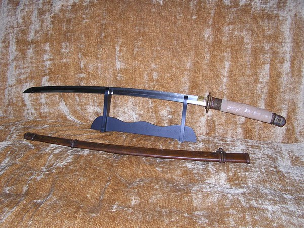

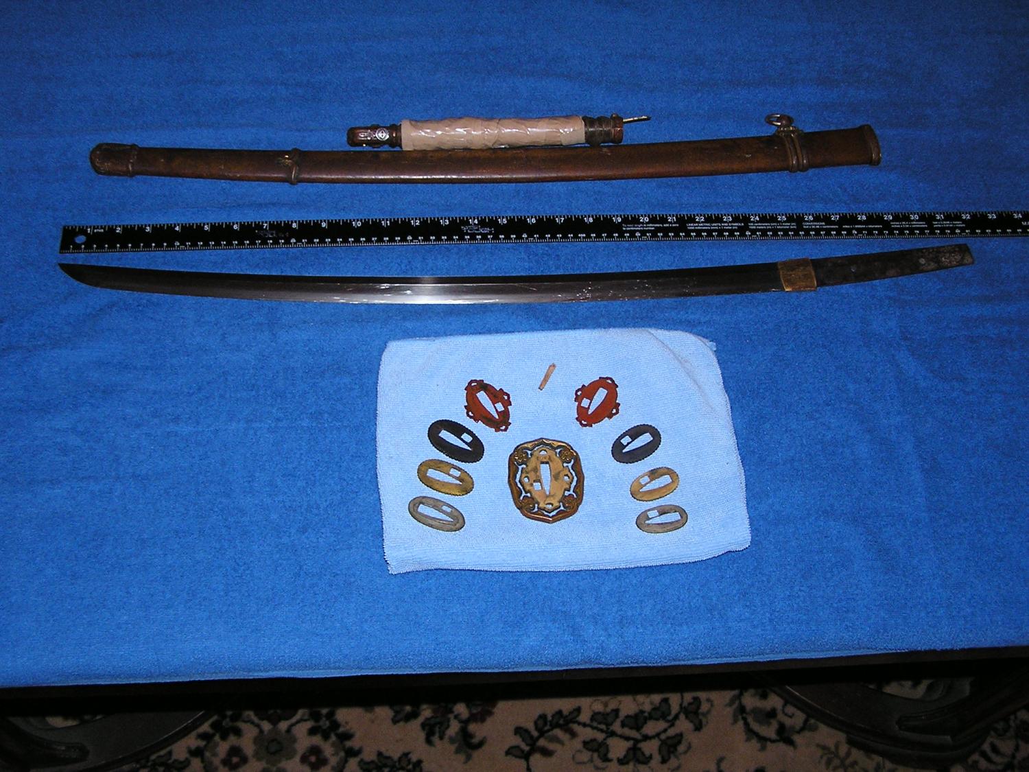

This one is a Viper.   No Apologies, No Remorse.  In person, it's downright scary.
Said to be a battlefield pickup, there's plenty of damage here. But the tip and edge are sound. And very sharp.  The ito is partly gone, along with a menuki.  Malcolm says this mon is "quite rare."  Pierced tsuba, matching numbers, #95.
It has been shortened more than once, and has been heavily polished over time, making it light and very fast. I shudder to think what this one has been through. There are a bunch of scratches and habaki damage that suggest heavy use. But to call this Nihonto "tired" doesn't do it justice. It could still ruin your day.

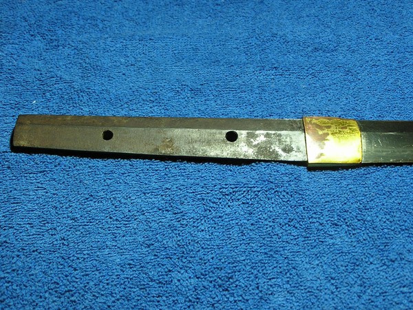

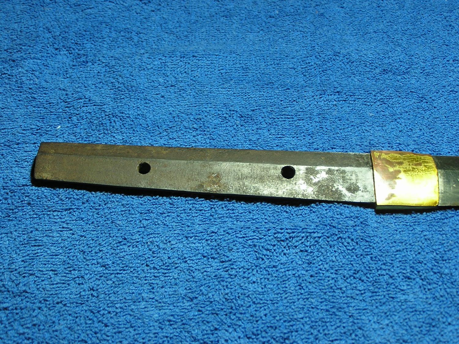

There are no stamps or any signs of a mei. But I bet y'all can read this like a book. Any and all comments are appreciated. Nakago pics will follow.
I’d say late Shinto blade, probably post kanbun. Tired I’m at least two places, I like the suguha Hamon.
They need a better word for that.
Thanks for weighing in, JP.   Was hoping you would address those ana. Can we tell if they are punched or chiseled?  One kinda looks drilled.

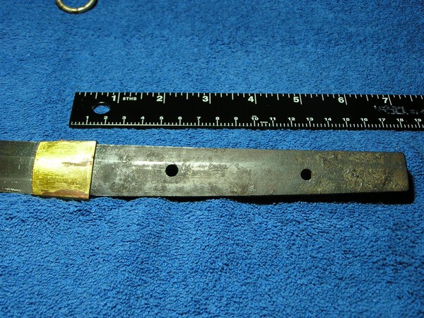

They are drilled. That and the sugata make me think late Shinto. On the other hand, I’m not to sure about the sugata since the blade is laid down, I’m not to sure about the tapering. In some picture I’d swear late Shinto, in others, well older.
The nakago looks really thick! Or is it just camera angles?
The second mekugi ana is quite common for older blades pressed into service for the war. The one closer to the habaki is usually the one fitting the military tsukas.

It's thicker than the rest of the sword; but not unusual. The habaki would not go all the way off. Must be the camera angle.

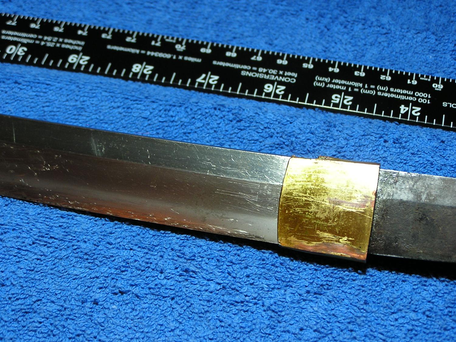

I tried hard to get the hamon to show. Have been trying to find something comparable for a long time. It doesn't look like suguha to me; but I have trouble in that department, as you might know. Hoping someone will recognize the truth with what is here.  No way to take a picture of its presence. But you sure can feel it.

Yes, I have an old blade that tapers from the nakago ana all the way down to the kissaki. Can't get the habaki off either. Mine is likely between 1400 and 1600 on the year. That's as close as I was able to narrow it down.
Thanks, Tom.  That small gunome is what I kept trying to capture on film. It's not komidare, but I couldn't find anything closer to compare. Need to study that ashi.
Hey, David.   Thanks for asking; but that habaki isn't going anywhere anytime soon. Since it was so loose that it went up over the munemachi, I did a Hillbilly repair that worked like a charm. (Please don't make me confess about the details.)  I will say that the munemachi had been moved forward about a half an inch, probably for the wartime fittings.
Is there anything else I can do to help?  I do appreciate your time.

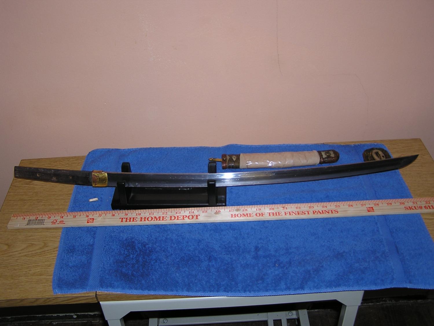

Yes, put the blade on a stand and make a picture of the whole naked blade from the front, not with the blade lying down as it skews perspectives.
And yes, from what I can see, I agree with Suguha based on ko choji/midare with nezumi ashi. And unfortunately, no, not a Muramasa! :)

JP - I can do that. Didn't know that lying down was inexact; had hoped the yardstick would reflect the sori well enough.  Almost glad it's not a Muramasa... I like to get it out and adsmire it. Glad that doesn't cost any blood!  I treat this one a slightly different, with a little more respect; due partly to the history that Bruce mentioned; and a little bit like what you said one time about Nihonto being alive. I try not to imagine what this blade has seen.  Viper is its name for a reason.

Thanks for the new pic. I wasn’t as much looking for the sori as I was interesting in seeing the tapering toward the kissaki. With this picture, I see what is a fairly uniform blade with an elongated kissaki verging towards Ō-kissaki. This shape is common to both late Edo and Momoyama periods. I’m tempted to say late Shinto, early Shinshinto, but I could be entirely wrong.
And you could be right!  There were many people who had the opportunity to argue, but didn't.    Thank You, JP, for the time and expertise.
David, Thank You for being willing to help!  Sorry I can't get a better shot of that munemachi; but the shortening forward probably erased much evidence. I understand that the hamachi can disappear after much polish. But it was moved forward, too. There is a lot of steel missing from polishing, leaving a "tired" but wicked blade.  I'd sure hate to be on the wrong end of it.

I think it is older, maybe Momoyama cut down, just based on the proportions from the last pic. Some swords are bitey.....be careful!
 There is a sort of consensus in my collector group, which includes two museum curators, that when a blade is marked but not worth a polish, you Uchiko the hell out of it. I will improve the look, possibly bring up a little more detail, and you are not doing anything that was not done to it during it's working life.

It looks as if the habaki has been forced over the machi; I recently bought a sword with the same issue, and with a piece of wood and a mallet, was able to tap it carefully back to remove it.
Hey, Dave, Thanks for the tip. I have read some conflicting opinions in the forum about Uchiko. Do think it will be useful on occasion; but worried that this one has already seen too much polish. I do want to try and rewrap that tsuka some day!
Steve, I hope you're right about the age. It doesn't seem to have a peacetime design. Mike Tyson would say that this blade definitely has "Bad Intentions".  I still have reason to research and compare with other eras; but with the reduced lines and my inexperience, it could be a long and fruitless effort.  It is what it is; I just don't know what that is.
The habaki was loose enough to slide up over the machi  about a quarter inch. That won't be happening anymore. Thanks for the feedback!
 Hiya Austus, Uchiko is not a polish, it's a clean up.  A polish involves stones and removing metal, Uchiko is more like removal of surface crap and the amount of metal removed is infinitesimal, about what a normal metal polish/shine would do... but in a traditional Japanese way.
 Not to be done on a blade in good polish/condition.
