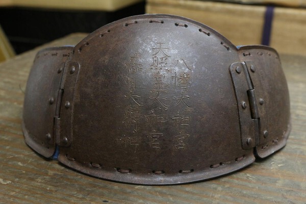

I have a growing interest in HITAI-ATE which were produced and worn mainly in the bakumatsu era for actual fighting (that is of course my personal point of view). I just bought one at KINOKUNIYA in Japan which has kanji carved on the front.
The google translation on the catalog gave me this :
This is a practical front that has the Sansha Shrine and "Hachiman Daigo, Amateru Daijingu, Hachimandai" engraved on the central iron plate and the left and right hinged iron plates.
- I understand that the SANSHA jinja is mentionned, but which one is it ? In which province ?
- "Hachiman Daigo, Amateru Daijingu, Hachimandai" it seems to be an incantation ? AMATERU, is it AMATERASU ????
- Is that really from the end of the EDO era ?
Can you give me a full translation and some explanation on those kanji, I will appreciate a lot.
Hi Gilles,
you were faster than me for the Hachigane!
Well, I think we have:
"八幡大神宮" (Hachiman dai jinguu - great god of war shrine)
"天照皇大神宮" (Ten teru ōgami - Amaterasu Oomikami sun goddess), (Tenshō Kōtaijingū)
"春日大明神" (Kasuga daimyōjin - Kasuga great gracious god)
