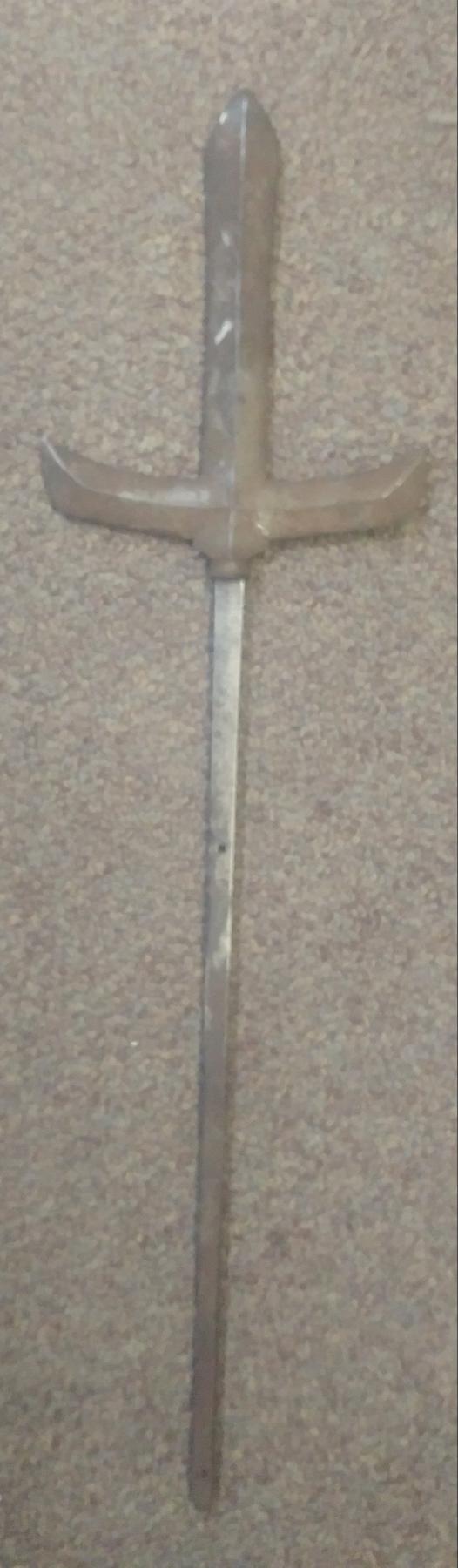

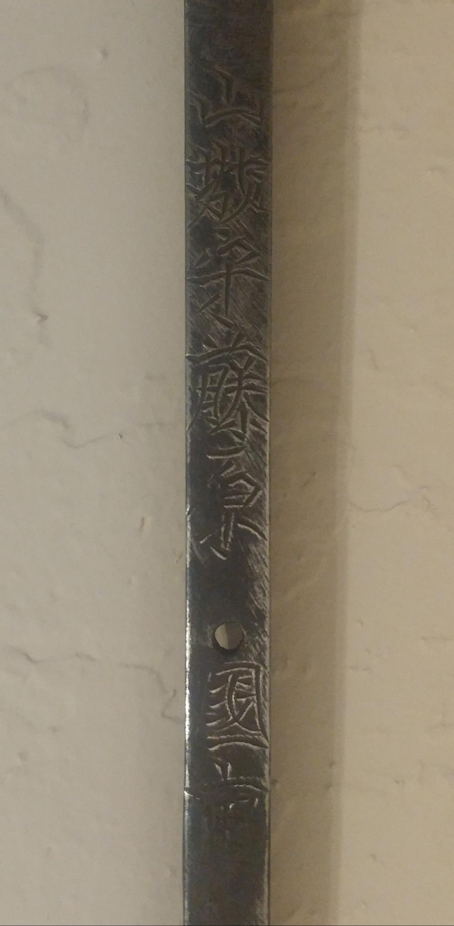

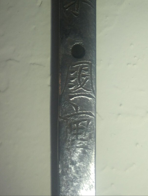

Rollingthunder Posted December 6, 2019 Report Posted December 6, 2019 I recently purchased, then returned, a Jumanji Yari, that was sold at auction. The original listing had a picture of the nakago and mei, but no maker. It was listed as having been made in the mid 17th century, early Edo period. A few days before auction, I went to auction house and took some pictures of Yari, nakago and mei. I reached out to some experts and their response, was that the maker was Yamashiro-no-Kami Fujiwara Kunishige, 5th generation Kunishige. 18th century, mid to late Edo period, 1781-1789. I felt that the Yari was incorrectly listed and returned it. I spoke with the auction house "expert" and they claim the Yari was made by Yamashiro-no-Kami Fujiwara no Kunihiro, and refused to accept what the other experts claimed. I found a Kunishige Yari for sale and the mei matched exactly the one I had. I presented this information to the "expert", and again they say it is wrong, the maker was Kunihiro. The item has been relisted, this time it says made by Yamashiro-no-Kami Fujiwara no Kunihiro. That is false and unethical. I am enclosing pictures of the Yari I purchased, and links to a site selling a Kunishige yari and the the auction site. What do you think?Kunihiro or Kunishige? http://sanmei.com/contents/en-us/p1931.html https://live.clars.com/lots/view/1-2EQ8SQ/Japanese-jumonji-yari-17c https://live.clars.com/lots/view/1-2I5CUE/Japanese-jumonji-yari-17c-signed-fujiwara-kunihiro Quote
Geraint Posted December 6, 2019 Report Posted December 6, 2019 Dear Carlos. Quite clearly this is signed Kunishige, I am at a loss to explain why the auction house are sticking to their erroneous conclusion except to say that very few auctioneers are sufficiently educated with regard to Japanese items and rely on an "expert" who they call on from time to time. If you bought it for 350 you did well but bear in mind that polishing these is not easy and getting someone to take on the task will be a little difficult. However I would have been happy to have a jumonji yari by this smith and would have dismissed the description without worrying about it. All the best 1 Quote
Bugyotsuji Posted December 6, 2019 Report Posted December 6, 2019 Regardless of which generation (clearly Kunishigé) I would have kept it too. Unbelievably cheap too. Quote
Brian Posted December 6, 2019 Report Posted December 6, 2019 I would have kept it at $300 (plus buyers %..maybe 25%?) even if it was mumei. With pole, even in that condition it is a good deal. Just love the shape. Quote
Rollingthunder Posted December 7, 2019 Author Report Posted December 7, 2019 While the price I paid was relatively low, to polish this Yari would probably cost in the neighborhood of $2000.00-$3000.00. That Jumonji Yari for sale in the Sanmei link, is around $3000.00 and it's in much better condition. I could have kept it, but it was a matter of principle. The fact that the auction house "expert" refuses to concede they are wrong is shear arrogance. The 100 year difference between when it was really made and the maker, can add significantly to the value. To make matters more interesting, I have found no reference ANYWHERE that Kunihiro made Yari's. As far as I could find, Kunihiro ONLY made swords. Quote

Rollingthunder Posted December 11, 2019 Author Report Posted December 11, 2019 UPDATE: After speaking with the department head at the auction house, they've conceded that their "expert" was wrong. They are going to correct the listing as to both dates of manufacture and name of maker... KUNISHIGE not KUNIHIRO! 2 Quote
