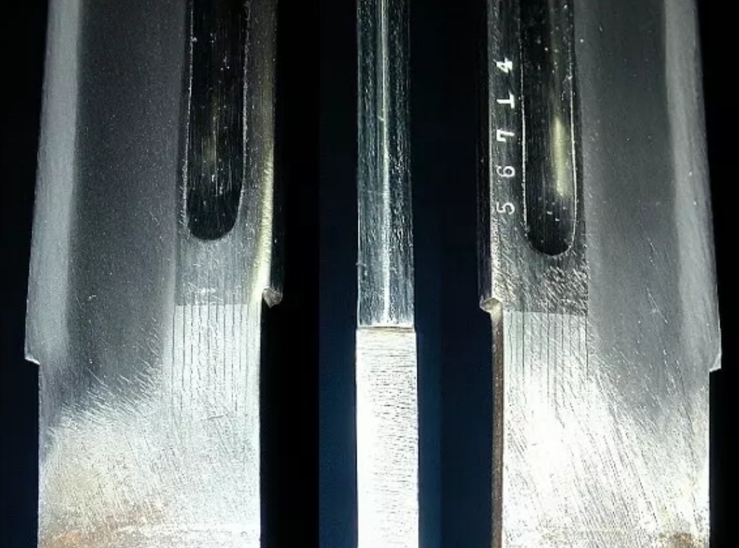

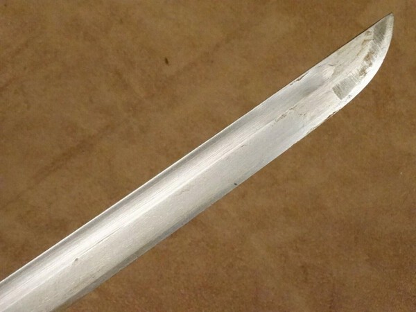

Shamsy Posted December 4, 2019 Report Posted December 4, 2019 Polished Iijima: Hamon of this sword is Sugu-ba Jihada is Ko-Itame-Hada You are correct, Chris. Some NCO have hamon. 3 Quote
vajo Posted December 4, 2019 Report Posted December 4, 2019 Thanks a lot Steve for showing! This is not from etching its real. This is some exciting... Quote

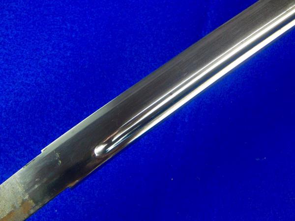

vajo Posted December 4, 2019 Report Posted December 4, 2019 I found another example: Look here. Quote

Shamsy Posted December 5, 2019 Report Posted December 5, 2019 On 12/4/2019 at 11:49 PM, PNSSHOGUN said: Steve your sword appears to be one of the "Zohei-To" used for Type 94 during the 30's. It's just a standard Iijima arsenal 95 in the usual configuration. Nothing at all special about the sword, other than the fact it's had a basic polish. 1 Quote

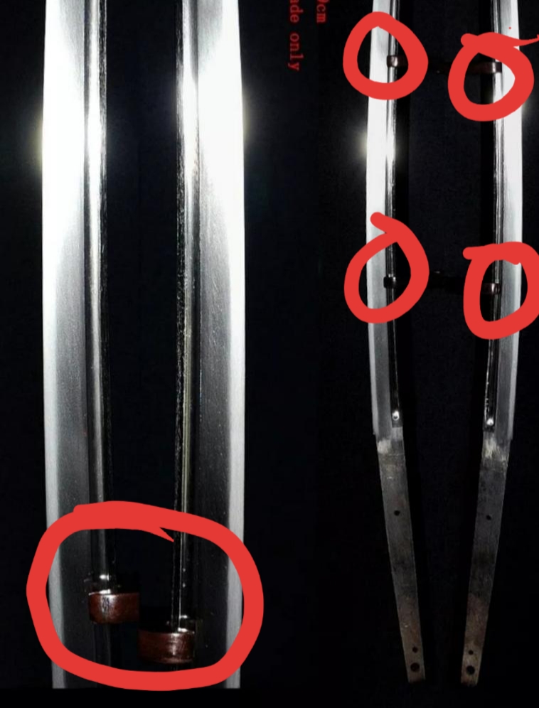

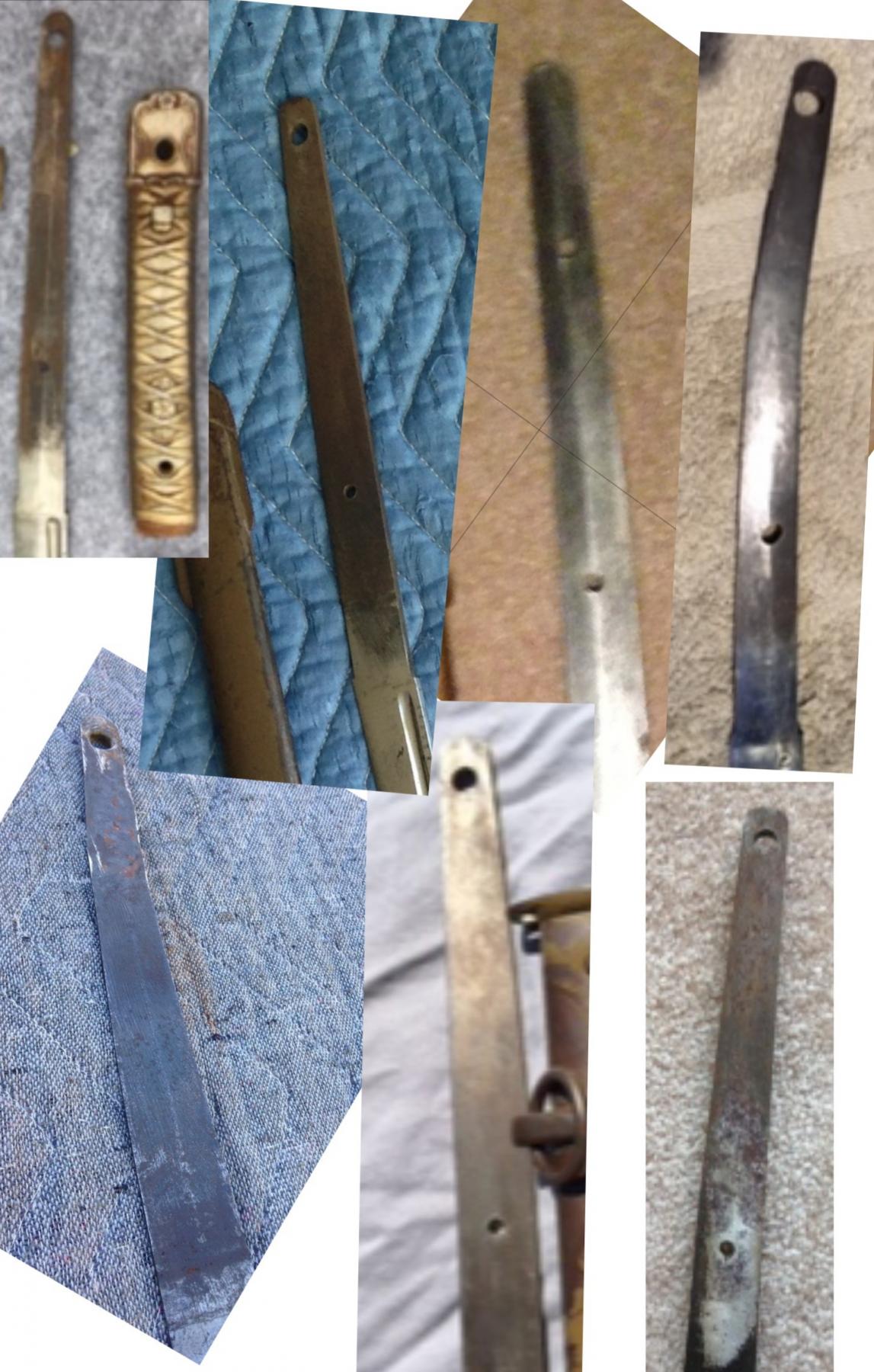

Bruce Pennington Posted December 5, 2019 Report Posted December 5, 2019 On 12/4/2019 at 10:07 PM, Shamsy said: Polished Iijima: Hamon of this sword is Sugu-ba Jihada is Ko-Itame-Hada You are correct, Chris. Some NCO have hamon. Steve, you're blowing my mind!!! Someone paid to have a Type 95 blade polished?! I had always assumed they had hardened the cutting edge. Who would make a sword without a hardened edge, right? But this clearly shows it! Wow! Now on that other one, is it a zohei-to? And WHAT are those holes on the mune? and what is that copper on the blade with a kanji???? Quote
Bruce Pennington Posted December 5, 2019 Report Posted December 5, 2019 Chris, Here's a shot of my copper. I wasn't sure if what I was seeing was hamon or a effect of sharpenning. 1 Quote
Shamsy Posted December 5, 2019 Report Posted December 5, 2019 The holes and copper bits, Bruce, are just the tips of the stand caught in the photo. They look terrible though, like snipped bits of blade. I don't think it's an amazing polish either mate, probably an apprentice in Japan or maybe an experienced but untrained Japanese dealer. It is really nice to see what a 95 may look like though. I can't quite figure it out from what you've written, but I'll just add that both pictures I posted are the same sword. It's a complete, matched Iijima in reasonable condition. 1 Quote
Bruce Pennington Posted December 5, 2019 Report Posted December 5, 2019 Oh, I see now! The serial number is just blocked/blacked out by shadows in the first photo. Sooooo why the odd nakago jiri and 3rd hole? Quote
Shamsy Posted December 5, 2019 Report Posted December 5, 2019 Now that sir, is a good question. Since I never take them apart, I don't have much to compare with. Quote

Bruce Pennington Posted December 5, 2019 Report Posted December 5, 2019 On 12/5/2019 at 12:53 AM, Shamsy said: Now that sir, is a good question. Since I never take them apart, I don't have much to compare with.Here are some of mine. 3 Quote
vajo Posted December 5, 2019 Report Posted December 5, 2019 I think we can now write that the information Type95 had no hamon, is false.They had one. ????I think many collectors of NCO swords will be happy and they look now deeper on their blades.@Bruce i see the hamon on your blade too. there is a lot of oil on it so i must take 3 filters to bring it out. now you see it better on your picture. A good one. 3 Quote

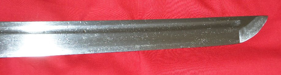

16k Posted December 5, 2019 Author Report Posted December 5, 2019 A lot of information about ALL WW2 swords is off the mark! I’m only recently here. Before that, I had absolutely 0 interest in those swords. All I’d read about them made them feel like very inferior items. I’ve loved so much about them in so little time since I’m here that my love for keeps increasing and I consider them as important as their revered ancestors. I can never thank enough all the great people of this forum for opening my eyes and my mind on such a neglected and derided part of sword history. You, gentlemen have my respect! As for my NCO, I did as Neil suggested and put it under LED light, and yes, it’s faint but it’s there! 3 Quote

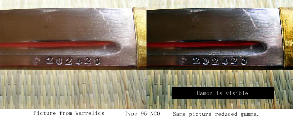

BANGBANGSAN Posted December 5, 2019 Report Posted December 5, 2019 looks like most of NCO sword should have straight hamon when out of factory.But as these been used more than the officer sword,hamon worn out quickly,not many NCO's polish their sword I assume.造兵刀 has straight hamon for sure,Maybe Type 32 has straight hamon as well? 3 Quote

vajo Posted December 5, 2019 Report Posted December 5, 2019 This from Ohmura looks like polished too. 1 Quote
16k Posted December 5, 2019 Author Report Posted December 5, 2019 Yes, that’s why I said the age took on a new light under the information of this thread. However, Ohmura says a little further down that from pattern 2 onward (at least that’s what I think I understand from the poor translation!) that the blades were oil tempered and without Hamon (so through tempered). So I guess that unless he is wrong, my seeing the shadow of a Hamon is probably wishful thinking. 2 Quote
