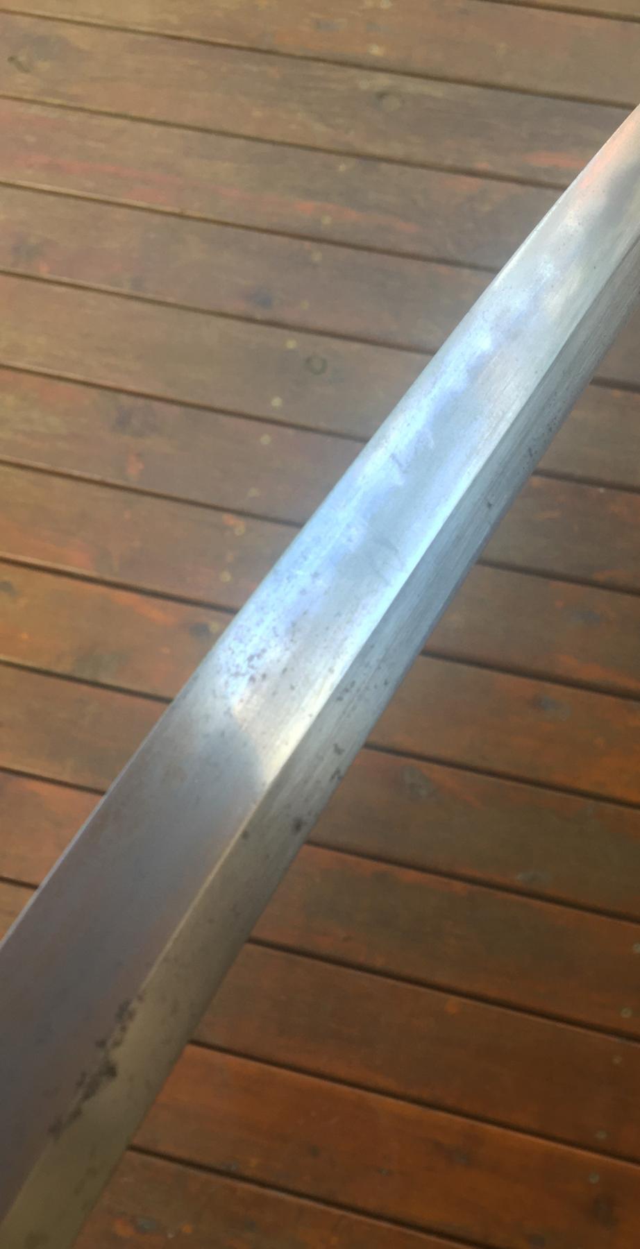

Alex Genikov Posted December 4, 2019 Report Posted December 4, 2019 Hello there! As I am new to a military swords Can someone clarify what is actually meant by "machine made sword". Since there were no CNC machines back then it could haven't been made by machine entirely. Is it just refers to a power aided hammer, drill or sending motor?! Is It still have to be forged and folded? Are this "machine made swords" made of one piece of steel or wrapped constriction? I guess if a modern clean steel has been used instead of inferior tamahagane, one will not need a wrapped constraction. This would be interesting to know, anyone can help? Would like to add that I am very sympathetic with Dave R at a look on military swords. On picture a machine made and arsenal stamped blade. Best of all Quote
vajo Posted December 4, 2019 Report Posted December 4, 2019 The term "machine made" is something hard to understand. There was no machine which made swords. Every Sword was made by hand. Also the NCO Guntos. But in use, there was taken industrial steels, damp hammers and oil hardening für NCO swords. Showa-to are handforged but not in the traditional way. They are made not from Tamahagene and they are hardned in oil. Only Gendaito are full traditional swords. Your sword with arsenal stamp could be a Showa-to. Not made in the traditional way. 3 Quote

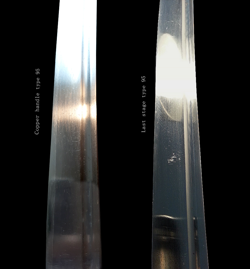

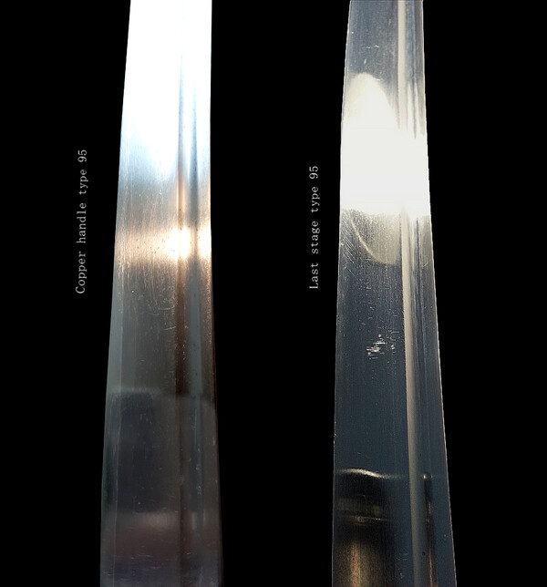

vajo Posted December 4, 2019 Report Posted December 4, 2019 Bruce when you look on a cooper handled NCO you will see that this is not like the point 9. description. I think you must judge every blade. I see so many different looking NCO blades. I will show a cooper handle balde and a last stage tpye95 NCO. Bruce, John, Neil, Shamsy please look on your copper nco and search for the temper line. I see under a good light a "real" temper (I'm not sure if that could be done with etching). On the last stage type 95 i also see a temper and a black shadow above this line. 3 Quote
