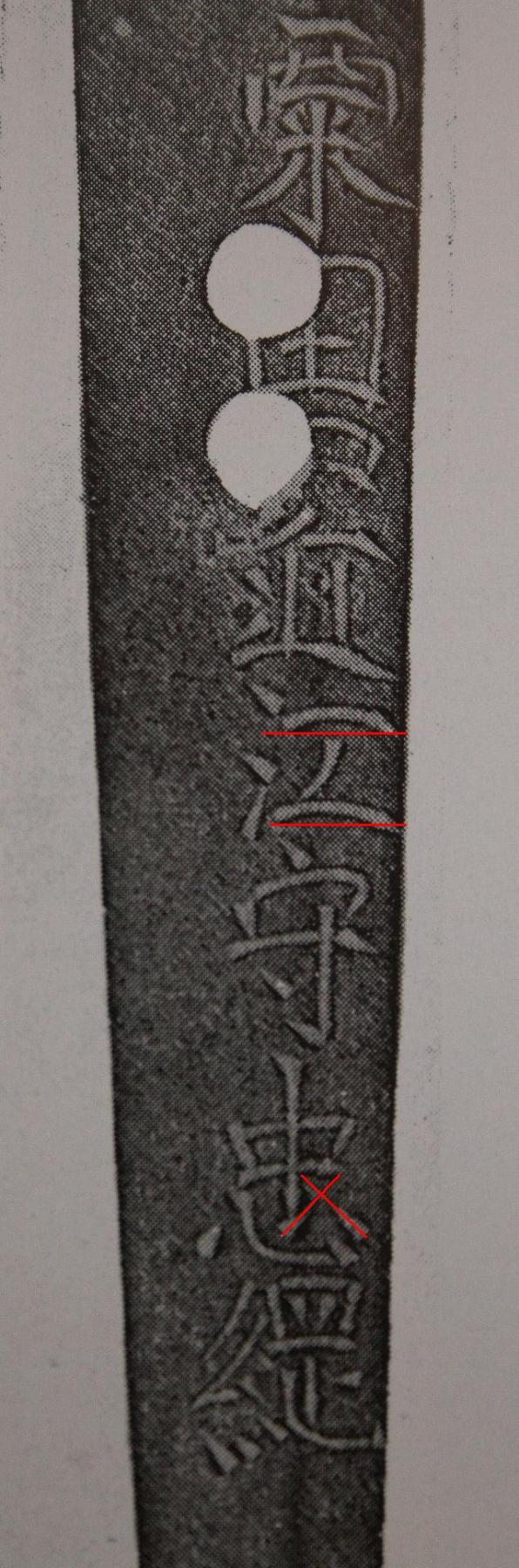

Jacques Posted December 9, 2019 Report Posted December 9, 2019 On 12/8/2019 at 5:22 PM, Brian said: He did seem to have a preference for where the mekugi ana went. I remember Darcy's excellent article on placement, but can't remember which smith it dealt with. Have to go look it up again It's this one but unfortunately this article is full of errors http://www.nihontomessageboard.com/mei_exercise.html Quote
b.hennick Posted December 9, 2019 Report Posted December 9, 2019 I, for one, would like to read your views on Darcy's post. Please point out the errors to me and others who are interested. Quote
Jacques Posted December 9, 2019 Report Posted December 9, 2019 Errors are 1 - Location of mei is not based on mekugi-ana but centred on nakago shinogi 2 - Darcy confuses Shodai mei, early nidai mei and late nidai mei. Quote
b.hennick Posted December 9, 2019 Report Posted December 9, 2019 Thank you Jacques. I hope to study this soon. Quote
Jacques Posted December 9, 2019 Report Posted December 9, 2019 How to recognize shodai and nidai Tadatsuna when they signed the same way. Quote
