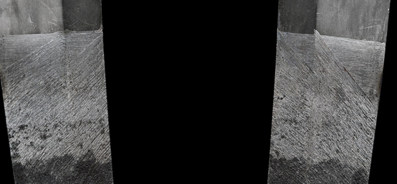

lonely panet Posted December 1, 2019 Report Posted December 1, 2019 who else thinks this possible nagamitsu si all types of SUSSSPECT, those new file marks????? the very sharp change of patina ??? Quote
vajo Posted December 1, 2019 Report Posted December 1, 2019 Hamfish the pictures are very small. Did you have them from AOI? This one: Looks good for me. 1 Quote
PNSSHOGUN Posted December 1, 2019 Report Posted December 1, 2019 My guess is severe active rust was removed when it was polished. Quote
16k Posted December 1, 2019 Report Posted December 1, 2019 Don’t think there is foul play here. Quote
Bruce Pennington Posted December 1, 2019 Report Posted December 1, 2019 I see deep patina in the depths of the file marks. Quote
SAS Posted December 1, 2019 Report Posted December 1, 2019 Possibly machi okuri but fine otherwise, in my opinion, for what it is worth. Quote
lonely panet Posted December 1, 2019 Author Report Posted December 1, 2019 Iv never seen a such a clean transition of from patina to clean steel. Not a chemical cleaning?? Quote
Bruce Pennington Posted December 2, 2019 Report Posted December 2, 2019 Oh, I see what you mean. That is strange, isn't it! Could it simply be that the togishi polished part way down the nakago, then stopped? Quote
dwmc Posted December 2, 2019 Report Posted December 2, 2019 On 12/1/2019 at 10:49 PM, Hamfish said: Iv never seen a such a clean transition of from patina to clean steel. Not a chemical cleaning?? File marks appear undisturbed. Agree with Hamfish...some sort of chemical application/cleaning. Dave M. Quote
