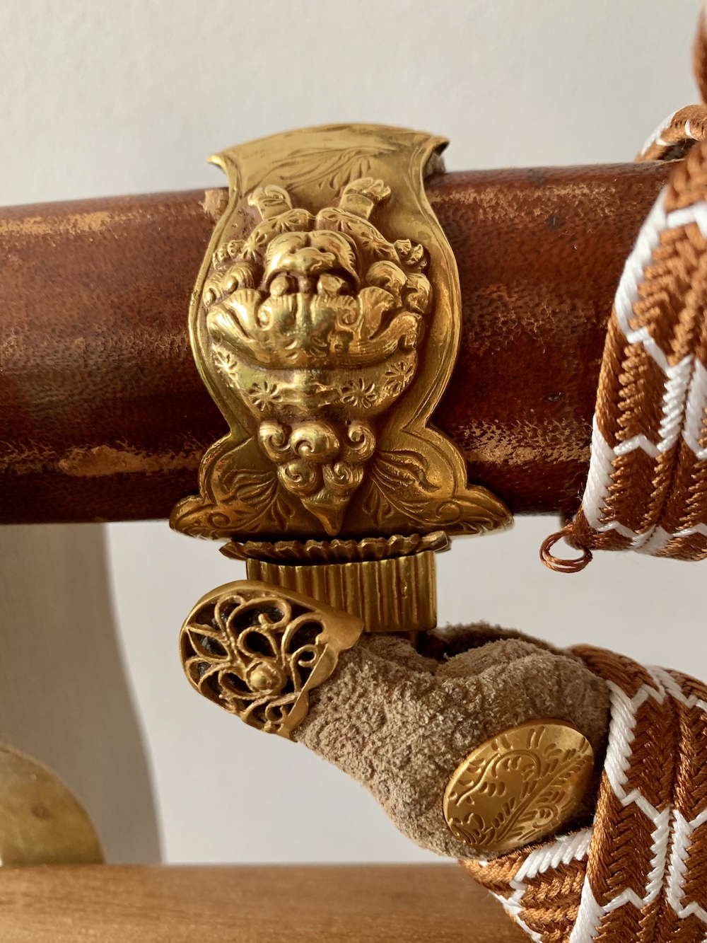

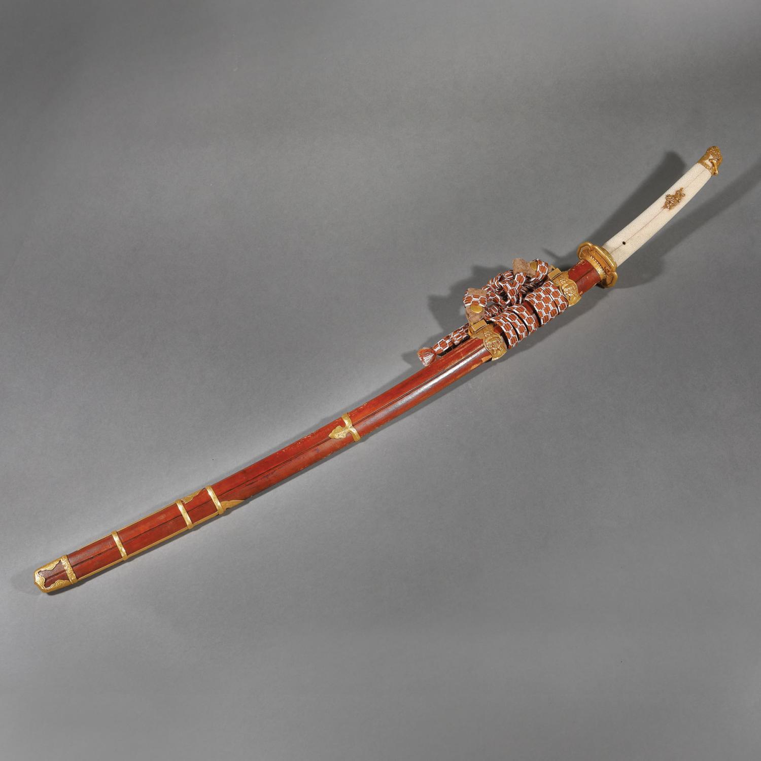

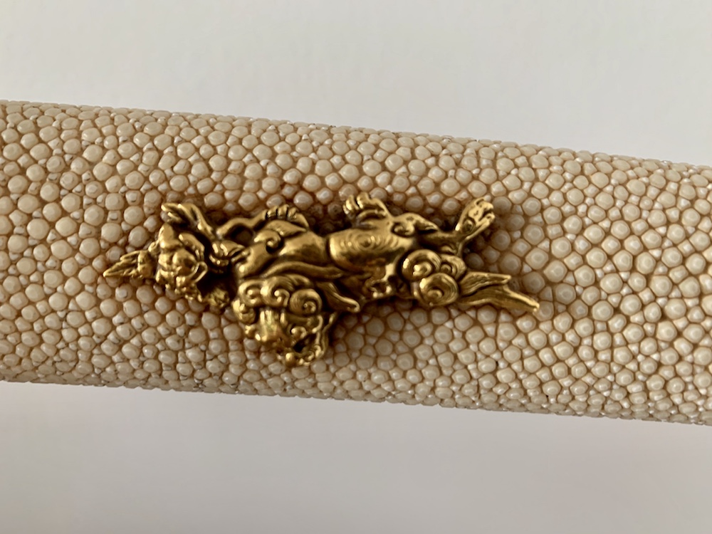

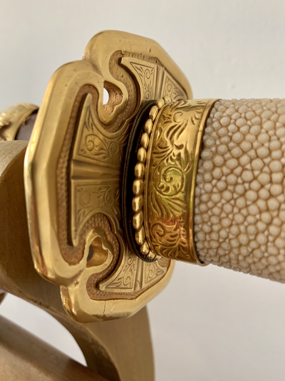

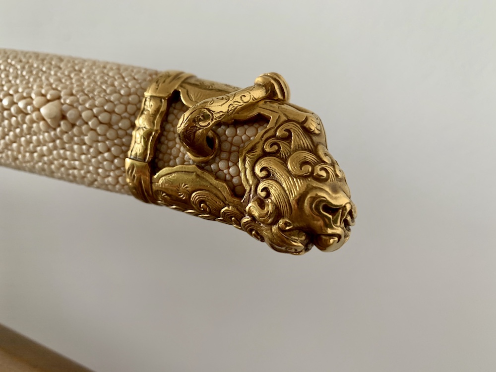

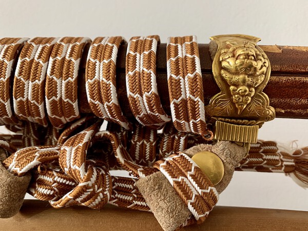

Geraint Posted December 1, 2019 Report Posted December 1, 2019 Hi Adrian. At this stage your sword appears to be about right for the period. Unfortunately the sword in your link is quite another story. While the mounts appear superficially similar and they are both tachi mounts, they are of a different type and though both may have been made for the coronation they are of two very different qualities. Your sword is Imperial only in the sense that it may have been worn in the presence of the Emperor. It would be helpful if you could give us some close ups of the hilt fittings and the scabbard hangers as the are not typical for this type of sword. Looking forward to seeing them. All the best. Quote
PNSSHOGUN Posted December 2, 2019 Report Posted December 2, 2019 Lovely presentation Tachi by a very well regarded Taisho smith. Quote

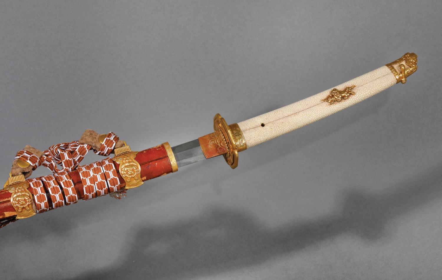

Nobody Posted December 2, 2019 Report Posted December 2, 2019 I found a real coronation tachi made by Minamoto Yoshichika here. Ref. http://www.sword-auction.jp/en/content/as17331刀%EF%BC%9A源良近%EF%BC%88御大典の太刀-katana-minamoto-yoshichika I suspect that your blade was originally made as a katana, not a tachi. The signature on your katana is chiseled as a katana mei. The position of the mekugi-ana is too close to habaki as a tachi. ● The above link does not properly work when it is copied here. 2 Quote

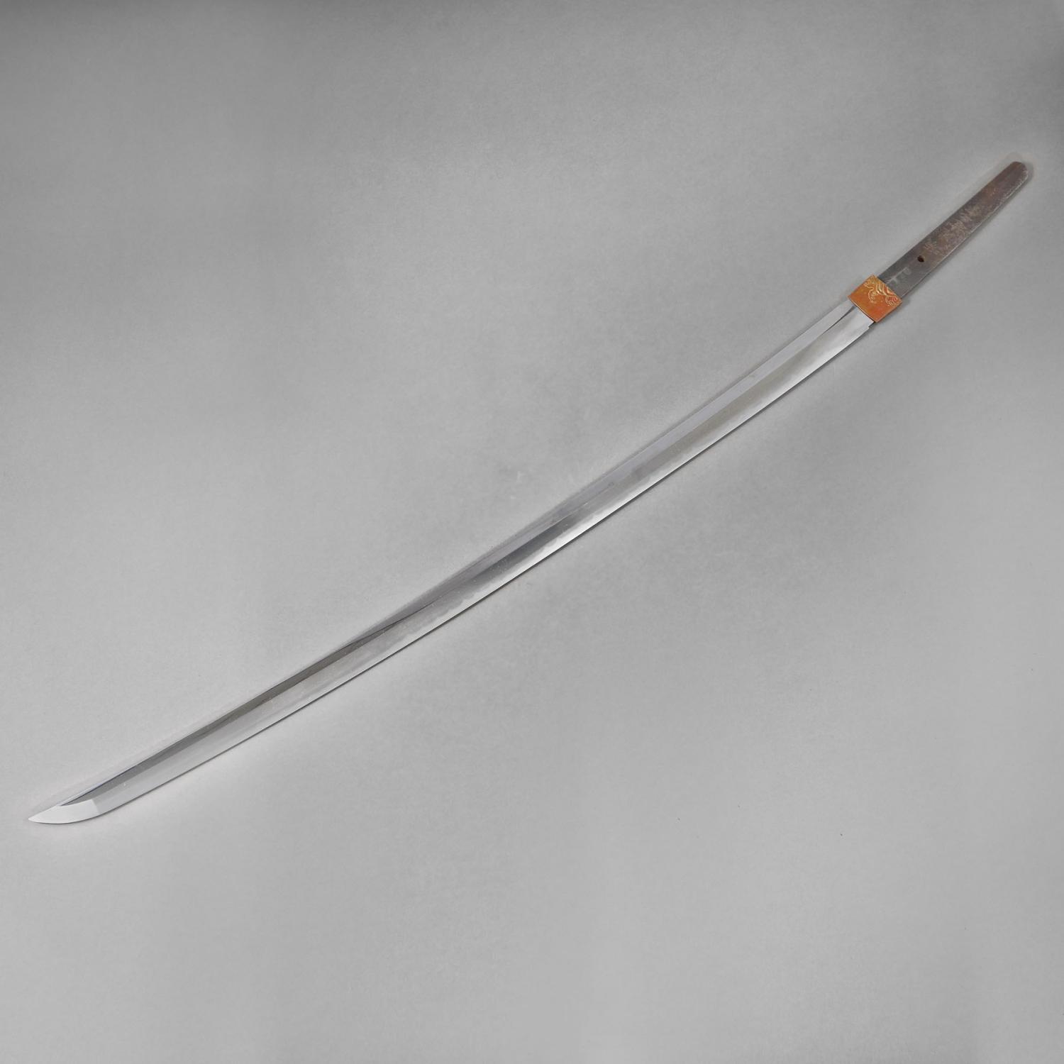

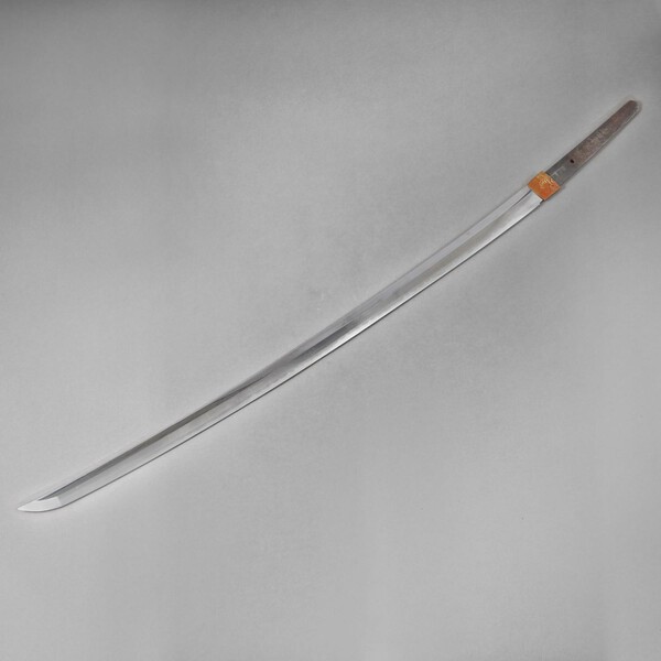

Jacques Posted December 2, 2019 Report Posted December 2, 2019 Takanoha yasuri are not those usually used by Yoshichika... Red flag ? 4 Quote
16k Posted December 2, 2019 Report Posted December 2, 2019 On 12/2/2019 at 8:10 AM, Jacques D. said: Takanoha yasuri are not those usually used by Yoshichika... Red flag ? That was my point too, but everyone else seems to think it’s the real deal, so... Quote
Adrian I Posted December 2, 2019 Author Report Posted December 2, 2019 Thank you all for your comments and info! I have made some more pictures of the fittings, as requested. Will make also detailed pictures of the blade 1 Quote

PNSSHOGUN Posted December 2, 2019 Report Posted December 2, 2019 On 12/2/2019 at 8:10 AM, Jacques D. said: Takanoha yasuri are not those usually used by Yoshichika... Red flag ? You're absolutely right, I have not seen a Shodai or Nidai Yoshichika using those before. The finishing of the Nakago Jiri is also not consistent. Looking closer at the Mei it makes me concerned this is one of the "Komonjo" Gimei. 2 Quote

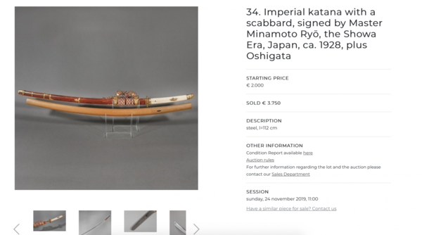

Adrian I Posted December 2, 2019 Author Report Posted December 2, 2019 If most of you think the blade is fake, I can make a complaint to the auction house, all purchases are protected and assured that they are real as described. I have also attached a photo to the auction house page with the product description... Quote
Ray Singer Posted December 2, 2019 Report Posted December 2, 2019 Note the plugged mekugi-ana. This looks like a Seki Showato which has been given a gimei of Yoshichika. 3 Quote
16k Posted December 2, 2019 Report Posted December 2, 2019 Yup, Sekii Showato was my guess too. I’ve just noticed it comes with an Oshigata. Can you post it? Do the blade and Oshigata match? Quote

16k Posted December 2, 2019 Report Posted December 2, 2019 I don’t know how much you paid for it, but IF we are right, and for that, I’d like to see more of the blade, then the blade has no value. The koshirae is still quite nice so may be worth something, but I am no specialist. Quote

Brian Posted December 2, 2019 Report Posted December 2, 2019 Moriyama san gave a good analysis. Those points alone are grounds to hesitate. And yes..one ana has been closed off, so this is not the original mount. 1 Quote
Adrian I Posted December 2, 2019 Author Report Posted December 2, 2019 Just spoke to the auction house.... wants me to provide the opinion of an expert to specify that the sword is not as described. Can you recommend anyone ... please. In Romania we do not have anyone specialised in this area... ( Quote
Adrian I Posted December 2, 2019 Author Report Posted December 2, 2019 On 12/2/2019 at 11:36 AM, 16k said: I don’t know how much you paid for it, but IF we are right, and for that, I’d like to see more of the blade, then the blade has no value. The koshirae is still quite nice so may be worth something, but I am no specialist. I payed a little more than 4000 Euro, with the auction house fee Quote

Tom Darling Posted December 4, 2019 Report Posted December 4, 2019 The shira-saya is well made. Good luck in getting your return. Peace. Tom D. Quote
