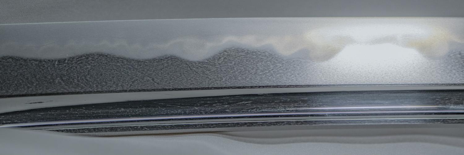

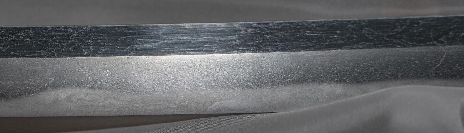

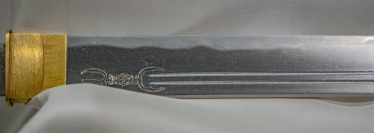

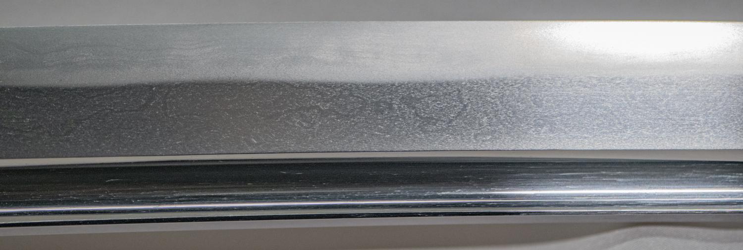

CSM101 Posted November 29, 2019 Report Posted November 29, 2019 For comparison: some photos. Uwe G. 9 1 Quote
piryohae3 Posted November 29, 2019 Author Report Posted November 29, 2019 Are all of those shinsakuto? Quote
CSM101 Posted November 29, 2019 Report Posted November 29, 2019 #1 = Tanto; mumei, Juyo Bijutsuhin attributed to Masamune; known as Hachisuka Masamune #2 = Katana, shumei Rai Kunimitsu #3 = Tachi, signed Sanekage (Ko-Hoki) #4 = Wakizashi; signed Hizen Tadahiro #5 = Katana signed Gassan Sadatoshi, dated Heisei 30 = 2018 Uwe G. 8 1 Quote
piryohae3 Posted November 29, 2019 Author Report Posted November 29, 2019 Koto or modern, they all look pretty darn good to me. 3 Quote
Vermithrax16 Posted November 30, 2019 Report Posted November 30, 2019 Longest running debate in Nihonto. Nothing to ad. Great works can be found across all the era's. The accepted rule is that the better Koto era blades are better works than the other era's. In the end it's going to come down to what appeals to any one collector and what they are after/find they desire. 8 Quote
Ken-Hawaii Posted November 30, 2019 Report Posted November 30, 2019 Koto or modern, they all look pretty darn good to me. James, look CLOSELY at those blades. Can you see the nie & nioi? Can you tell which hamon is which? Can you see why Gassan hada is different from Rai? Good job, Uwe! Quote
