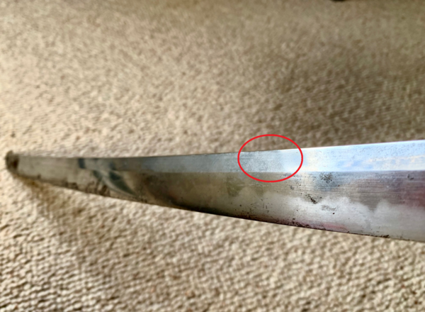

SteveM Posted November 28, 2019 Report Posted November 28, 2019 Sound advice from Paul. The blade is in bad shape, but it may be worth saving. The swordsmith is a good one (again, if the signature is legitimate). There is a fingerprint on the blade that you should try to wipe off with a soft cloth. See the red circle in the picture below. I wouldn't spend much more time photographing the scabbard and the fittings. The sword most likely predates WW2 by over two centuries. The fittings don't tell us anything about the authenticity of this particular blade. They are part of the provenance, so they aren't worthless, but if the blade is authentic and is salvageable, you will probably want to have a new shirasaya and habaki made after getting the blade polished. Don't worry about all of this yet. First step is to get someone who knows something about swords to take a close look, and I think you have several options available to you for this. Quote
Ru55 Posted November 28, 2019 Author Report Posted November 28, 2019 Thanks guys. Paul I've DM'd you as requested. The fingerprint was removed during the light oiling so no issues there now. Thanks for the heads up Steve. My question about value was to determine the potential value of the blade if it is as thought and in good condition. I completely understand the subjectiveness to any answer, but felt a ballpark figure would guide any decisions I make going forward. Apologies if asking for a valuation of sorts is the wrong thing to do. I've already had DM's asking if I want to sell it so wanted to have a better understanding of my position. Although it must be said selling it is not what I have in mind at this point. It's presence within my family household is one of a decreasing set of constants as life goes on and as such sentimentality far outweighs everything else right now. 3 Quote
