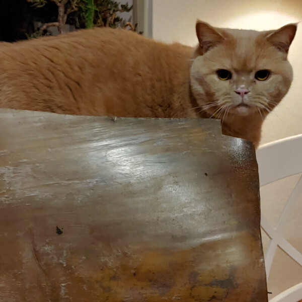

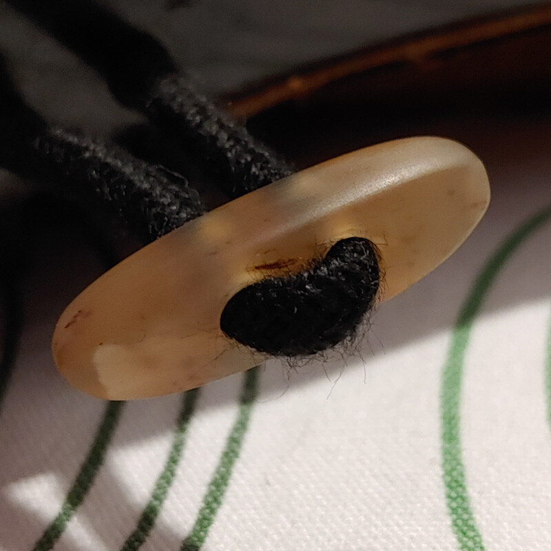

Andi B. Posted November 2, 2020 Author Report Posted November 2, 2020 Hello again, What is the best solution to clean the urushi parts of an armour? I want to remove dust and grime and maintain/preserve the surface. Dry microfibre, oil, wax...? Thanks! Oh, I should stop cutting missing horn parts and better play with the cat... 1 Quote
