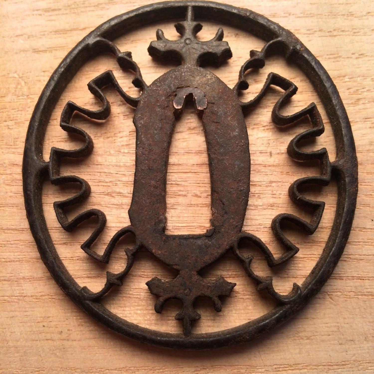

HannesT Posted November 23, 2019 Report Posted November 23, 2019 Hello everyone, I would like to ask you for tips to restore the patina (blank spots, rust) I already heard the following ideas: - Boiling water - Spit (no joke) - Storage exposed to weather, windowsill or similar Of course, I don't want to damage the tsuba Have you already tried to restore it yourself—or better leave it to the pros? It concerns the Tsuba attached. Thanks Hannes Quote

ROKUJURO Posted November 23, 2019 Report Posted November 23, 2019 Hannes,all drastic methods should absolutely be avoided!There are some professionals who can do this so that would be the safest way.Important thing in case you want to give it a go yourself: You should know what a good and authentic patina looks like. Removing active rust comes first. Please use nothing but a (relatively) soft pointed tool made from ivory, bone, hardwood, antler or alike (even pure copper), and clean with a dry cloth. Iron TSUBA can be handled without gloves and will profit from that. Exposing them to moist conditions (windowsill) will produce a thin coating of red rust in a short period of time. If you wipe the TSUBA regularly with a dry cotton cloth, a nice patina may appear after a loooong while. Be patient! 1 Quote

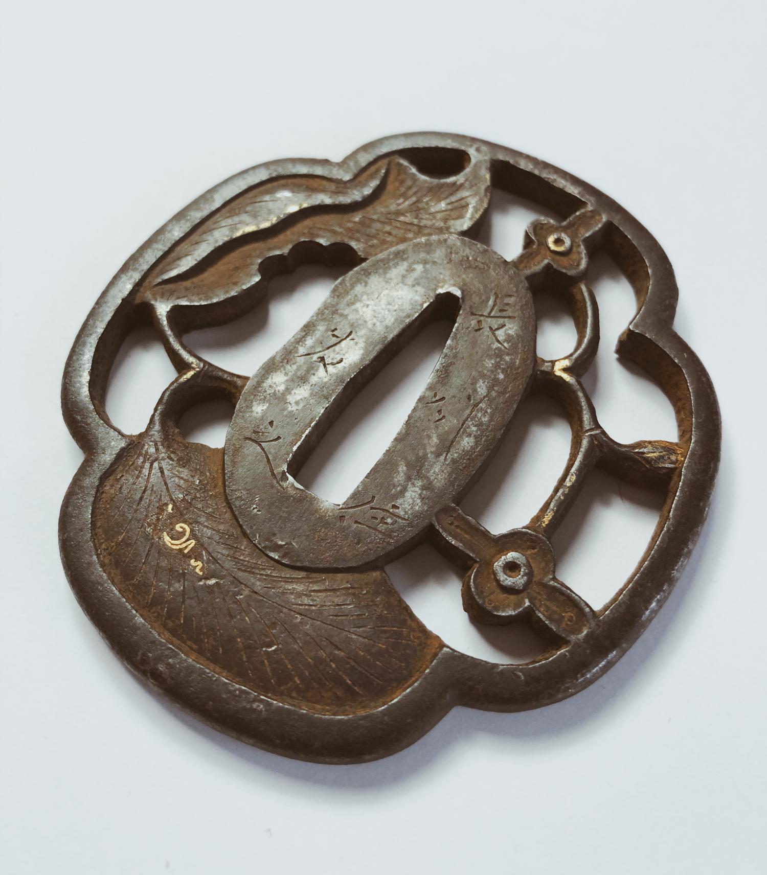

vajo Posted November 24, 2019 Report Posted November 24, 2019 A good care on iron tsuba brings it back to a good condition. But it needs a lot of time. I bought a tsuba in bad looking condition. After a year of care it looks like this now. I cleaned it with a mild soap and a toothbrush (hard). After that good drying, for the first weeks i sprayed it with caramba70 and cleand it every Friday with a cotton cloth. Over the summer i removed the oil, put it in a shoes box in the garden shed. Once a week a wipe it with a cotton cloth. After the summer i gave it some choji oil and stand it in the shelf. No mechanical treating at all. I like this piece a lot. And as Jean said i take it not with gloves, only with bare hands and it gets more beautifull every day. 4 Quote
