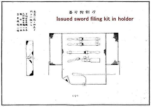

Shamsy Posted November 19, 2019 Report Posted November 19, 2019 The difference in edges may have been a result of the introduction of a sharpening guide given to soldiers and outlined in reasonable detail by Nick. Because of the lack of cutting power, I believe the army issued instructions regarding hand sharpening of blades, as the arsenal was not providing an adequate edge. 1 Quote

Austus Posted November 20, 2019 Report Posted November 20, 2019 Thanks, Steve, that makes plenty of sense. As for cutting power, I'd hate to fight with one of these. Maybe from a running horse. And Hamfish, Thanks for showing the booklet Steve mentioned. Very Cool. I've yet to see that kind of tassel in person. And Kenny... Beware. Your new sword could spark a lifelong passion for Japanese swords. But you'll have plenty of company. Quote
Dave R Posted November 20, 2019 Report Posted November 20, 2019 Most 19thC military swords had the same problem when dealing with thick winter clothing. A friend of mine thinks the problem was a change in sharpening methods from file sharpening to stone sharpening, (NB not Japanese style stoning). File sharpening gives a "feather edge" possibly the zig-zag mentioned above, which is a good ripping edge, especially effective on cloth. 1 Quote
Bruce Pennington Posted November 20, 2019 Report Posted November 20, 2019 Like this. When I got mine, I assumed the rough filing was a Bubba-job. But a thread came up where we discovered several in this condition and it as said to be done in the field. 1 Quote
