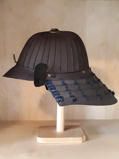

While waiting for the menpo, i try to finish the kabuto.
The ukebari liner is missing so i will start to make one by myself. David Thatcher is writing that it is better to have a Kabuto liner inside while the helm is resting on its stand.

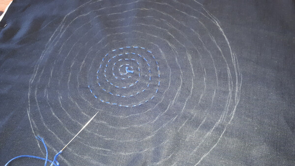

After that i cut out the template an bring it with tailer chalk on the outer fabric.
Then i paint the spiral for the stitches too with the chalk.
Now i bring the pieces strong together with 6 needles.
Lets go with making the stitches...  :laughing:
I choose a thick blue nature string for the stitches.
These are the first ones...

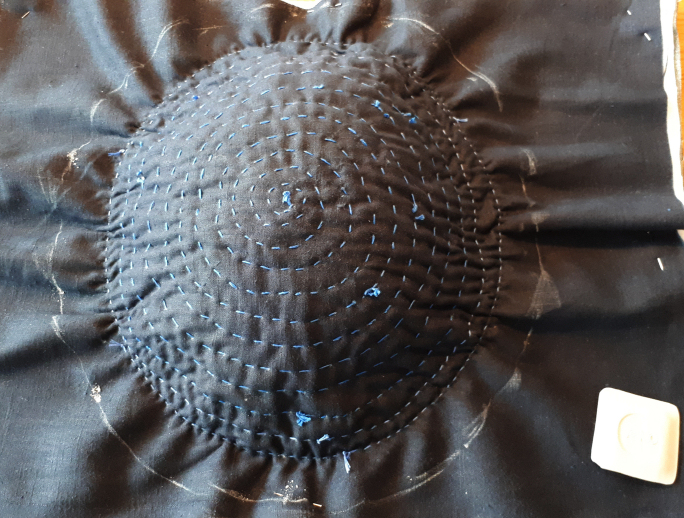

After some hours it looks like this - not very far

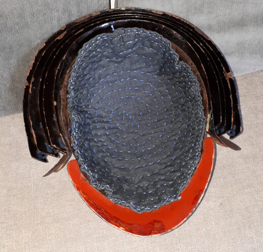

This is how it looks on the inner side which you will see.
Me fingers hurt now and i will be stop for the day.  :beer:  :beer:
  • Like 6
Vajo, As you sew further towards the outer edge, keep pulling the thread so as to make the cloth pucker more and more and will then form the curved shape you need. When it is done it needs to fit into the helmet bowl leaving a space of about 2 or 3cm from the top of the lining to the inside top of the helmet bowl. You can then sew it temporarily into the helmet using the pairs of holes around the edge of the koshimaki and cut off the excess cloth. It pays to mark the edges of the cloth where it is sewn to the helmet to make sure it goes back properly later. Now take it off the helmet again and sew a strip of leather around the inside of the lining, about 2 - 3cm from the edge, the strip being wide enough to fold up and over the edge of the koshimaki. You can now sew the lining back into the helmet and fold the leather up and over the edge of the koshimaki, pasting or gluing the 1cm or so of leather to the outside of the koshimaki, This overlap will be hidden by the shikoro when it is fitted in place. For heavy helmets it was usual to fit two strips of leather above the lining, sewn to the koshimaki and crossing each other diagonally so to speak. These helped take the weight off the more fragile cloth.

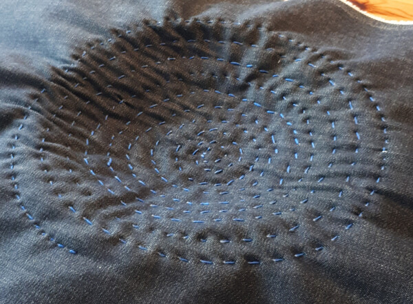

After some hours later, it became more and more like a hood.  :clap:
Outer side
Head side

The first bundle of string 8m is empty now. I have finished half the way so i think i need another 8m of string.

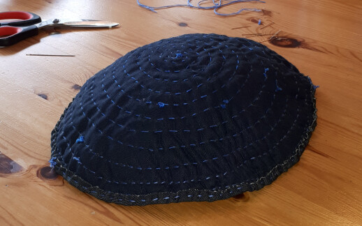

I finished the stitches this morning.
and cut out the ukebari
a first test was promising...
