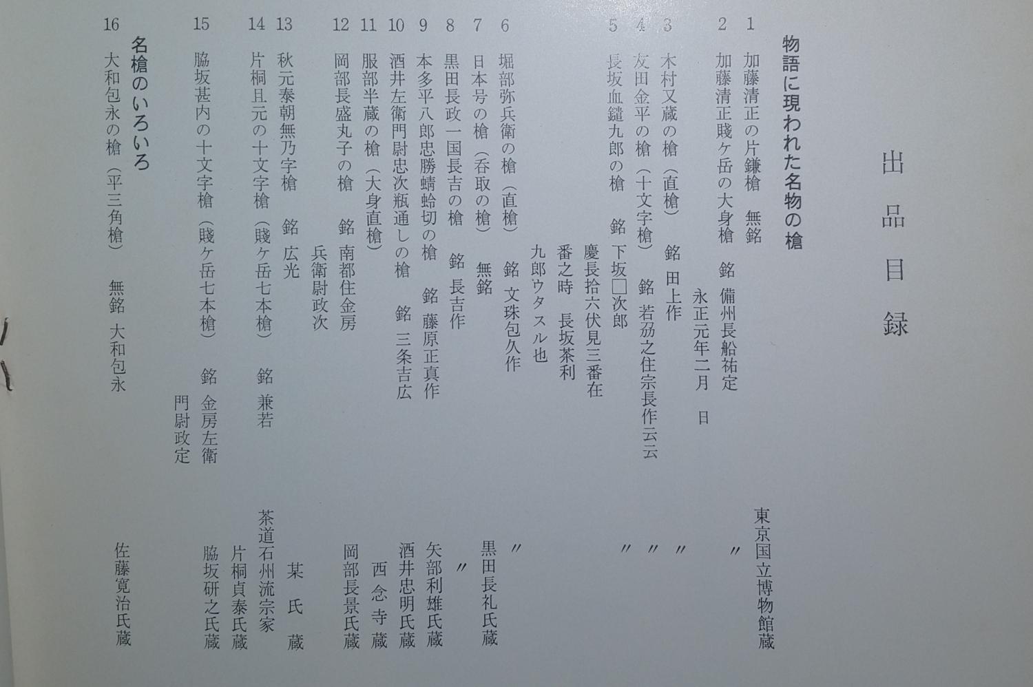

I was hoping perhaps someone has an English index of the following book. Or if there isn't one and someone wants to help I can photograph the pages with the numbers and titles.
Nihon no Mei Yari Ten

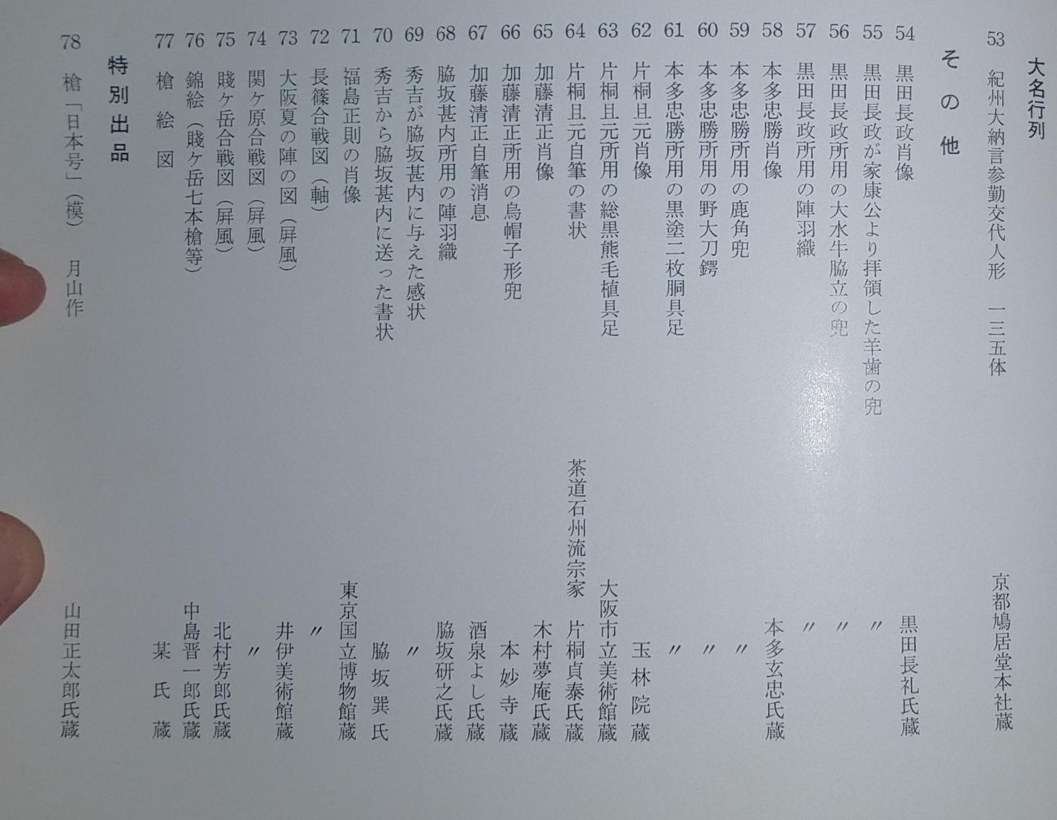

My apologies for the delay in adding the index pages. So busy lately it's a miracle I got to it.
I'll add the correct photos in the right order in a bit. I need the computer to do it properly.
These are all entries for various yari, listing the mei and the institution (museum or collection, etc.) where the yari is kept. The first section is "Famed Yari of Literature", the second section is "Various Famous Yari" the third section is "Various Famous Yari (unusually shaped)", then "Various Saya", "Daimyo Procession", "Other", and lastly "Special Display/Exhibit". It would be a bit of work to translate this. Not difficult, just time consuming.

Here is a small summary of first 50. Some info is missing from this like beginnings of many of the first 15 as I don't know the correct names of people except Katō Kiyomasa. Probably an error of two in the mix but I hope it helps.
1. Katakama-yari - Spear of Katō Kiyomasa - mumei
2. Ōmi-yari - Spear of Katō Kiyomasa – mei: Bishū Osafune Sukesada (1504)
3. Su-yari – mei: Tagami saku?
4. Jūmonji-yari – mei: Jakushū kore jū Munenaga
5. Yari – mei: long mei…
6. Su-yari – mei: Monju Kanehisa saku
7. Nihongō – (one of three great spears) mumei (attribution to Kanabo not mentioned here)
8. Yari – Nagayoshi saku
9. Yari – Tonbogiri (one of three great spears) – mei: Fujiwara Masazane saku
10. Yari – mei: Sanjō Yoshihiro
11. Ōmi-su-yari
12. Yari – mei: Nanto Kanabō Hyōe no Jō Masatsugu
13. Yari – mei: Hiromitsu
14. Jūmonji-yari – mei: Kanewaka
15. Jūmonji-yari – mei: Kanabō Saemon no Jō Masasada
16. Hirasankaku-yari – mumei Yamato Kanenaga
17. Yari – mei: Bishū Osafune Norimitsu (1477)
18. Yari – mei: Bishū Osafune Tadamitsu (1484)
19. Yari – mei: Bishū Osafune Tadamitsu (1489)
20. Yari – mei: Tadamitsu
21. Yari – mei: Bizen no Kuni jū Osafune Hikozaemon Yoshimitsu (1483)
22. Ōmi-yari – mei: Bishū Osafune Norimitsu (1488)
23. Yari – mei: Bishū Osafune Koremitsu (1495)
24. Ōmi-yari – mei: Fujishima Tomoshige
25. Yari – mei: Uda Kunitsugu saku (1485)
26. Yari – mei: Muramasa
27. Yari – mei: Muramasa
28. Ōmi-yari – mei: Nagayoshi saku
29. Ōmi-yari – mei: Yoshisuke
30. Ōmi-yari – mei: Sōshū-jū Sukehiro
31. Jūmonji-yari – mei: Kanabō Masazane
32. Kama-yari – mei: Nōshū Seki jū Kanesaki
33. Yari – mei: Nōshū Gifu jū Daidō (1585)
34. Yari – mei: Jōshū Umetada saku (1593)
35. Yari – mei: Sagami no Kami Fujiwara Masatsune Nyūdō
36. Yari – mei: Masatsune
37. Yari – mei: Hizen no Kuni Tadayoshi
38. Yari – mei: Hizen no Kuni jū Musashi no Daijō Fujiwara Tadahiro
39. Ōmi-yari: Heianjo jū Kunimichi saku (1612)
40. Yari – mei: Nagasone Okimasa
41. Jūmonji-yari – mei: Yamashiro no kuni Shimosaka saku
42. Sasaho-yari – mei: Yoshū jū Yasuyoshi saku
43. Ōmi-yari – mei: Minamoto Masayuki (1845)
44. Kawarimi-yari
45. Kikuchi-yari - mumei
46. Kama-yari – mei: Biyō Osafune jū Yokoyama Sukekane saku kore (1867)
47. Ka-yari (Kago-yari?) – mei: Sasshū jū Oku Motohira saku
48. ??? Tsukikama-yari
49. Fukuro-yari – mei: Nobukuni
50. ???

I agree with most posted above. One correction though as the 4 pictures I added are on 2 pages in the book. The costs involved using Markus to get a professional translation wouldn't be too much, however I just became a father and honestly I don't have any income that I can currently spare on hobbies and the like, which is why I came here first. I can live without a translation but figured asking wouldn't hurt (the wallet).
