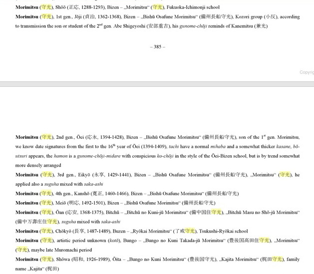

A more extensive source suggests to me your sword may be late Muromachi:
https://books.google.com.au/books?id=46IYtI0nkiEC&pg=PA386&lpg=PA386&dq=%E5%AE%88%E5%85%89&source=bl&ots=BRIb_4XTPw&sig=ACfU3U1wVNQqla9uC0S-jrFlTpVnX4ACSg&hl=en&sa=X&ved=2ahUKEwil38KxqMPlAhWoILcAHdv4CW04ChDoATAAegQICRAB#v=onepage&q=%E5%AE%88%E5%85%89&f=false
Here is a copy of the page from Markus Sesko's marvellously useful book:
