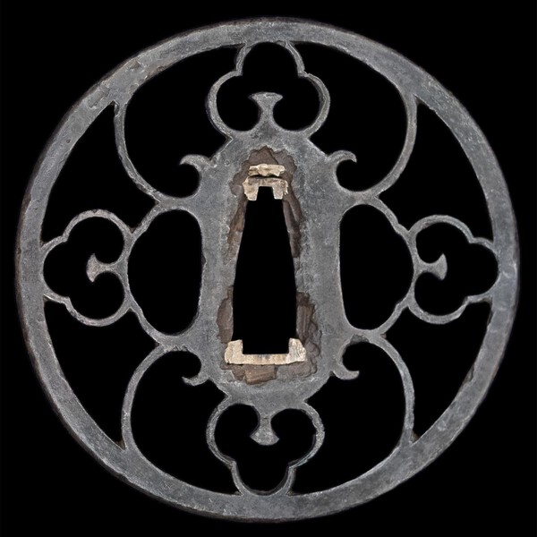

rkg Posted February 8, 2020 Report Posted February 8, 2020 And... At the risk of getting a new one ripped for discussing a closed auction (which happened to me not tooo long ago on FB), here's another piece just like the modern piece I posted earlier in this thread that just sold on Yahoo Japan - attributed to the Edo period, of course... At least somebody got it for an iai tsuba price. https://www.sendico.com/ayahoo/item/t703248513 Oh, and for posterity, here's an image from the auction - note that I do not own the copyright for this image and it is presented here only for educational/criticism purposes... Best, rkg (Richard George) 1 Quote
