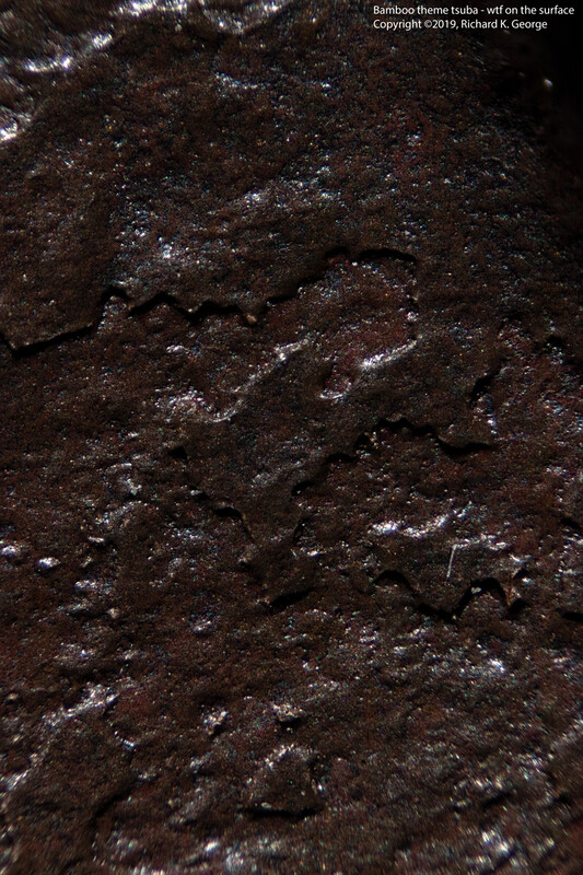

rkg Posted October 28, 2019 Report Posted October 28, 2019 Yup, got burned on one of those not too long ago, off of yahoo!Japan. I was super busy when it came in so I just glanced at it (it more or less matched the lowish-res images, and the surface didn't immediately strike me as having an issue)and put it on the shelf to study later - When I looked at it more carefully later, somebody had carefully crafted a surface using several layers of wax/other stuff that more or less looked OK in hand (maybe a little shiny which I attributed to wax), but when you looked at it under the microscope - YAAA!. The topper was that a pal sent me an image of a basically identical piece that was in Cary Condell's junk section at the SF show years ago - right down to most of the big nakago ana adjustments (they were supersets of each other - there were some large nakago ana adjustments that were common to both pieces, but each had their own too - like two pieces that were made the same way with some nakago ana adjustments got mounted on different swords)Anybody need an iai tsuba? :-/ Best, rkg (Richard George) I saw it on Yahoo!Japan. The number of decent looking moderns seems to have risen dramatically there. I wondered how long before they start flowing west. A while back I bought one that I thought might be a late Edo katchushi or the work of Kevin Adams. I knew he'd done one of this design. When it arrived- I went to 20th century or later. Pretty thing for display, but not antique. I suspected, but still the moderns have gotten better and more frequent on Yahoo!Japan. Quote

lotus Posted October 31, 2019 Author Report Posted October 31, 2019 Thanks for all the replies, I learned quite a bit from them. And Richard, just wow on the removal of that wax. That type of thing would be impossible to detect via pictures alone. Quote

rkg Posted November 16, 2019 Report Posted November 16, 2019 In case anybody's interested, I think maybe my er, iai tsuba presented above came from this guy (or somebody else doing this as a cursory glance through the many tsuba this seller offers didn't reveal my pattern): http://tsubaryuken.com/index.html Some of these look a little off, but you could strip a great many of them, remove the tacky modern sekigane, corrode them to create what people call "bold hammer work" (which is actually usually corrosion), and.... Its ready for Fleabay (or yahoo!Japan).... Be careful out there, rkg (Richard George) Quote
