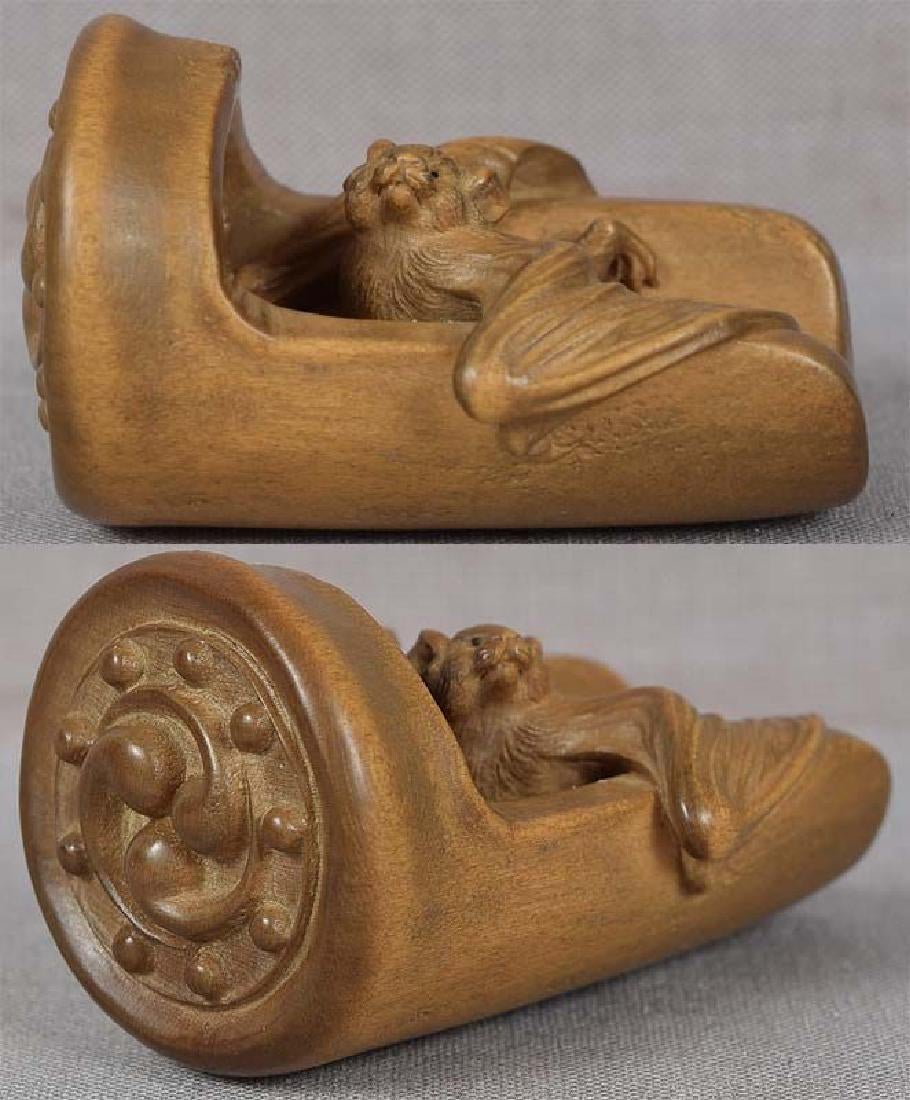

Tanto54 Posted October 24, 2019 Report Posted October 24, 2019 Thanks Curran - just got back from a great trip around Japan, and I think that I can add a little to the meaning of this motif. Ceramic roof tiles (karawa) were introduced to Japan along with Buddhism around the 6th Century, and they are often used symbolically in Japanese art. A single “discarded” tile is sometimes depicted with an animal - frog, bat, etc. symbolizing the transient nature of human life and nature's eventual conquest over man’s constructs. A jumble of tiles, like those on your fuchi, are probably intended to symbolize “gakai”, which is roughly translated as “tile release” and means something like the Western metaphor of “the weakest link in the chain” or “one falling domino knocks the others over”. “Gakai” is made up of the kanji for karawa (roof tile) followed by another kanji that means something like release. When one of these ceramic roof tiles fails and falls, it often causes the others to come crashing down domino style. This metaphor can be used as a Samurai/martial arts reminder to be well-rounded and not have any weaknesses. The specific kawara on your fuchi are called nokikawara (with the round end) and hidarisodekadokawara (curved with design on the edge). To be honest, the quality of your fuchi is not high enough to justify a lot of work (unless it has great personal meaning to you or your family). Therefore, many collectors might simply replace it with a better set of fuchigashira. Alternatively you could use a plain horn kashira (the approach used by many collectors) or try to find an orphan kashira with a matching theme made of similar or complementary metals and colors. Here's my favorite depiction of the kawara motif - a netsuke by Nishino Shoko of the So school. 1 Quote

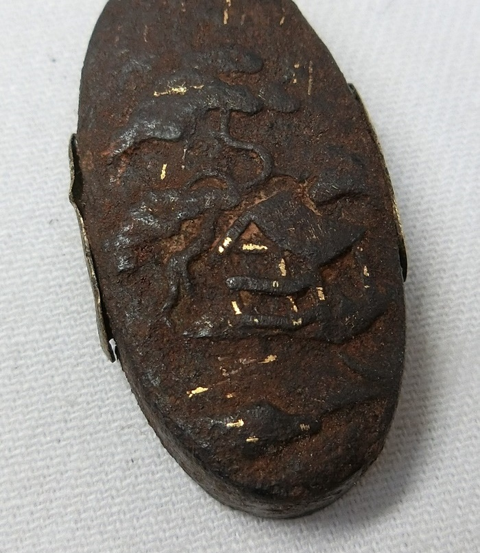

HyakkiHei Posted November 5, 2019 Author Report Posted November 5, 2019 Not having a lot of luck finding a matching kashira for the fuchi, but I did come across a fuchi and kashira set with a nice landscape theme that seem to fit with my tsuba, problem is that they're incredibly rusty, to the point where I'm not sure how I'd even get them in a presentable state. I'm not entirely sure how rough I could be with a fuchi and kashira in my endeavors to remove rust from them, because man is that a lot of rust. And no, I haven't bought em yet, because they do look incredibly weathered. Quote
ROKUJURO Posted November 5, 2019 Report Posted November 5, 2019 Yes, that seems to be beyond restoration indeed. Don't buy it! Quote

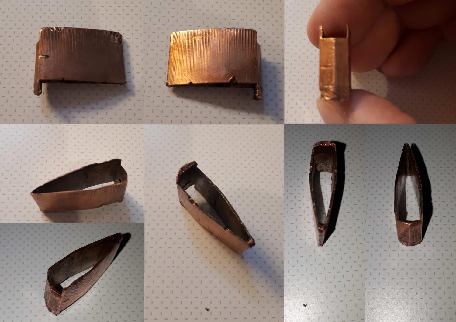

HyakkiHei Posted November 12, 2019 Author Report Posted November 12, 2019 I am loath to make a new thread when it's still about the same sword, so my apologies in advance for necro-ing this thread again. The habaki I posted earlier ( will post again for clarity ) was what I assume to be a typical two piece habaki, albeit very damaged, as the part towards the edge is missing that I see in all images of these types of habaki, and the second piece that slides over it is missing. I assumed that the lip at the mune side of the habaki must've been bent at some point, because in all the images I see of two piece habaki, the second part actually fits between that and the nakago. But no matter how I look at it, i can't seem to see any evidence that it has been bent out of place, as it's not visible on the inside. Are there different kinds of designs for two piece habaki that just work differently? It does nothing but confuse me. I'm inclined to think that this habaki survived the ordeal it was in before my grandfather found the sword, as it does fit the nakago like a glove, and whoever "restored" the sword previously didn't get anything else right, which just makes me all the more confused in what was supposed to be on it as the second piece of the habaki. Quote

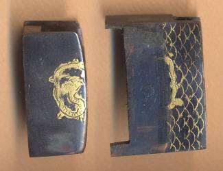

Tanto54 Posted November 12, 2019 Report Posted November 12, 2019 Dear Ludo, The piece of the "outer" habaki (missing in your case) that slips underneath that "lip" on the "inner" habaki is usually thin and I see a significant impact mark of the outside of the "lip" of your habaki (on the mune side) that would have bent it in slightly (enough to be tight against the mune of the sword). When I look at the picture it looks slightly bent in to me... In any event, you need a new habaki. It would probably be easier and cheaper to get an entirely new one, but, if you are determined to salvage the original pieces as much as possible, an expert could probably fix the part that you have and construct a new "outer" part. Just using the inner part alone will probably not allow the sword to fit securely in the saya or create a good seal against humidity. You've probably seen this picture of one like it, but here's how many of these two part habaki work. Quote

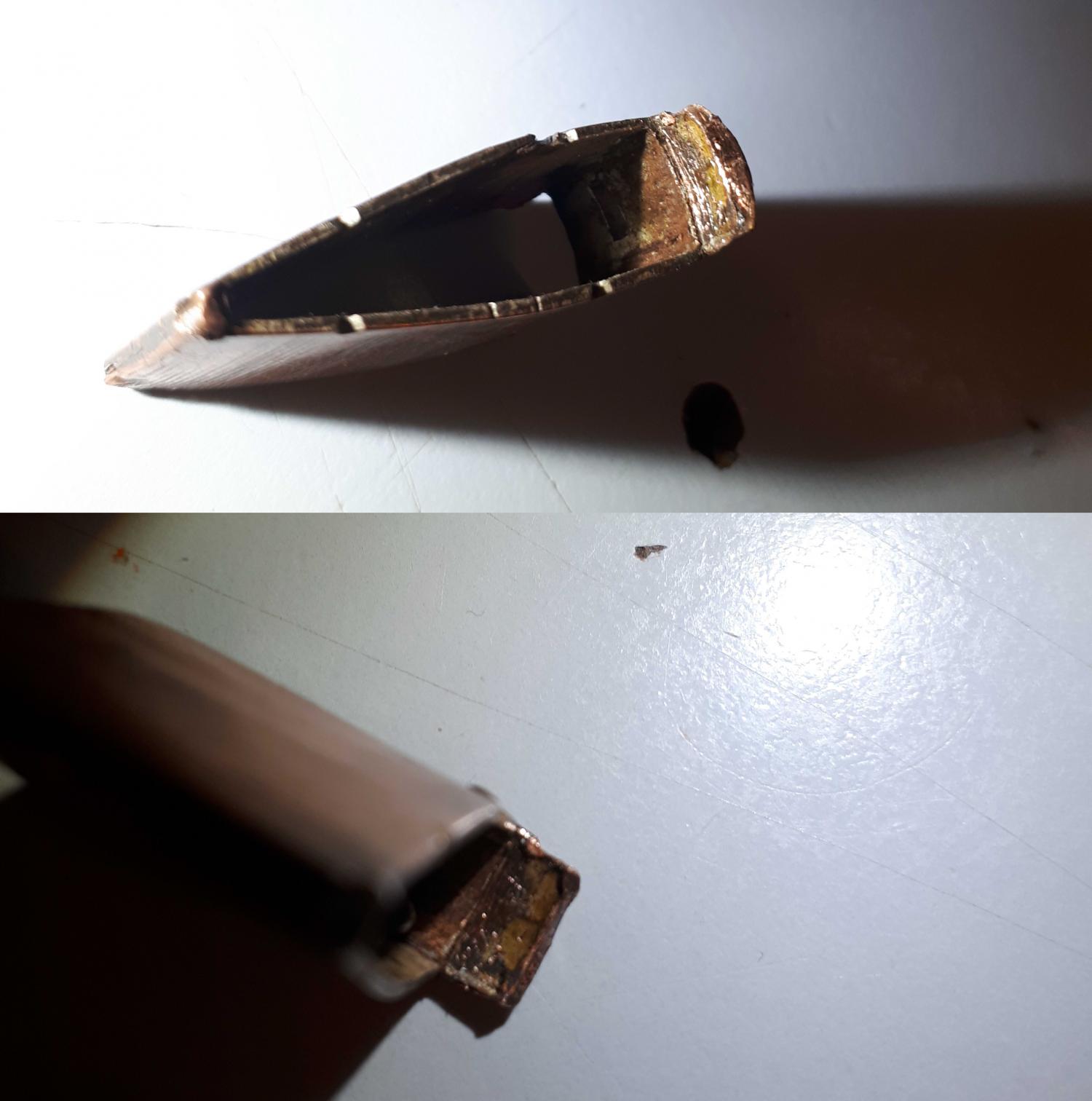

HyakkiHei Posted November 12, 2019 Author Report Posted November 12, 2019 Yeah, I've looked up a bunch of two piece habakis online, and that's how they all appear to be like. It's true that the lip is banged up, when I disassembled it, the guy who worked on it before had forced the fuchi OVER the lip, so I initially assumed it had been bent and crushed flat to the mune. But looking inside the habaki i can't really see any ridge having been there. Of course, like this it can't perform its function as a habaki, so I think I'll have little choice than to replace it then. Thanks for your insight, George. EDIT: Well, I just found out why it looked like it didn't have a ridge there spacing it from the blade, it's because there was like a 1mm thick layer of superglue in it, with the same color as the habaki, so it was hard to tell. Managed to scrape it away to reveal there's indeed a very small space inbetween there, but also that it's also quite damaged, material rolled over. At least this puts me at ease a bit, it was bugging me so much that I couldn't figure out how it was supposed to function if it wasn't like how two piece habakis are supposed to be. Quote
