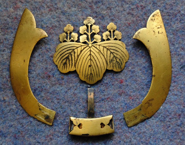

IanB Posted October 24, 2019 Report Posted October 24, 2019 Here are a few examples. The omodaka one may be heraldic. The kuwagata plus kirimon in gilded copper is ridiculous. It belongs to an armour by Nagamichi and is only about 4" across yet it takes to pieces. The third one had me puzzled for a while. I will let you guess. Ian Bottomley Quote

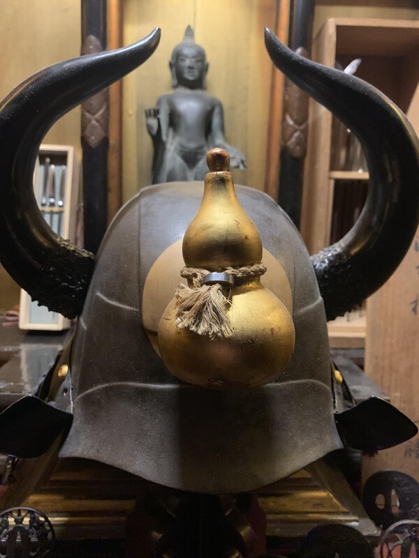

Chishiki Posted November 6, 2019 Report Posted November 6, 2019 Hi. Here is my personal favourite maedate. An Edo period sake gourd. If a maedate relects the personality of the wearer, this is my kind of man. Mark Quote
