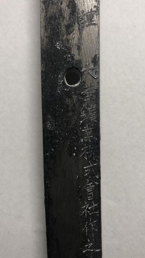

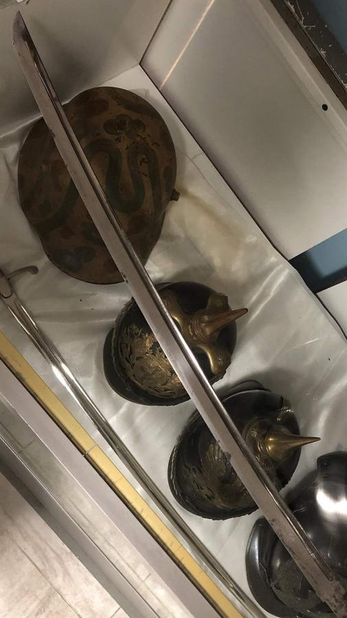

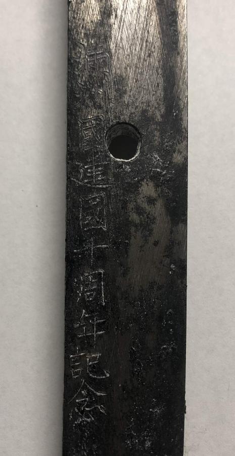

Beater Posted October 10, 2019 Report Posted October 10, 2019 I recently saw a sword blade on another forum which had a mei which was translated as follows: 謹大華鑛株式会社作之 Respectfully made at the Daika Ore Co. LTD 満州国建国十同年記念 10th anniversary of the foundation of Manshuko Manchuria was essentially a Japanese puppet state from 1932, so I'm assuming this dates to 1941/2. I believe it would not be wrong to refer to this as another type of Mantetsu-to, assuming the company named in the mei is indeed situated in Manchuria. It has a full length bo-hi and, from the photo, appears to be quite a long sword. The mei is neatly cut but the file marks on the nakago are quite crude in comparison. If you'd be interested in seeing the photos, link provided below. I am interested if anyone has encountered this producer before as it would seem to be evidence of more sword making in Manchuria. I hope you will find this of interest. http://www.wehrmacht-awards.com/forums/showthread.php?t=1019245 Quote
SteveM Posted October 10, 2019 Report Posted October 10, 2019 A couple of the kanji are wrong/missing 謹 大華鑛業株式会社作之 Daika Mining Co. (It might have a different name in English...I can't find an exact translation) 滿洲国建国十周年記念 Nitpicking, but sometimes tiny errors can cause search engines to go astray. In this case, even with the revised kanji I couldn't find many references to this company, and none which referred to sword-making. Assuming the inscription is legitimate (and I think it is) it may be one of a very limited production, or maybe even a sample. 1 Quote

k morita Posted October 11, 2019 Report Posted October 11, 2019 Hi, Please upload the blade and tang pics here. Quote
Bruce Pennington Posted October 11, 2019 Report Posted October 11, 2019 Guy, at Wehrmacht-Awards found this document that has something about the company: http://redirect.viglink.com/?format=go&jsonp=vglnk_157075997924715&key=371030782602e51f9316b570f87aa6a3&libId=k1lhwhus010009p9000MA1dc7j98y&loc=http%3A%2F%2Fwww.warrelics.eu%2Fforum%2Fshowpost.php&v=1&ref=http%3A%2F%2Fwww.warrelics.eu%2Fforum%2Fnewthread.php%3Fdo%3Dnewthread%26f%3D216&opt=true&out=https%3A%2F%2Frnavi.ndl.go.jp%2Fkensei%2Ftmp%2Findex_kashiwabarahyoutarou.pdf&title=Anyone%20heard%20of%20this%20Ore%20Company%3F&txt=https%3A%2F%2Frnavi.ndl.go.jp%2Fkensei%2Ftmp%2Fi...ahyoutarou.pdf Quote
Bruce Pennington Posted October 11, 2019 Report Posted October 11, 2019 On 10/11/2019 at 2:06 AM, k morita said: Hi, Please upload the blade and tang pics here. Quote
ChrisW Posted October 11, 2019 Report Posted October 11, 2019 A very handsome blade in my humble opinion, despite its wear. Quote
