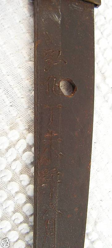

Just realised it's Kiyomaru. Should've known that before.
It wouldn't be the Kiyomaru would it?
It's dated on the ura by I can't decipher it:

DO you have any images of the whole blade?
From the mei's of Kiyomaru I've seen on the net, it seems that his signatures are not very consistant in style.
Here are some extra photos as requested. It seems to be remarkable similar to the Kiyomaru sold at samuraisword.com

Unless someone can give me a reason not to, I think this'll be another one I will be sending over to Japan for Shinsa.

It wasnt time wasting. And I am always nervous of things being labelled an obvious forgery (I think this is one though) These things are rarely black and white and need to be looked at and discussed, thats how we all learn.
Tell us how you reached that conclusion.

I reached the conclusion simply by looking at other examples, and making note of things such as chisel strokes, yasurimei, nakagojiri, etc. There are some things that look right such as the patina of the nakago and the hamon, but these are outweighed by the things that aren't in line with examples that are shoshin.
