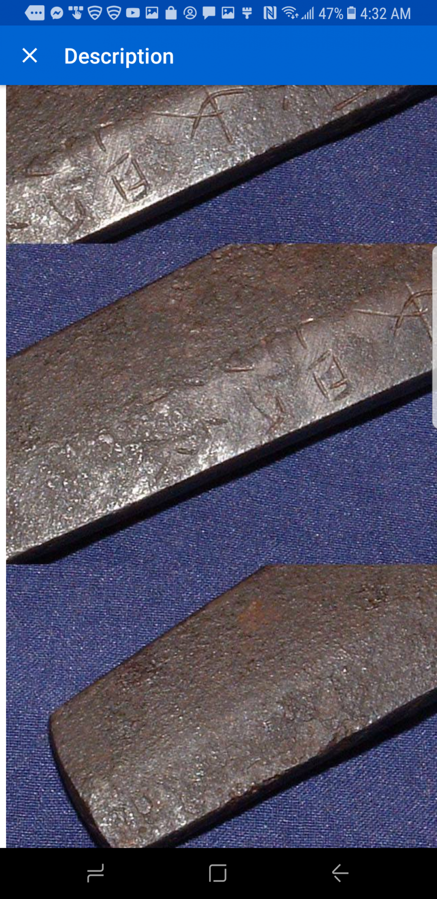

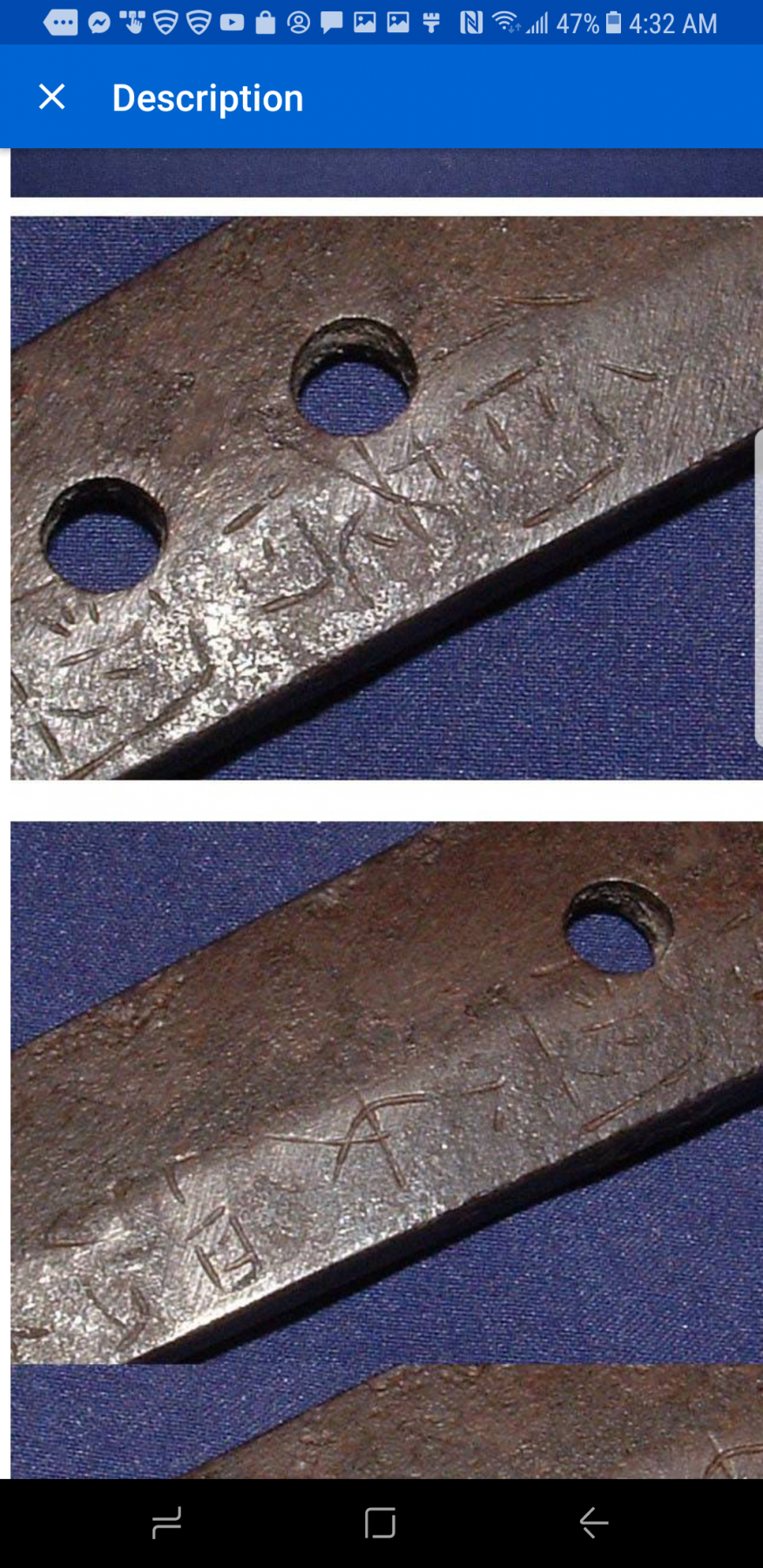

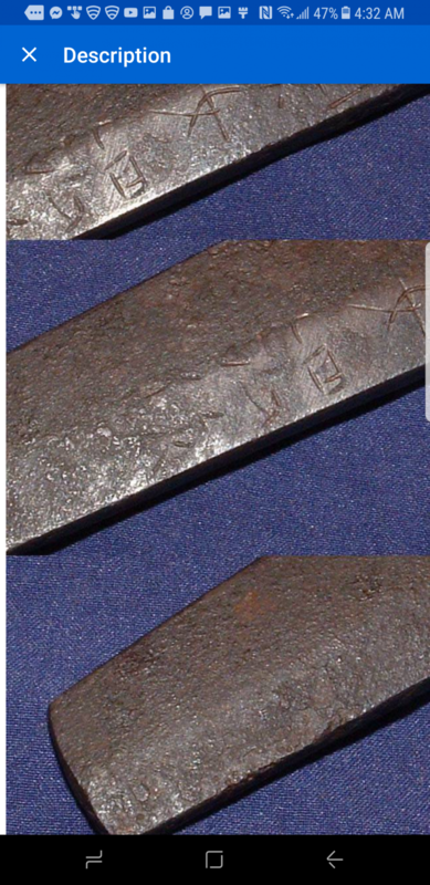

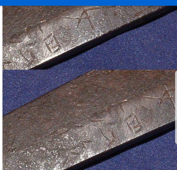

Yasutsuna did not sign this way, and the mei looks like nothing you would see in a Ko-Hoki blade.
Yura, generally speaking eBay is one of the worst places for a beginning collector to buy swords.
Ray,
Although we only have small snippets of the nakago for photos, this blade is katana-mei.  Ko-Hoki Yasutsuna of the Heian Period would have signed tachi-mei.  There are 9 signed mei-tachi that achieved juyo token prior to the end of 1999.  Two of those achieved Tokubetsu Juyo status.
There was however a Hoki Yasutsuna in the 1530’s that likely signed katana-mei but who knows.  Most records of Japanese sword history have been lost over the centuries; we are attempting to put together a jigsaw puzzle with the remaining pieces.
Agreed.  Bleach and eBay have the same effect on the eyes.
Robert
Robert, I was referring to the naga-mei. Yasutsuna signed niji-mei.
Regardless, this mei is closer to those from Changtian-swords that we have discussed here than anything from the purported time period.
I know Raymond just looking around was trying buy a good looking blade for cheap and came across one but the mei was faint so I asked everyone if they had seen anything remotely close to this. Where is a good place for beginners to look for blades I just like auction because sometimes you could get a good deal.
