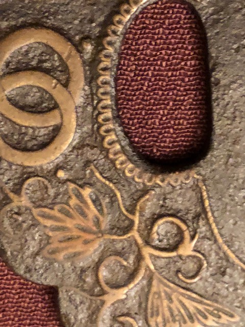

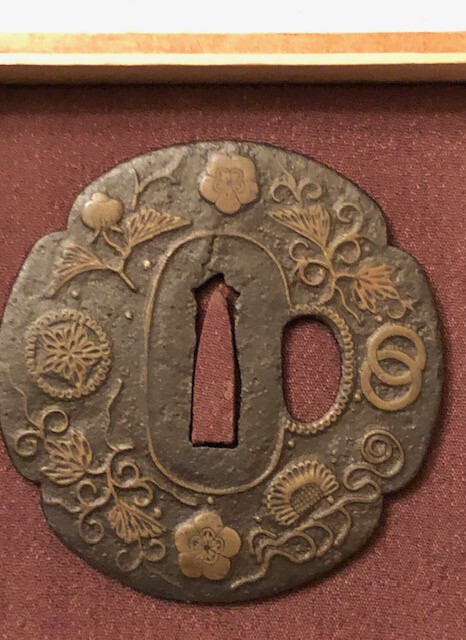

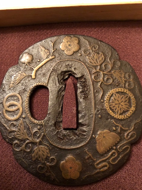

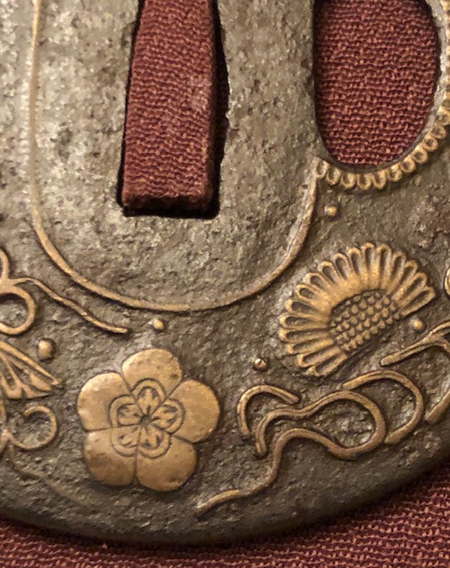

I just picked up this Fushimi-Yoshiro tsuba from an old collection. It looks to be in exceptional condition for something 400 plus years old, especially when these brass/copper inlaid tsubas tend to have a lot of missing inlaid metal typically. Your tsuba is nice, Bruno.

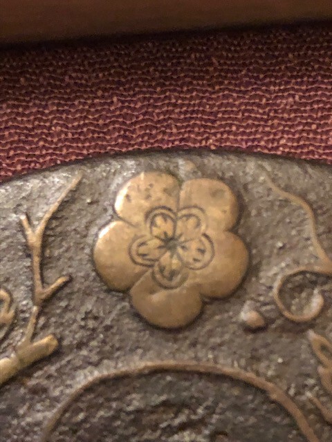

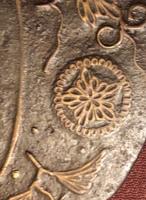

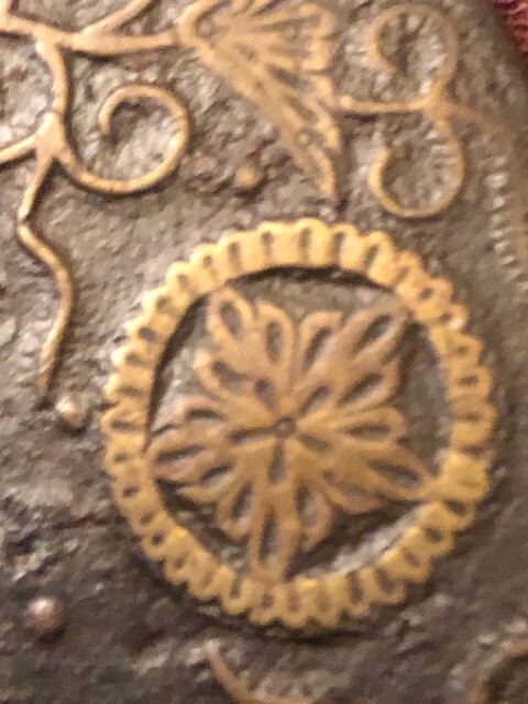

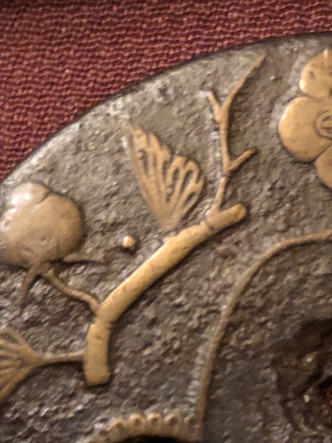

In my view the tsuba in the first post is a modern work.
The inlays and ryohitsu plugs are far too perfect in terms of surface texture. The iron shows absolutely no convincing signs of age or any tell tale signs of it being anything other then modern mild steel. the hammer marks around the nakago ana are an utterly unconvincing attempt to make it look like it been around a bit, totally at odds with the tidiness of the inlays for example. And the iron patina is super thin with no signs of any rust build up around the inlays.
I think the inlay and plugs are all the same material, brass. I'd bet the zinc analysis would come back at around 37%  :)
