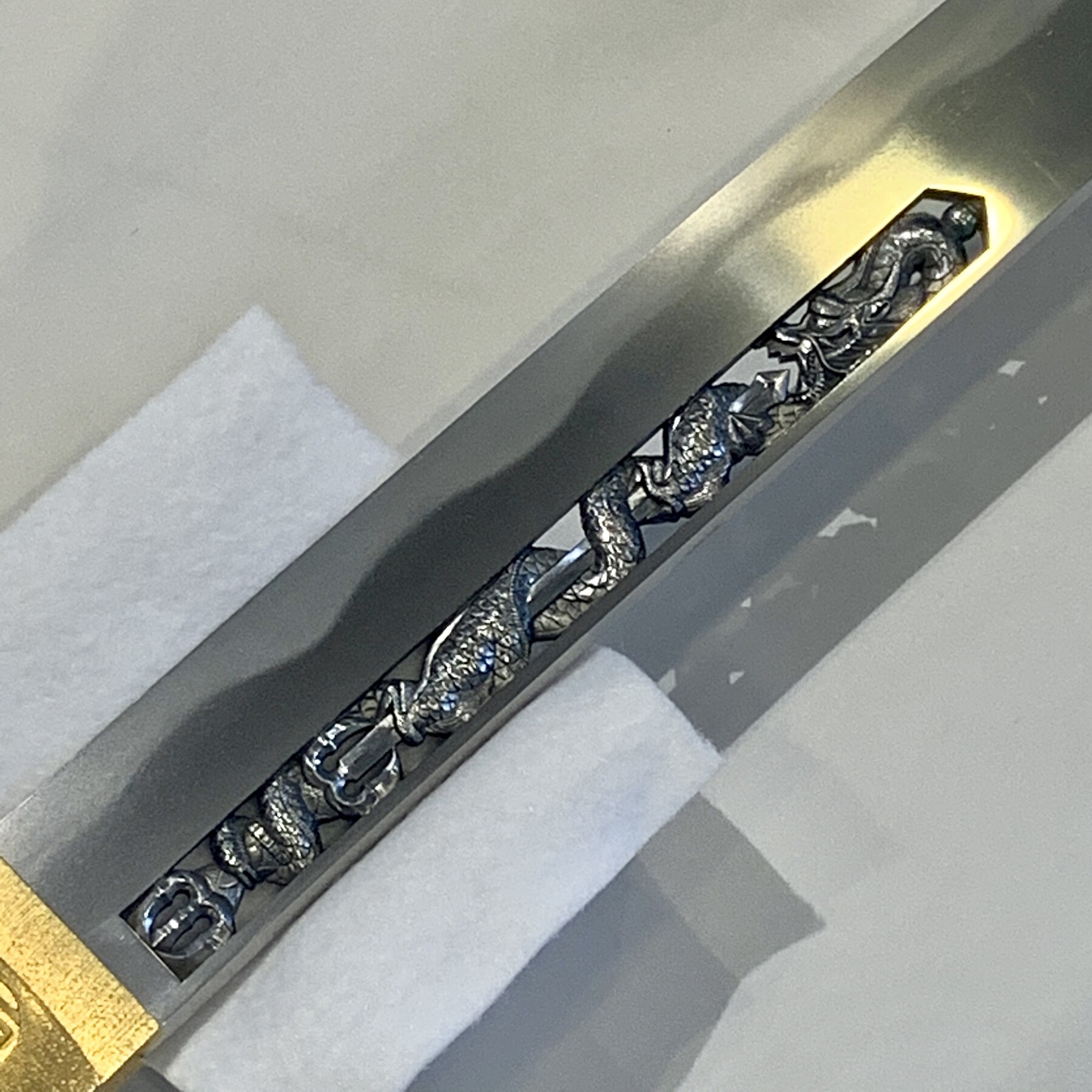

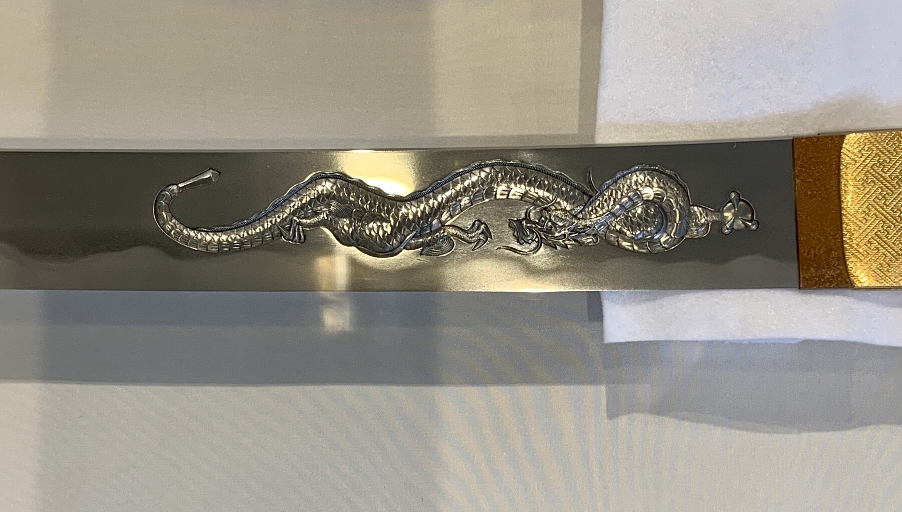

Bugyotsuji Posted October 3, 2020 Report Posted October 3, 2020 Saw two wakizashi blades today side by side, one with a horimono by Senju Sensei and one by the son, Soju Sensei. 2 Quote
Ken-Hawaii Posted October 4, 2020 Report Posted October 4, 2020 The top one is quite nice, Piers. Quote
Bugyotsuji Posted October 4, 2020 Report Posted October 4, 2020 A perfect sukashi! And it’s 3D, not the same on either side. Quote
