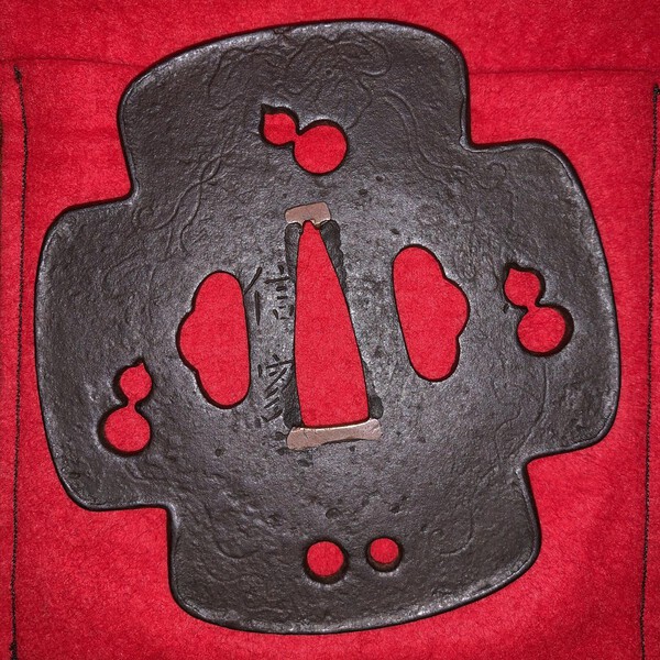

Definitely not THE Nobuie, but what do you think?
Picked this up today. Obviously not capital-N Nobuie, but I’d be curious to know what some of our resident tosogu experts make of it. The iron is nice. Not very thick. But I always enjoy Satsuma-ana and it has a little wabi-sabi going on with the asymmetric sukashi...
And while pondering - that lovely, textured, granular look to the surface is - what???  Minute hard inclusions in the body due to ??, ummm - sand casting marks??
Musing BaZZa
(who-really-doesn't-know-much-about-tosogu-except-what-he-likes...)
This kind of matte surface is probably caused by pickling/etching, a normal finishing process. All features speak for a nicely and competently handcrafted item, but indeed it lacks the vivid expression of some older TSUBA in NOBUIE style.
I like it and I think it is a good find!
Musing BaZZa
Oh, pickling is the answer then.  I didn't mean to be casting (pun intended) aspersions upon Michael's tsuba as I do like it a lot and would have it.  I was curious about the nature of the surface, so thank you Jean C.  Could I further speculate that the surface appearance mirrors the internal structure of the forged iron??  Micro-tekkotsu, as it were!
BaZZa.

.....Could I further speculate that the surface appearance mirrors the internal structure of the forged iron??  Micro-tekkotsu, as it were!
BaZZa.
Barry,
in principle, yes, but it seems that we have here a well homogenized iron, so the patination process does not reveal a crystalline or other structure as we might see in MOKUME TSUBA. The nature of TEKKOTSU is perhaps not what we are thinking it might be - I am working on that. TSUBA are not hardened like sword blades  and thus we should not expect Martensite particles to protrude from the surface.

.....The plate does exhibit this very nice gradual and uniform thinning from the rim in towards the center, which I imagine was not easy to do.)
Michael,
while good iron TSUBA are indeed not so easy to make, as design and craftsmanship have to be on a high level, giving the plate an even or tapering thickness is not so difficult!
Michael,
Fair point! Still impressed me though. My excuse is that I’m primarily a blade person. ;-)
