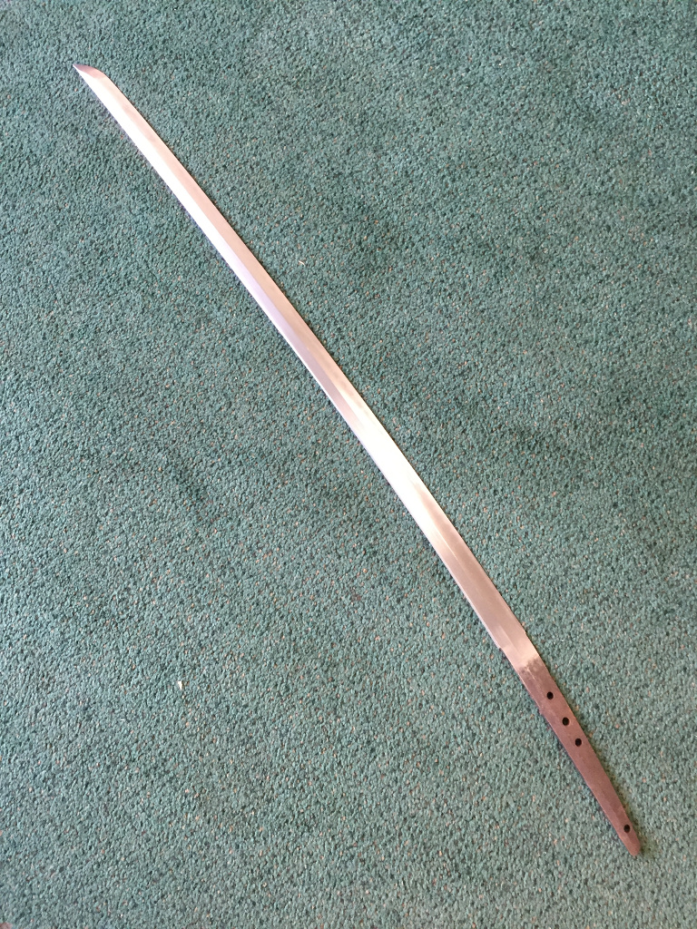

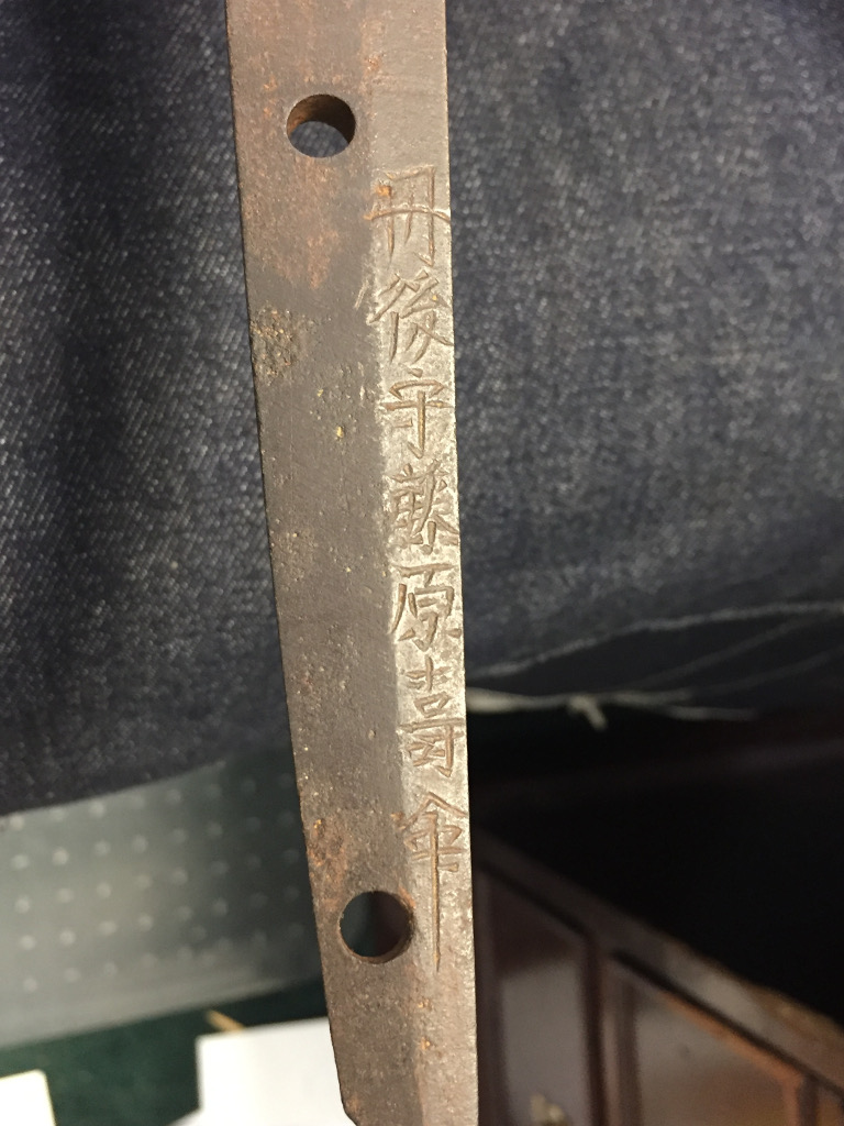

tbonesullivan Posted September 4, 2019 Report Posted September 4, 2019 Just had a chance to examine this sword, and it definitely does look nice. Though, the polish is definitely not what it used to be. It looks like it does have a very active Hamon, and having dealt mostly with wartime production, it's nice to see an older blade. Though question is always, would it be worth it to get it a better polish. I'm fairly certain regarding the mei, after comparing it to this example: http://nihontocraft.com/Tango_no_Kami_Jumyo_Katana.htm . It also has a similar habaki. Looks like somewhere along the line one of the SEPPA for the Shin-Gunto KOSHIRAE went missing, as the TSUBA is loose, but the TSUKA fits quite nicely. Just thought I'd share, and maybe get some thoughts. The Hamon is faint, but almost looks like a YAHAZA "Notched" shape. Quote
Ken-Hawaii Posted September 7, 2019 Report Posted September 7, 2019 Definitely has a hamon, but can't see any hada. Please don't buy a blade based on a non-papered mei, as a very-high percentage of blade are gimei. What specific questions do you have? Quote
hxv Posted September 7, 2019 Report Posted September 7, 2019 In the 2nd picture from the left, is it a rust spot or an opening? If you decide to polish it, you will need to have new shirasaya made as well. If it were my sword, I would enjoy it as is. The polish seems to be good enough to see activities. Hoanh 2 Quote

tbonesullivan Posted September 9, 2019 Author Report Posted September 9, 2019 In the 2nd picture from the left, is it a rust spot or an opening? If you decide to polish it, you will need to have new shirasaya made as well. If it were my sword, I would enjoy it as is. The polish seems to be good enough to see activities. Hoanh It's gotta be dirt or something from the floor. I don't see it on the blade now. I do have to admit that the mei is quite clear for the age. It's a strange blade, as I can see the remains of what look like rust pitting in place. The current polish looks like a standard Shin-Gunto polish. The SHINOGI-JI and MUNE were never burnished, like you'd usually see. Did out of polish blades ever get set in Shin-Gunto mounts after getting a "basic" polish? Quote
