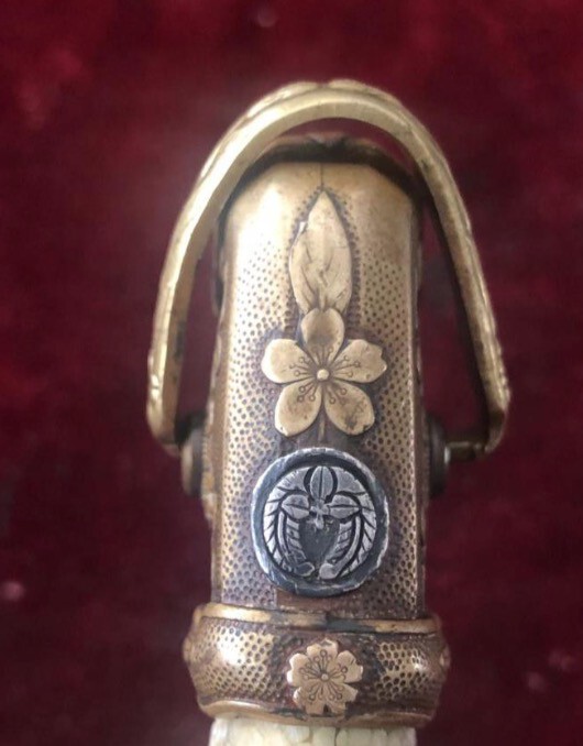

Guest Posted January 13, 2020 Report Posted January 13, 2020 Good afternoon Stegel, it is called Maru Ni Watanabe Boshi The Watanabe basic form is this It is said by some to represent three rice balls on a plate, but also is sometimes referred to as a working on three stars which also may refer to the worship of the constellation of Orion (See thread on page 4). (Also Watanabe is one of the most popular family names in Japan). 1 Quote

Stegel Posted March 9, 2020 Report Posted March 9, 2020 Good afternoon Stegel, it is called Maru Ni Watanabe Boshi The Watanabe basic form is this It is said by some to represent three rice balls on a plate, but also is sometimes referred to as a working on three stars which also may refer to the worship of the constellation of Orion (See thread on page 4). (Also Watanabe is one of the most popular family names in Japan). Thank you very much Malcom!! Very interesting!! Quote
Bugyotsuji Posted March 9, 2020 Report Posted March 9, 2020 Sakura flower and leaf (or oak leaf), and 下り藤に木 Sagari Fuji ni Ki, suggesting a joining of families? 1 Quote
Guest Posted March 9, 2020 Report Posted March 9, 2020 Piers, the Yamato Zakura and leaves is the standard decoration for a Gunto Kabuto - gane and does not relate to the Silver set Kamon which is an addition by the original owner. http://ohmura-study.net/905.html I get hanging Paulownia Imperialis as the main theme, Sagari Ni Fuji, but is the detail at the lower end of the central stalk a kanji character like 木 rendered in Tensho script? See Sagari Ni Fuji Gosan Kiri, with Gosan Kiri in the position of what I reckon is 木 Sort of like this only more cursive? 1 Quote
Bugyotsuji Posted March 9, 2020 Report Posted March 9, 2020 https://www.google.com/search?q=%E6%9C%A8%E5%AE%B6%E7%B4%8B&oq=%E6%9C%A8%E5%AE%B6%E7%B4%8B&aqs=chrome..69i57.8111j0j9&sourceid=chrome&ie=UTF-8 Bonne journee Malcolm. Sagari Fuji ni........... 1 Quote
Guest Posted March 9, 2020 Report Posted March 9, 2020 Cheers Piers, I'm on it now!! So, it looks like 木 , the character for Wood, rendered in Tensho script, which can be read as Ki or Moku. So, I'm going to call Sagari Fuji Ni Moku No Ji. And, knowing my fondness for all things Talismanic, Wood is the first of the five elements: https://en.wikipedia.org/wiki/Wuxing_(Chinese_philosophy) 2 Quote

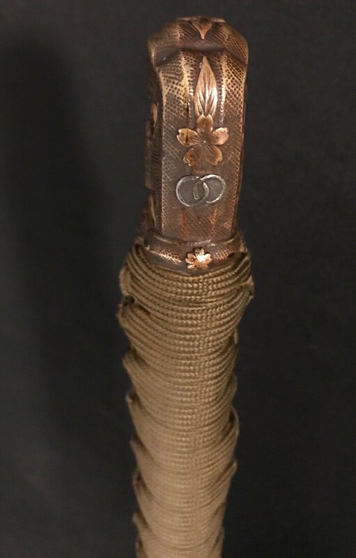

Jason_D Posted March 10, 2020 Report Posted March 10, 2020 What do you know of this one? Thank you. Quote
BANGBANGSAN Posted March 10, 2020 Report Posted March 10, 2020 藤紋 日本の公家を代表する藤原家および全国に散らばった藤原一族末裔の家紋として広まった。公家の頂点摂関家の九條家、二條家、一條家が藤紋を掲げている。 藤原 Fujiwara Family crest What do you know of this one? IMG_2411.jpg Thank you. 1 Quote
Jason_D Posted March 10, 2020 Report Posted March 10, 2020 Amazing thread guys and ladies , keep posting Very educative... Quote
Guest Posted March 10, 2020 Report Posted March 10, 2020 Hi Jason, Looks like Maru Ni Sagari Ni Fuji - Hanging Wisteria within a circle. 1 Quote
Jason_D Posted March 10, 2020 Report Posted March 10, 2020 Hi Jason, Looks like Maru Ni Sagari Ni Fuji - Hanging Wisteria within a circle. Perfect , thank you Malcolm! 1 Quote

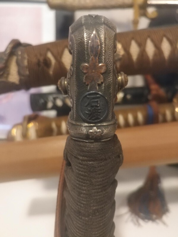

PNSSHOGUN Posted April 5, 2020 Report Posted April 5, 2020 Thank you Steve, I managed to find a Lieutenant Colonel Heizo Ishiwatari in this essay regarding the Kwangtung army and the operational planning for action in Manchuria: http://www.ibiblio.org/hyperwar/Japan/Monos/pdfs/JM-77_Preparations4Manchuria%3C1943/JM-77.htm Seems like an uncommon enough name, obviously without access to the IJA records it is extremely difficult to march records to names. Quote
Guest Posted April 5, 2020 Report Posted April 5, 2020 Some time ago, I had to research Naval Officers aboard HIMS Katori during the early 20th Century. http://www.militaria.co.za/nmb/topic/10581-hims-katori-officer-list/ I found this site to have some extraordinary references to serving naval ranks and names. I believe it may also have similar for the Army, but I have not gone into it in depth: http://cb1100f.b10.coreserver.jp/ Turn your volume control down as music will appear from nowhere, and also do not right click. 1 Quote
SteveM Posted April 5, 2020 Report Posted April 5, 2020 I use the following site to get information on last names. It gives me a general idea of how common or how rare a last name may be. For instance, Ishiwatari is a name made of very common kanji, and to me it has the ring of a name that is fairly prevalent in Japan, but when I check on this site I find out that only about 621 people have this last name in Japan, and that it is found mostly in Kanagawa prefecture. Also, other possible pronunciations include Ishiwata, Ishido, Ishito, and Ishiwataru. I would have thought it to be much more common. https://myoji-yurai.net/searchResult.htm?myojiKanji=%E7%9F%B3%E6%B8%A1 5 Quote

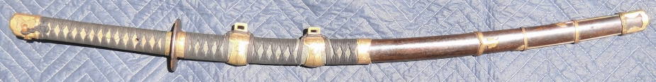

PNSSHOGUN Posted May 23, 2020 Report Posted May 23, 2020 Waiting on this one to arrive, a Mon I haven't seen on a sword before: 1 Quote
