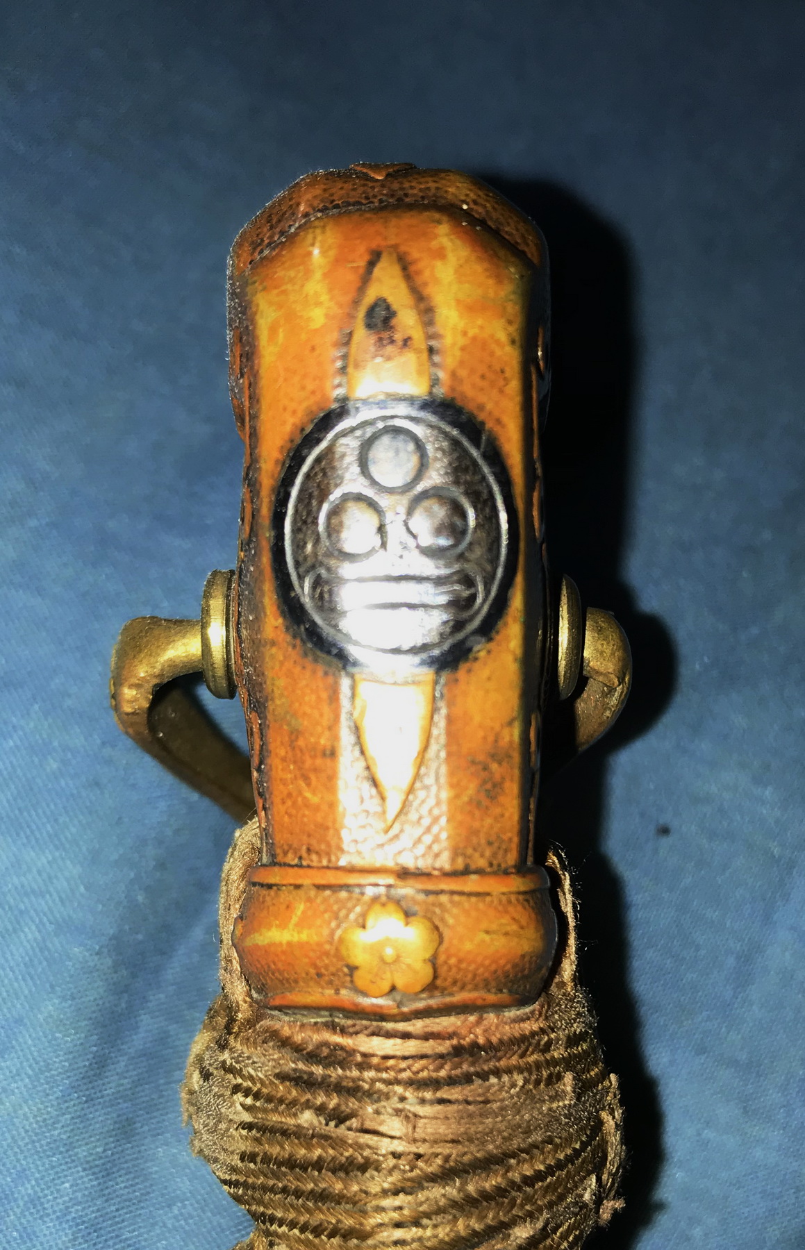

Guest Posted October 23, 2019 Report Share Posted October 23, 2019 Thank you Uwe and Steve M. Hi Steve, the menuki in JP's image are the standard Kaigunto pattern of Maru Ni Yamato Zakura with the addition of the central Kamon in Silver. The Gunto Menuki which you illustrated (http://www.jp-milita...viphtml/70.html) are slightly different, being without the circle, I think called Yae Yamato Zakura (Cherry Blossom with stamens and petals.beneath) See Ohmura: http://ohmura-study.net/905.html Quote Link to comment Share on other sites More sharing options...

Guest Posted October 23, 2019 Report Share Posted October 23, 2019 Hi Guys, Thank you JP, looking closely, I still reckon that the Leaves at 12o'clock are Tsuta, as there is a central dot from which the veins extend. Quote Link to comment Share on other sites More sharing options...

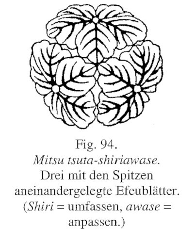

uwe Posted October 23, 2019 Report Share Posted October 23, 2019 FYI, 1 Quote Link to comment Share on other sites More sharing options...
16k Posted October 23, 2019 Report Share Posted October 23, 2019 Yup! Seems to be the one! Thank you guys! Quote Link to comment Share on other sites More sharing options...
Guest Posted October 23, 2019 Report Share Posted October 23, 2019 Uwe, I think you have it!! Mitsu Tsuta Shiriawase it is. Well done. 1 Quote Link to comment Share on other sites More sharing options...

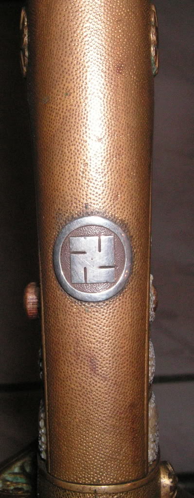

Bruce Pennington Posted November 10, 2019 Report Share Posted November 10, 2019 Well known, and oft talked about, found on a kyu backstrap: 1 Quote Link to comment Share on other sites More sharing options...
Guest Posted November 11, 2019 Report Share Posted November 11, 2019 Hi Bruce, it's called Maru Ni Hachisuka Manji (Becase the lines of the Swastika are quite thick, if they were thinner, i.e larger spaced, in same angle, then it would be Maru Ni Itsutsuwari Manji. 1 Quote Link to comment Share on other sites More sharing options...
Bugyotsuji Posted November 11, 2019 Report Share Posted November 11, 2019 I have a Kagami Maedate with that Hachisuka Mon, the same thick tomo-e manji. Interestingly, if you visit Tokushima Castle Museum, you will see many examples of a reversed Manji too, because as they explained to me, one branch of the family wanted to distinguish their own line from the main one. 1 Quote Link to comment Share on other sites More sharing options...

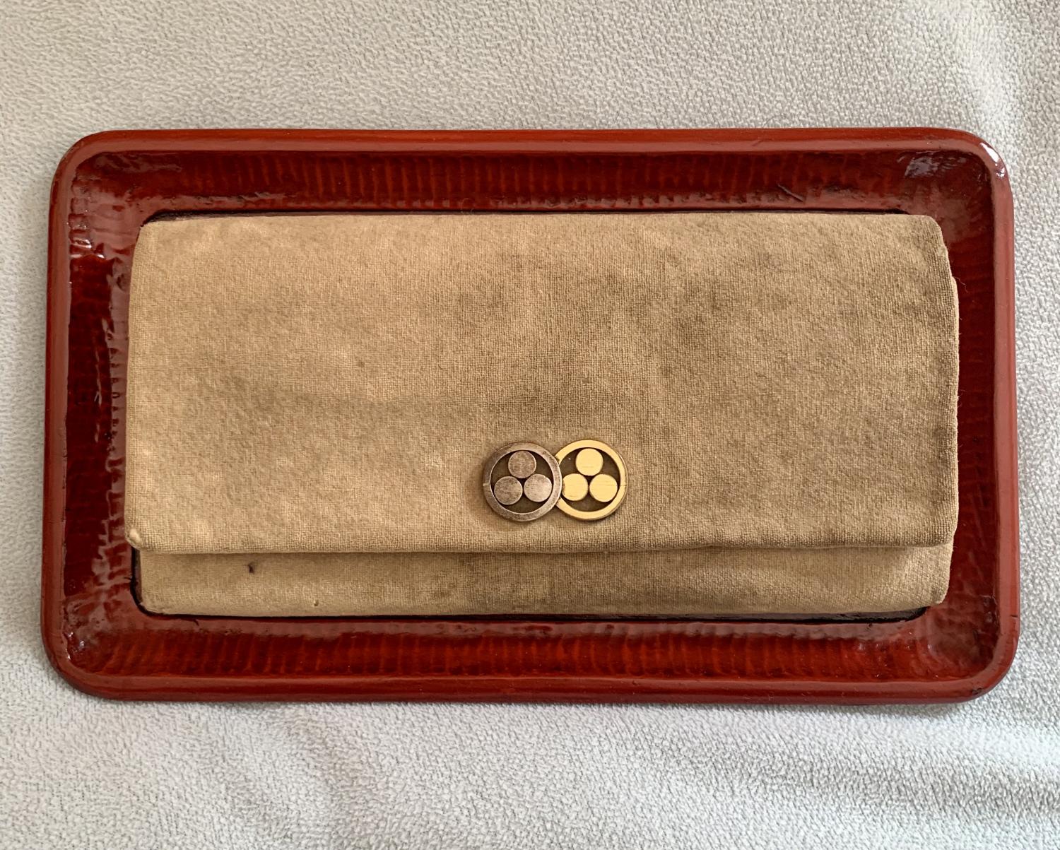

Bugyotsuji Posted November 27, 2019 Report Share Posted November 27, 2019 The original three-star or three-dango Mon had no circle but at some point it was added. Towards the end of Edo in the confusion of the Bakumatsu, many families claimed Samurai status, and after the beginning of Meiji it must have been a free-for-all. Here is a billfold or wallet with the same Mon. 3 Quote Link to comment Share on other sites More sharing options...

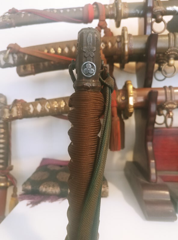

PNSSHOGUN Posted December 28, 2019 Report Share Posted December 28, 2019 Can't remember if this one was covered yet, always fascinated by your background info on these regardless. Quote Link to comment Share on other sites More sharing options...
Bugyotsuji Posted December 28, 2019 Report Share Posted December 28, 2019 Hi John, that one (Makino) came up yesterday on one of the threads. Quote Link to comment Share on other sites More sharing options...
Guest Posted December 28, 2019 Report Share Posted December 28, 2019 Maru Ni Maki No Kashiwa, or Maruni Mitsu Gashiwa..........??!! The clue is in the post from yesterday which Piers mentions. http://www.militaria.co.za/nmb/topic/30678-need-help-identifying-the-maker-of-this-katana/ Quote Link to comment Share on other sites More sharing options...
PNSSHOGUN Posted December 28, 2019 Report Share Posted December 28, 2019 Found it, thank you. Very interesting, the sword is a nice one with Shin Shinto blade and fine quality mountings. The Habaki almost looks like Shakudo and the oversize Seppa are either silver or silver plated. Quote Link to comment Share on other sites More sharing options...
