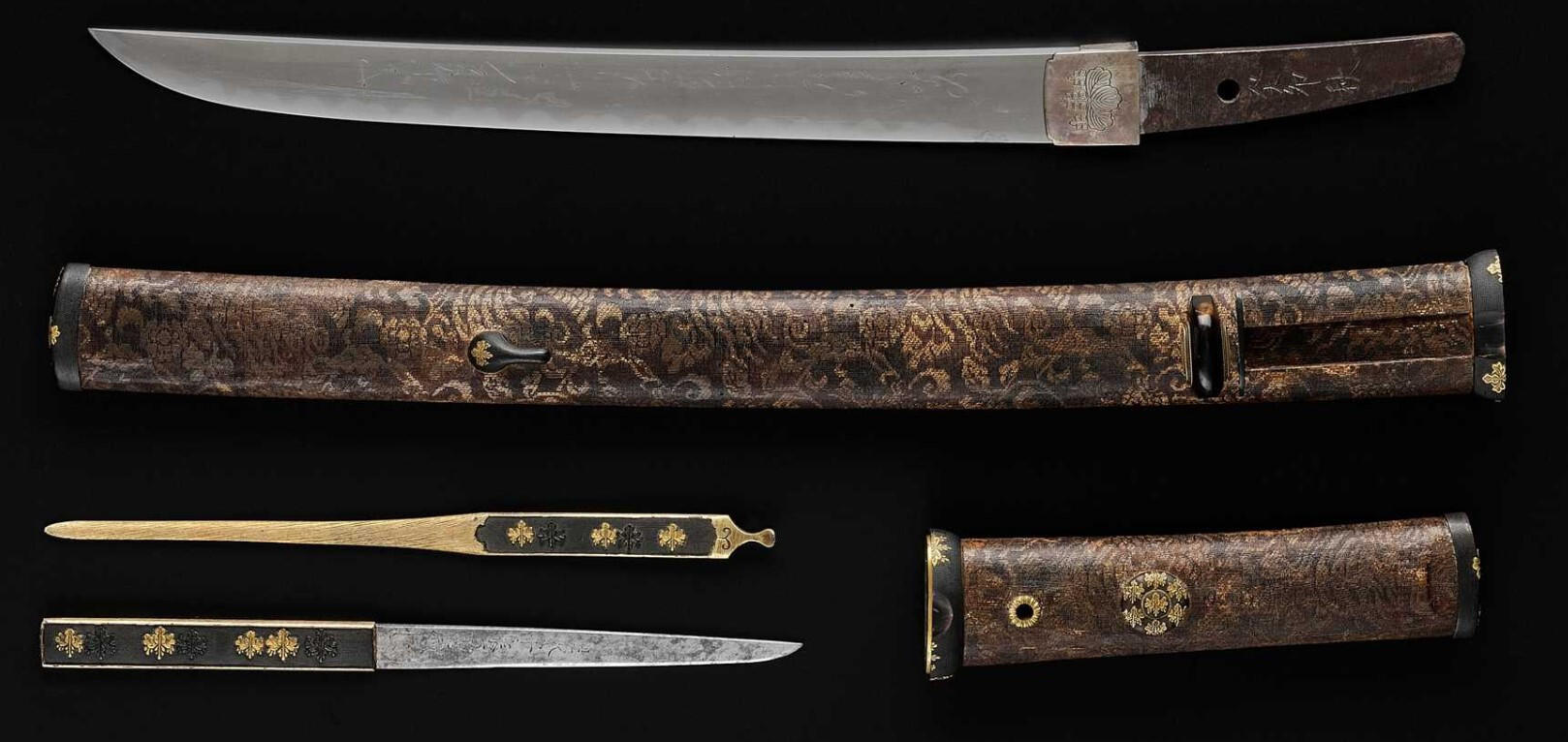

Bruce Pennington Posted November 7, 2021 Report Posted November 7, 2021 Found this on an auction posted by John, @Shugyosha, HERE. The tanto is made for Tomoo, in 1843. The seller speculates that it was "Nagasawa Tomoo 長澤伴雄 (1808-1859) who was a scholar of Japanese classical literature and Waka poetry. He was a Samurai at the Kii Domain, Wakayama. He compiled multi-volume Waka poetry collections. It is likely that the long poems inscribed on both sides of the blade are by him." It has the Kiri mon on one side and the Kikyo mon on the other. Just wondering why there would be 2 mon for 1 owner. Ideas? Quote
b.hennick Posted November 7, 2021 Report Posted November 7, 2021 Husband's family and wife's family wedding present? 2 Quote
SteveM Posted November 8, 2021 Report Posted November 8, 2021 The above is a strong possibility. Or, one crest could be the fief crest, and the other is the personal crest of the owner. The 5-7-5 Paulownia crest became the crest of the government sometime in Meiji, so it could represent a connection to the government or imperial family. 5 Quote

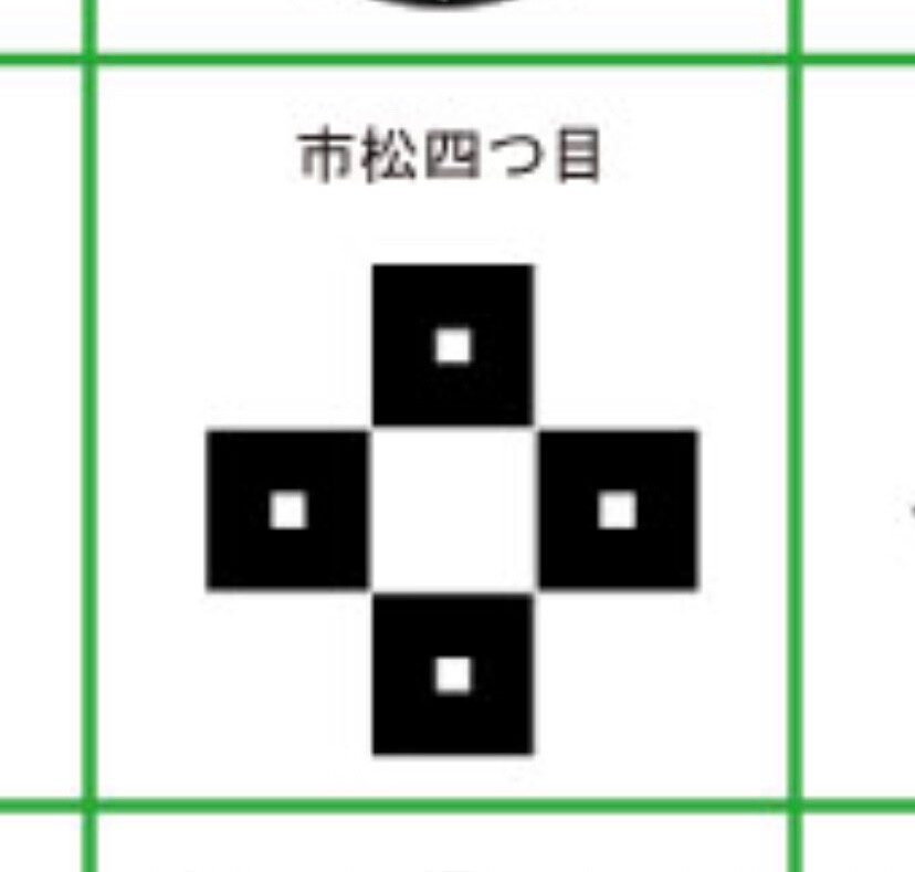

Bruce Pennington Posted December 7, 2021 Report Posted December 7, 2021 An unusual one (to me anyway). Found by @PNSSHOGUN at this Yahoo auction. Quote
Bugyotsuji Posted December 7, 2021 Report Posted December 7, 2021 Bruce, try Ichimatsu Yotsumé. http://cts2.web.fc2.com/meyui.html 1 Quote

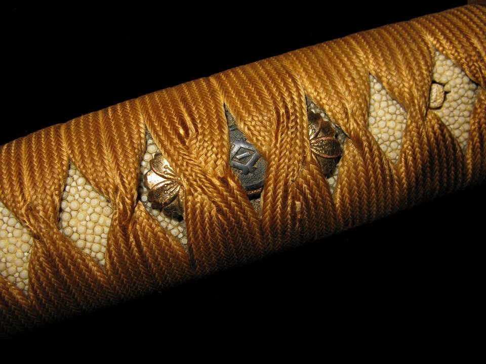

PNSSHOGUN Posted December 7, 2021 Report Posted December 7, 2021 It is very unusual for a Mon to be mounted on a Type 3/Rinji model. Quote
