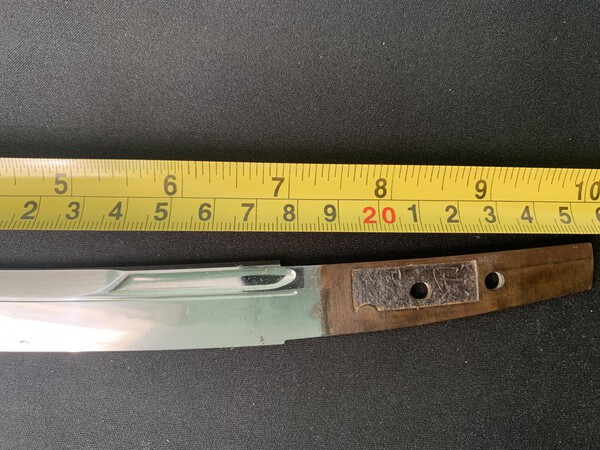

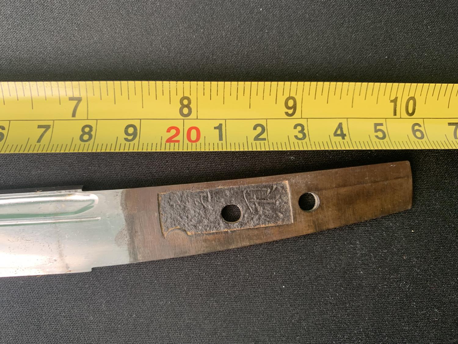

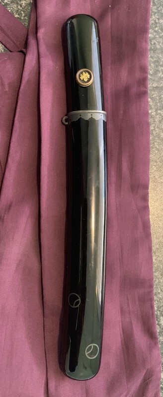

Chishiki Posted August 22, 2019 Report Posted August 22, 2019 This Tanto just arrived and I am away from my books. I bought it without seeing the Nakago so was surprised to see an old mei inserted into a shinsakuto. I see the hear showa 30 Blade length is about 7”. Does anyone know of this maker? Thanks in advance. Mark 1 Quote

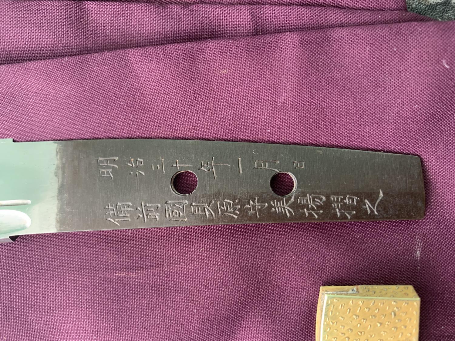

Tom Darling Posted August 22, 2019 Report Posted August 22, 2019 Meiji date, and a Kunisada did something?????? Guessing Nobukuni? from my old eyes, probably wrong, although interesting. Peace. Tom D. 1 Quote
Chishiki Posted August 22, 2019 Author Report Posted August 22, 2019 Thanks gents, amened to meiji 30. I am trying to work out the old mei. Nobukuni is a possibility. Please keep the info coming. The kanji on the nakago are very small and neatly done. It looks like it has been darkened up to look older. It is a small tanto mounted as kwaiken. I will add some pics. Thanks again, much appreciated. Mark Quote
EdWolf Posted August 22, 2019 Report Posted August 22, 2019 Mark, The mei starts with: 備前 Bishu國貞 Kunisada 1 Quote

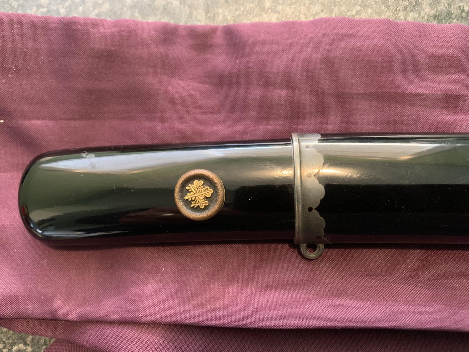

Chishiki Posted August 22, 2019 Author Report Posted August 22, 2019 Photos of the mount. Mark 2 Quote

ROKUJURO Posted August 22, 2019 Report Posted August 22, 2019 David,I am waiting also for the experts to chime in. Like Ed, I think I can read BIZEN KUNISADA MINAMOTO no KAMI.......This is probably the master who formed the new NAKAGO in MEIJI JIDAI. The blade is perhaps the front part of a broken NAGINATA or NAGAMAKI, if I consider the strong SORI, and the maker of the original blade could have been a SADAKUNI (difficult for me to read the first KANJI). The MEI had been removed from the old NAKAGO and carefully inserted into the new NAKAGO (GAKU-MEI). That is what we believe, but of course there is no guarantee of authenticity unless a SHINSA panel confirms it.The new NAKAGO looks artificially aged/patinated to me. 1 Quote
Ray Singer Posted August 22, 2019 Report Posted August 22, 2019 I don't think that the reading is Bizen Kunisada. 備前國見原守美揚摺之. Perhaps, Bizen (no) kuni ___ 1 Quote
Nobody Posted August 22, 2019 Report Posted August 22, 2019 明治三十年一月日 – Meiji 30th year (1897), 1st month 備前國貝原守美揚摺之 – Bizen no kuni, Kaibara Moriyoshi shortened this. I am not sure about the Gakumei on the other side. That might be Nobukane (信兼 ?). 9 Quote
Ray Singer Posted August 22, 2019 Report Posted August 22, 2019 I have been struggling with the gakumei as well. I had dismissed the first kanji as being something other than Nobu, but 信兼 makes more sense than anything else I can determine at this point. 1 Quote

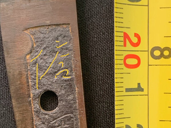

uwe Posted August 22, 2019 Report Posted August 22, 2019 First character looks a bit more “佑” to me. But who knows.....? 2 Quote
Chishiki Posted August 23, 2019 Author Report Posted August 23, 2019 Thanks for your help. Here are the specific measurements. What the pics don’t show is how small this tanto is. It must have always been a tanto. What so you think? Thanks again. Nagasa 17.5cm Motohaba 2.1cm Kasane 3.4mm Quote
Chishiki Posted August 23, 2019 Author Report Posted August 23, 2019 Does this kanji outline make sense? Brian, sorry about tsking up space. Once the thread is done you can delete whst you want. Thanks. 1 Quote

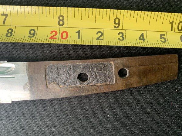

Chishiki Posted August 23, 2019 Author Report Posted August 23, 2019 On 8/22/2019 at 3:48 PM, Nobody said: 明治三十年一月日 – Meiji 30th year (1897), 1st month 備前國貝原守美揚摺之 – Bizen no kuni, Kaibara Moriyoshi shortened this. I am not sure about the Gakumei on the other side. That might be Nobukane (信兼 ?). Thank you Moriyama San, i have added more photos of the old mei. I hope someone can help. Thanks Quote

Chishiki Posted August 27, 2019 Author Report Posted August 27, 2019 This has always been a small tanto, too small to have been anything else. It is a nice shape as you can see and is a well made blade without kizu and very good hamon. Maybe shortened to be mounted as a wedding gift. The koshirae whilst plain is very niceley made. I still haven’s worked out the old mei, I will try to get some better pics. Mark Quote
