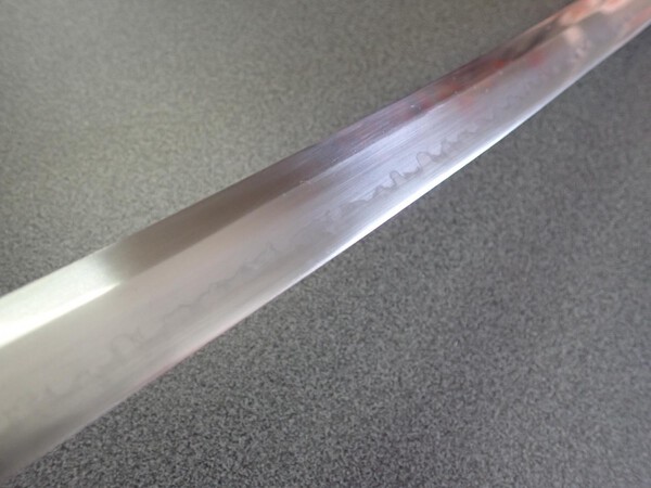

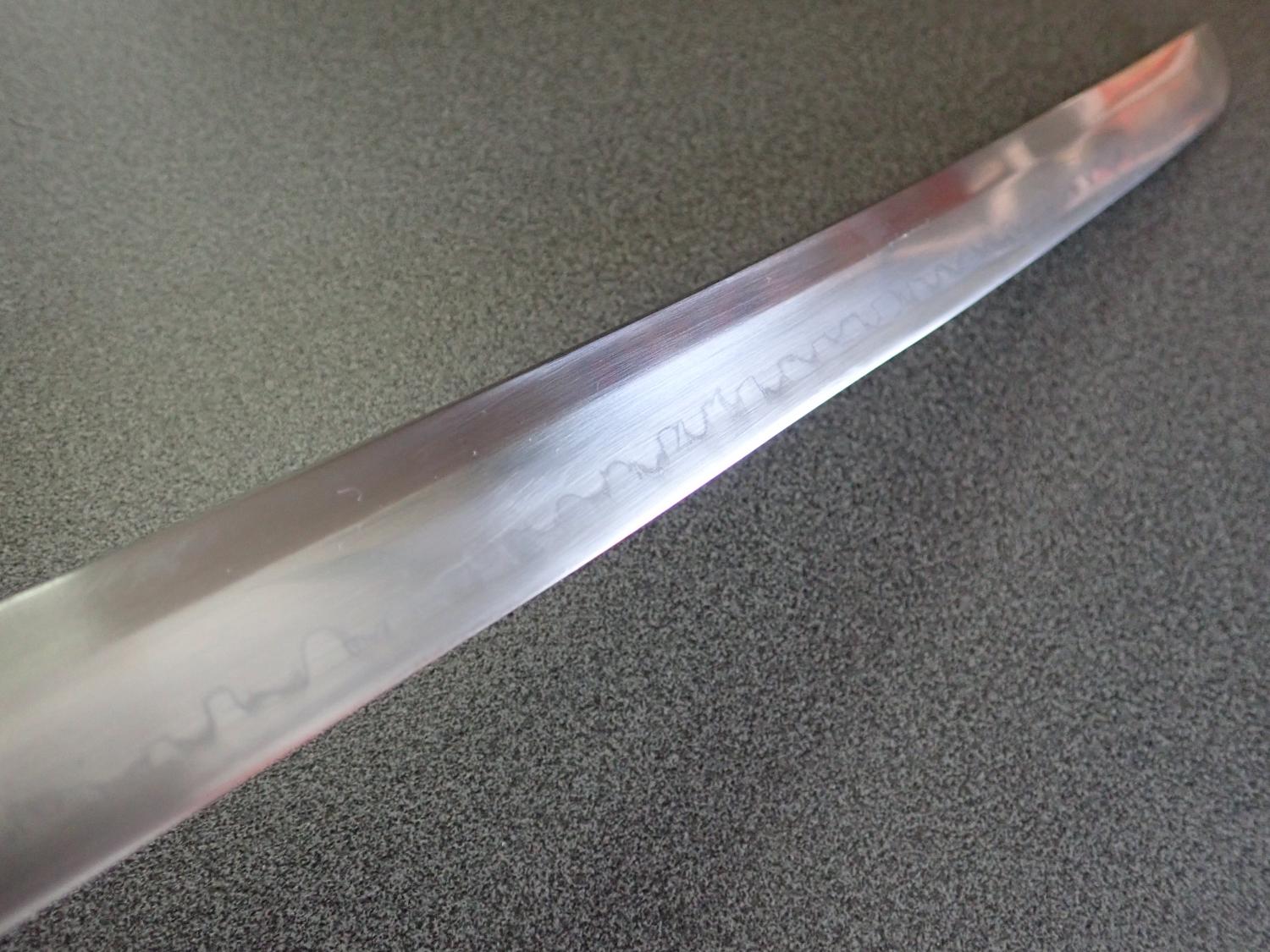

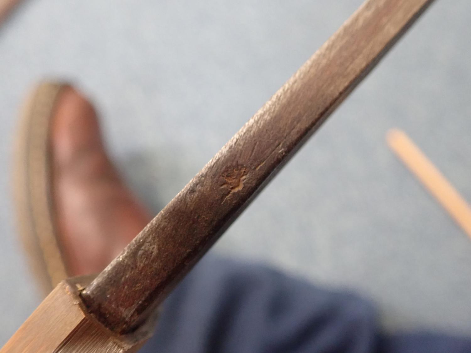

phil reid Posted August 17, 2019 Report Posted August 17, 2019 Hi Guys , First off sorry for bad pics weathers very ordinary but ideas on where who made this blade? in army fitting , tang is blank cheers Phil Quote
ROKUJURO Posted August 17, 2019 Report Posted August 17, 2019 83,2 cm NAGASA or overall length? Quote

ROKUJURO Posted August 18, 2019 Report Posted August 18, 2019 Phil,it could be a MUMEI GENDAITO, but the photos and the condition do not allow to see if there is HADA. The blade might have been water-quenched, and in this case you should show the blade to an expert near you (or on a sword show). Quote
16k Posted August 18, 2019 Report Posted August 18, 2019 Looks water quenched to me but tight nioiguchi with little activity. Quote

tbonesullivan Posted September 5, 2019 Report Posted September 5, 2019 In the last picture of the blade you posted, it looks like there is a WARE in the SHINOGI. Is it a lamination split, or just a scratch? Quote
