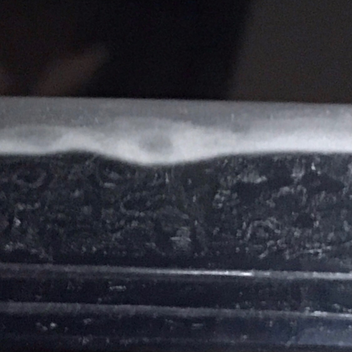

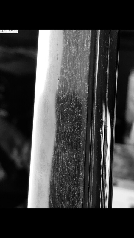

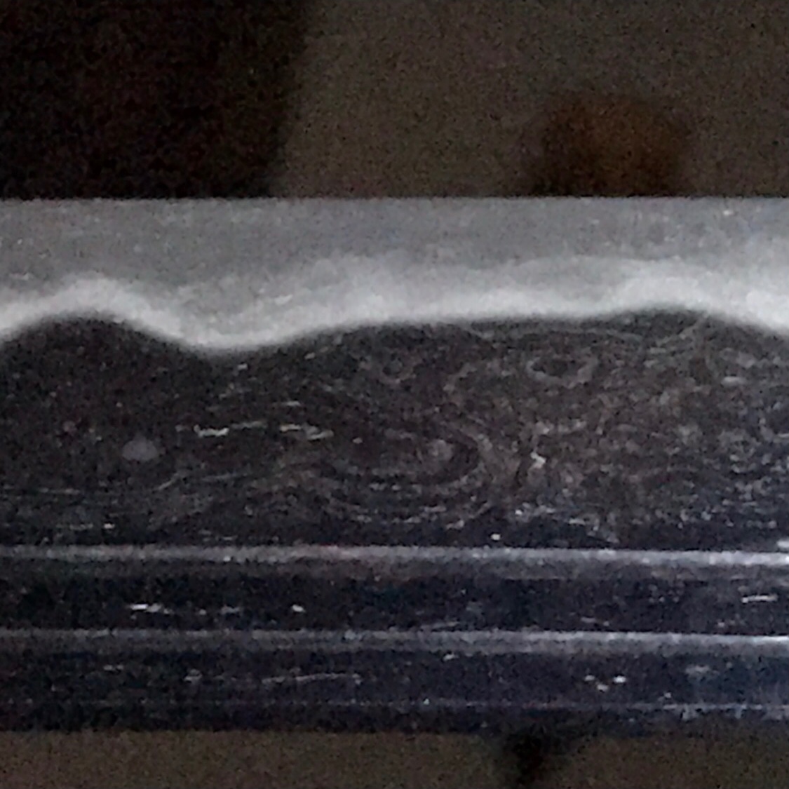

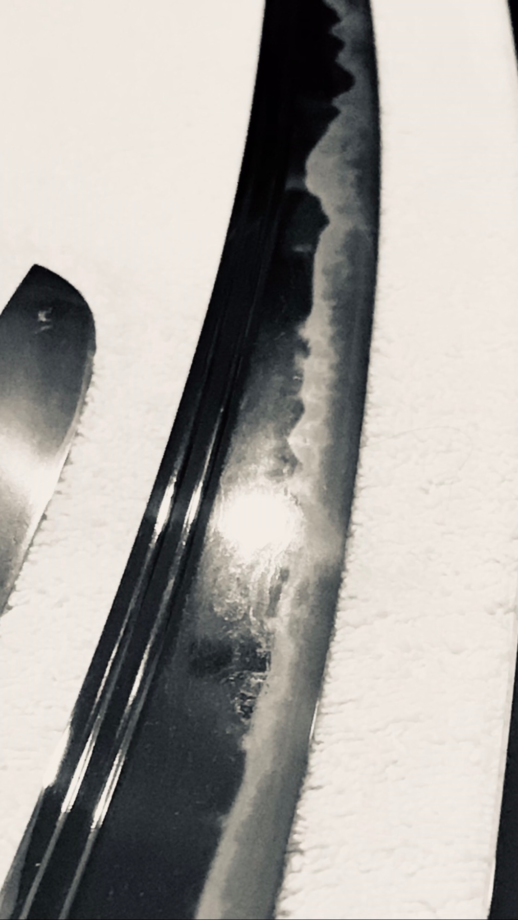

Utopianarian Posted February 29, 2020 Author Report Posted February 29, 2020 Finish polish on Soshu or maybe Soden Bizen. Graining in hada appears much more vivid. Itame hada and some burl mokume. Hamon shows more activity lower into Hamon (very difficult to capture in pics). Quote

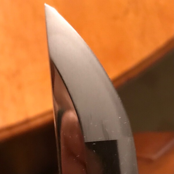

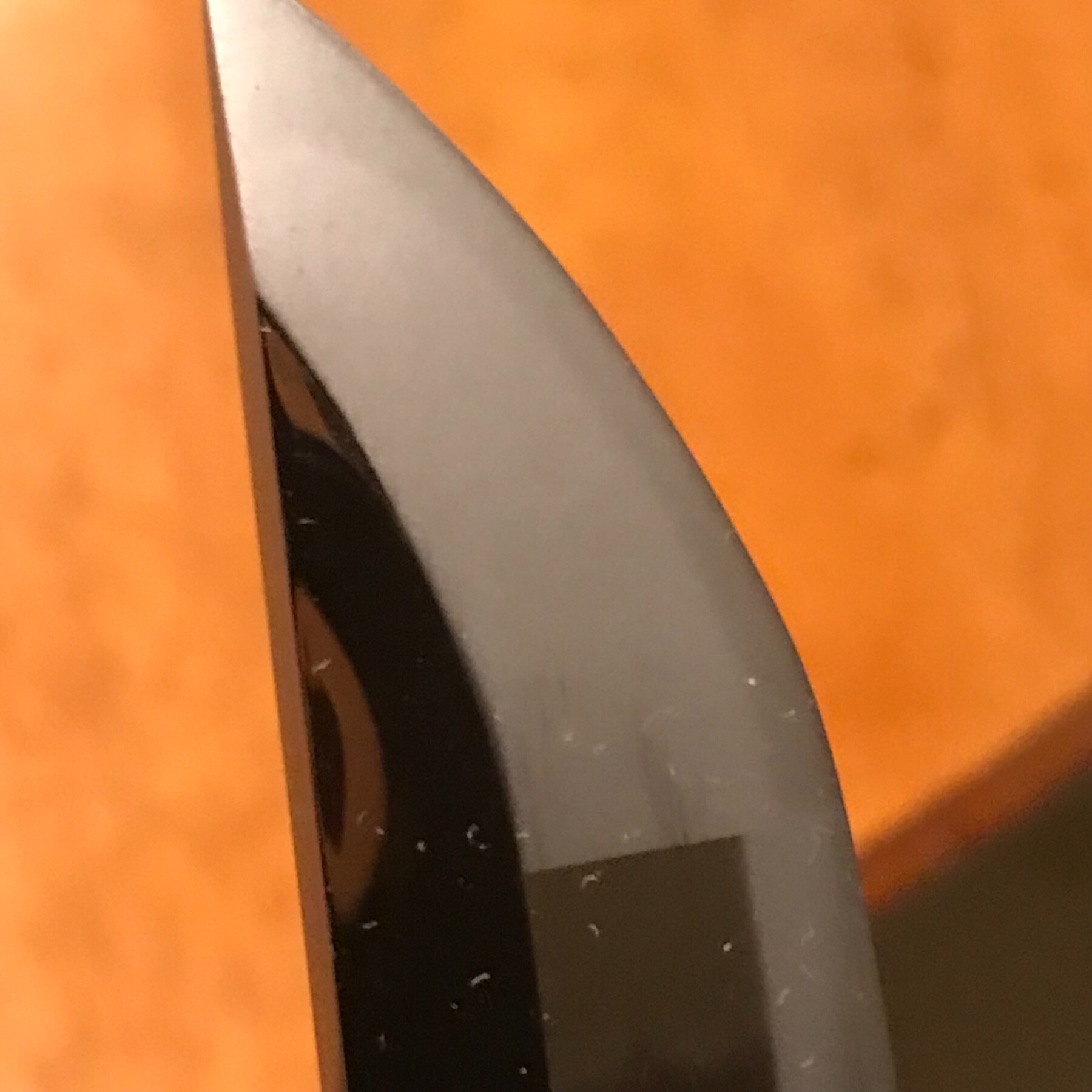

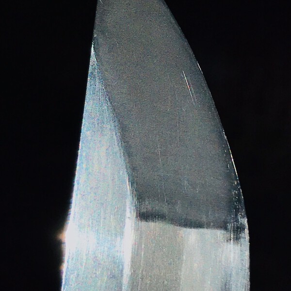

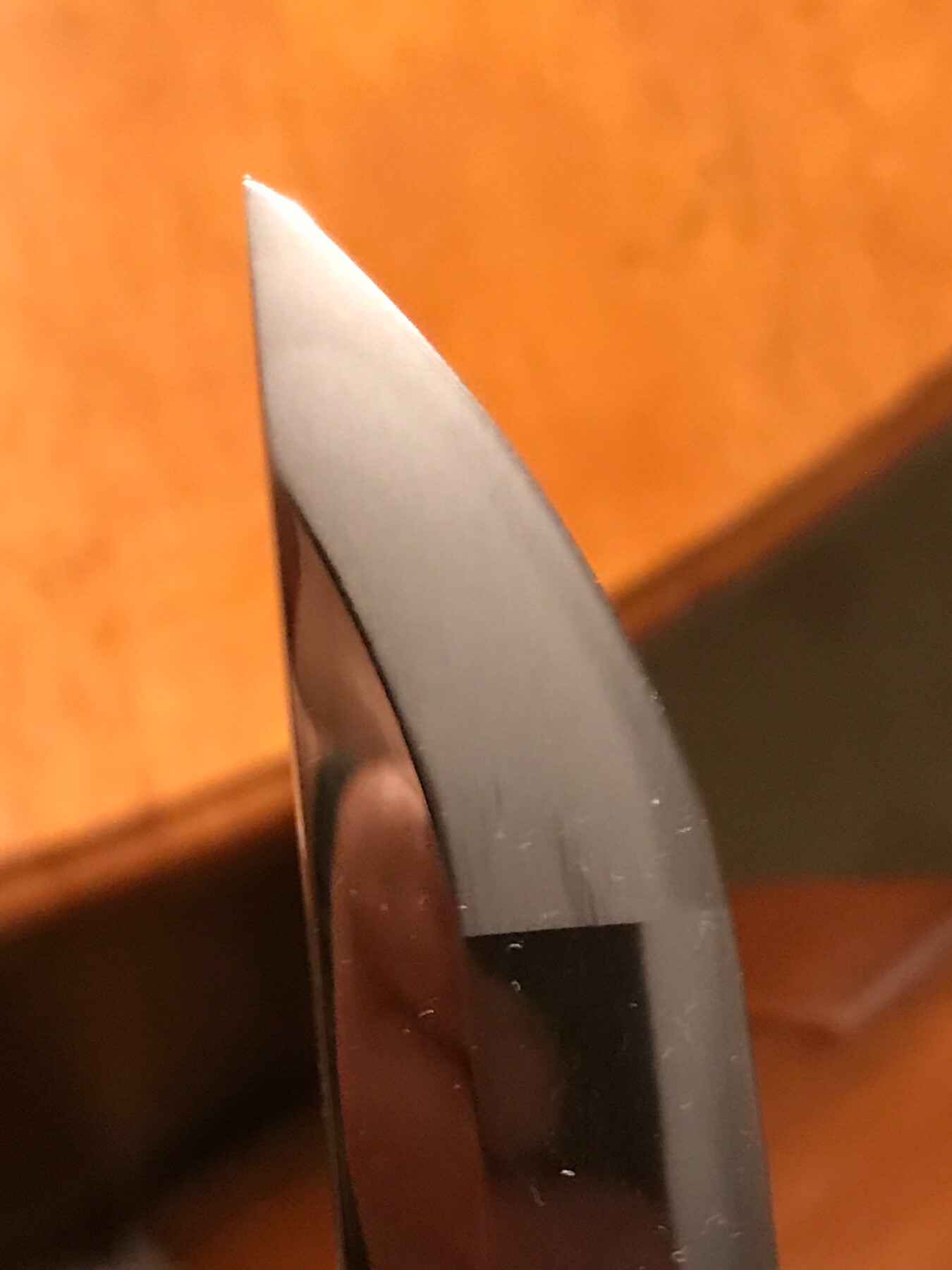

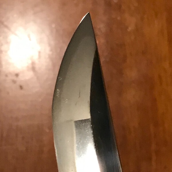

Utopianarian Posted November 29, 2021 Author Report Posted November 29, 2021 Here is best pics I can get of boshi. The original boshi was quite obscure and hard to make out-see previous pics of original boshi in this post before polish. After polish one was visible. I asked David was there a boshi there or did you make an artificial one. He said the original tempering on the blade wasn’t the best but the original boshi was intact. I know a blade of this age has condition issues. The boshi is the part that makes the attribution difficult on this one. Quote
Rivkin Posted November 29, 2021 Report Posted November 29, 2021 Thanks! Always glad for an opportunity to make prediction for a blade being submitted. Feels like mid Momoyama to 1650, likely the early portion of the interval. Regarding the school - so many similar ones. Can be along the lines of Fujiwara Nobutaka. Can be Fuyuhiro. 1 Quote

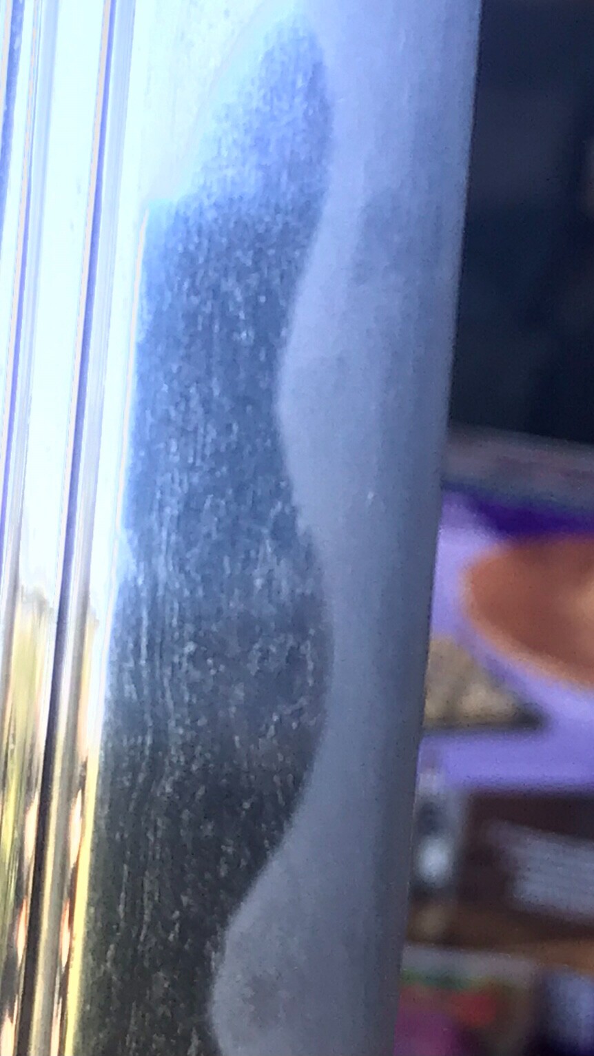

Utopianarian Posted August 18, 2022 Author Report Posted August 18, 2022 I have been trying to research this one for some time now. I have come to the conclusion that this must be a Hankei mumei blade. It has all the features of Soshu style work and the running Itame and burl Omokume pattern is identical to the works of Hankei. The activity in the hamon is similar as well. The overall shape of the blade didn’t quite set well with me. It didn’t quite have the shape of the older blades and seemed a little off. Here are some comparison pics of the running itame and omokume pattern. The first pic is Hankei Quote

Rivkin Posted August 22, 2022 Report Posted August 22, 2022 I shall be mean! Maybe I'll regret it once it papers to Norishige. But what's life without being mean and taking risks. I am near impossible to tolerate on better days and today I am in pain. The story repeats time and time again. Someone buys one, two, three, five blades. Asks for advice. Rejects what he gets. He has an expert friend, he saw early blades, what he has looks like photos of the famous blades he found online. The big issue - we are talking about 5 blades, 300K each, bought for 600$ on average. How do you convince the post office the package needs to be insured for 1.5mil??? In the real world: there is indeed a chance, but its admittedly small. Sugata is strange for anything early. Hamon is nioi based with some nie foaming at the edge. Jigane is not continued in the hamon. That's what Echizen Soshu is known for - distinctive belts of nie in hamon which are linked to jigane. Instead hamon has sort of clouds like appearance. Good news: unlikely Norishige, but one can aim for Go. Yet the jigane is coarse, it lacks chikei and ji nie, while at the same time there is very little nie in the hamon. Boshi is rather bland, no hakkikake, nothing. The most interesting thing is how its width collapses and calms down at yokote. That's not the true Soshu way. Early works can have a simple boshi, maybe it would do yakitsume and full Yamato style appearance. But it is not really the style here. Its a sort of attractive sword and is indeed made after Etchu Tametsugu or Go. It can be Hankei, but that would be on really lesser portion of his creations. Can be Etchu Tametsugu, VERY broadly defined... But on the other hand looks very much like one of many late Muromachi+ smiths. Fuyuhiro, Uda, Kaga, Shitahara etc. Can be one of a few people who forged such hada in shinto. Just imagine the smirk with which you can prove arrogant pricks like me wrong. Shinsa it. We know you want it. P.S. We all been there with a precious blade or two that no one else understands. 4 Quote

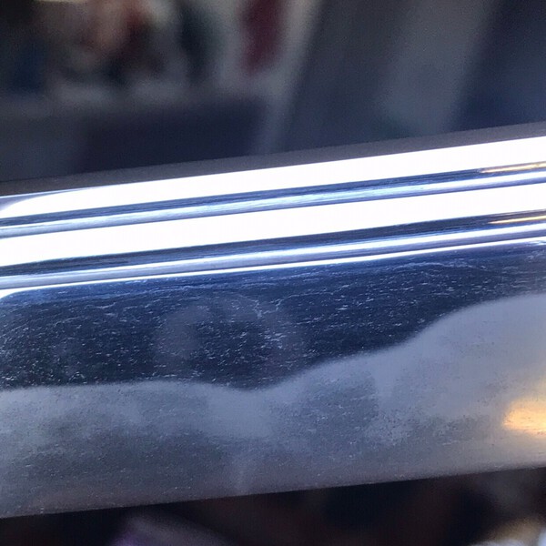

jsv Posted August 22, 2022 Report Posted August 22, 2022 It went from this nice colour to that dark, well dark finish. I think the original polish was more close to the smiths intentions so stay away from non professional polishers. In future you will save money and get a better polish from start. 3 Quote
PNSSHOGUN Posted August 22, 2022 Report Posted August 22, 2022 Not sure if having it polished by a non-traditional polisher before being papered was the right approach, the original polish was completely acceptable and in many ways better. Fingers crossed when you do send it for Shinsa it's something decent. In terms of having it valued for insurance when sending that's where having a proper appraisal by a qualified Togishi would lend some credibility to a claims report. 1 Quote
Utopianarian Posted August 22, 2022 Author Report Posted August 22, 2022 Thank you all for the excellent advice and take on this one. Tough to pin down as it appears drastically different in alternative lighting sources affecting color of jigane and appearance of hamon. Yes I have learned traditional togishi is the only way to go. I was too ignorant and thought I knew what I was doing. I have leaned many of you through your collective experience and wisdom have seen every scenario and outcome thru many years dealing with this kind of stuff. Here is another pic and of course it looks drastically different than others 1 Quote

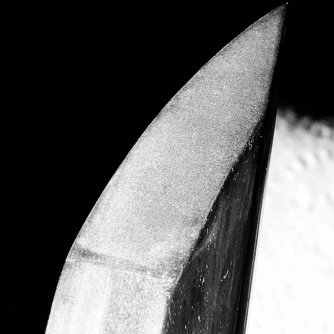

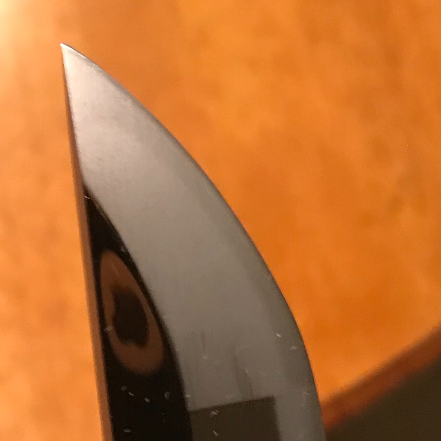

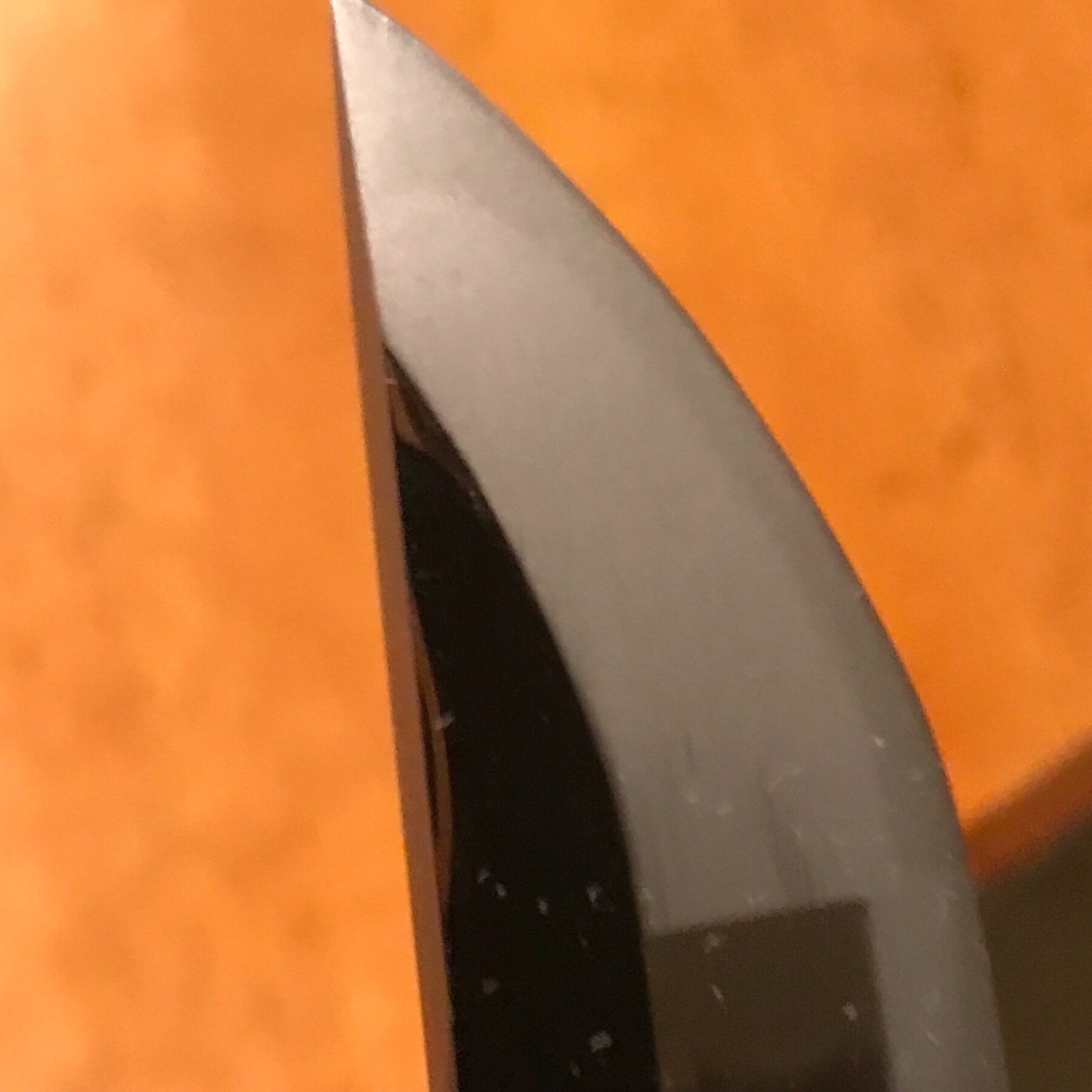

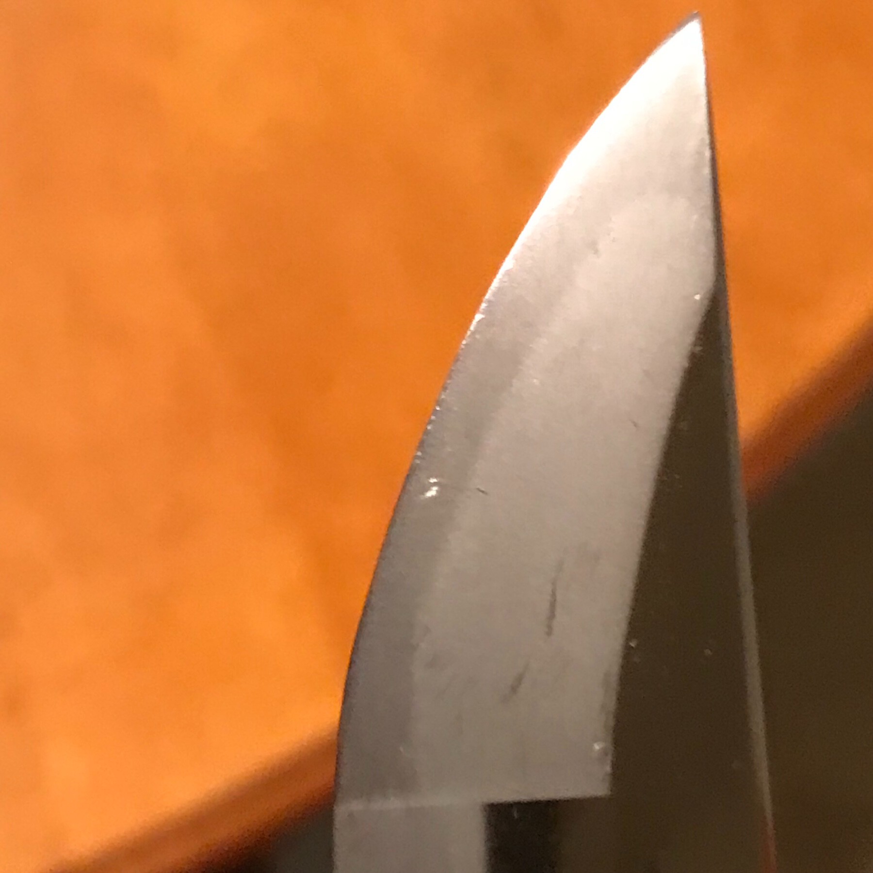

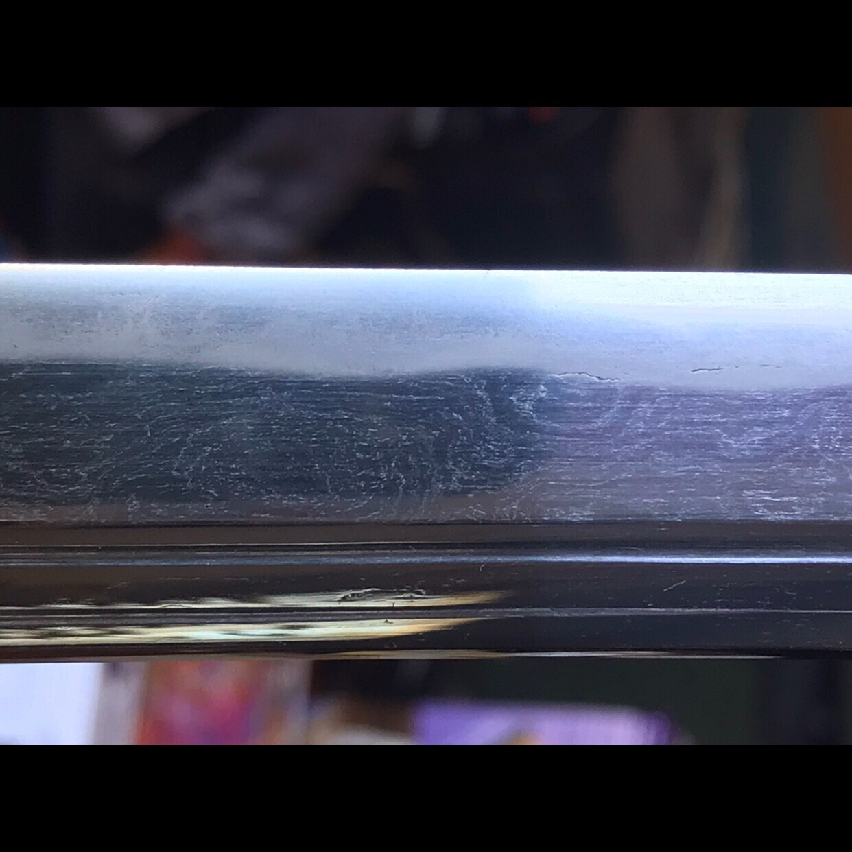

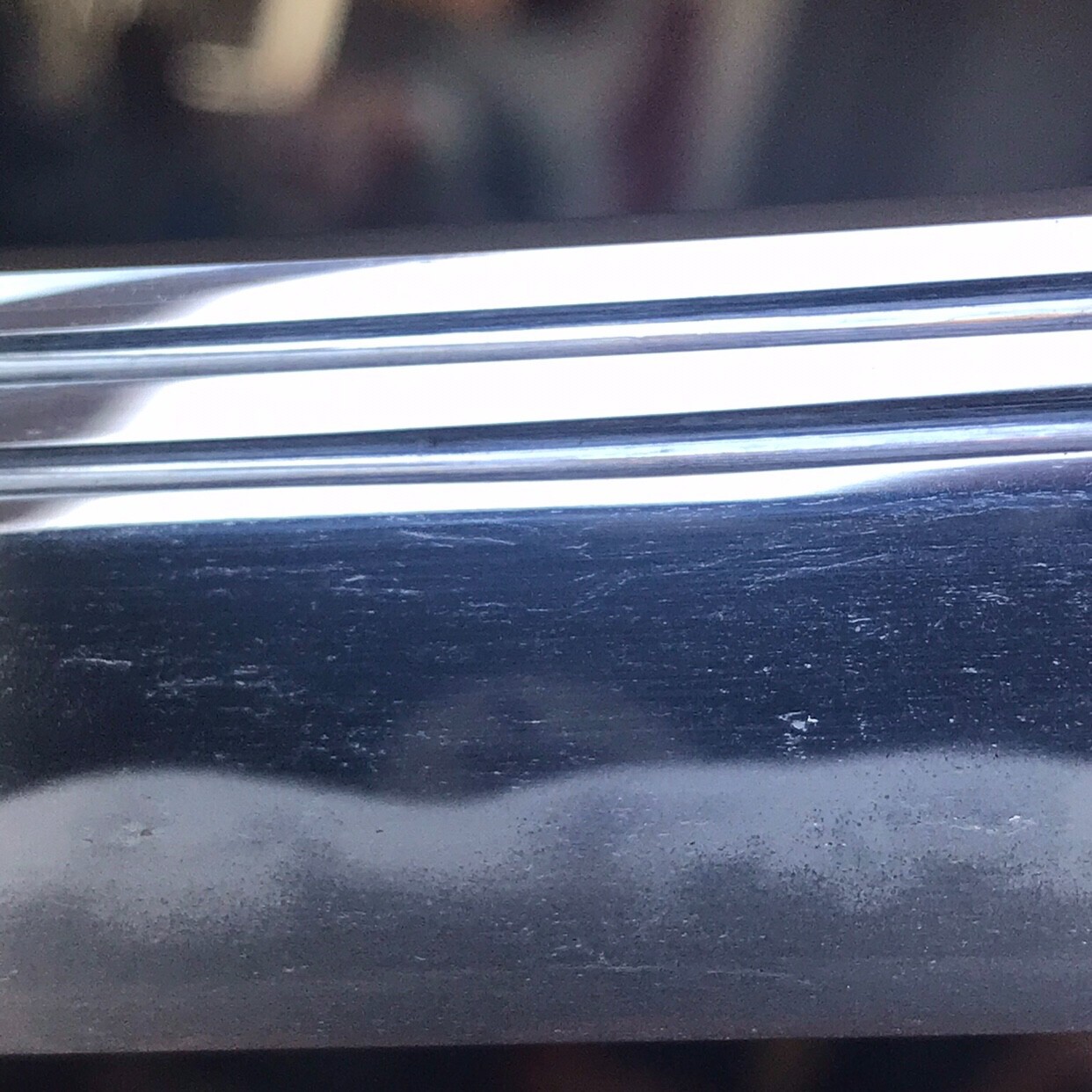

Utopianarian Posted August 22, 2022 Author Report Posted August 22, 2022 Kirill, You are absolutely correct regarding boshi. It also did not seem right to me and didn’t match the rest of the blade and what you would expect. I have my doubts with the polisher when I asked if the original boshi was still there. I believe the boshi was added and looks cosmetic to me. Look at the first 3 pics attached which were original before polish and the last 2 pics after polish. The first pics before polish look more appropriate for the rest of blade and making a better guess. 1 Quote
