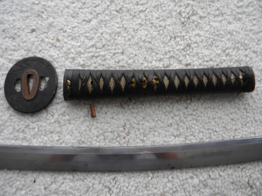

My Nisei dad and mom received this gift from her father when they were married in Japan after WW2. My grandfather was sensei and had his own kendo dojo. We lived in Japan for 2 years in the early 1960’s when my dad was stationed in Korea with the 25th infantry division. I was in junior high school at that time. We visited my grandfather during the summers and he came to visit us in Tokyo several times.
The katana was kept at my uncle’s home in Hawaii down in their garage. What you see in the pictures is it’s condition after my dad retrieved it in the 1980’s. Termites destroyed the wood Saya and the Tsuka is what’s left. My mom is now 92 and we are thinking about what to do with the katana. I think we would like to try and bring it back to the condition it was; when it was gifted. We would like to find out how to do this and what it would cost.
I believe we will keep the legacy in the family.
Comments and any other thoughts would be appreciated. I am not well informed on these matters.
We have two other katana. One that my dad won in a kendo tournament in Hawaii when he was in high school. Another that my dad brought back from the Philippines. He was stationed there in MIS under General MacArthur during WW2. These are still in excellent condition as they were always kept here.
Thanks.
- RayM

Hi RayM,
Bob Benson in Honolulu is a properly trained polisher; he can advise and take care of restoration for you.  He will be at the show in San Francisco this weekend or you'll find him linked at the top of this page (look for Bushido).
Grey

Grey,
Thanks, I saw the announcement of this show Aug2-Aug4 in Burlingame on someone's Facebook page? SF Marriott Waterfront. If Bob Benson is available, I can go up there and show the katana to him and get his advice. Will try to reach out to him today.
Ray

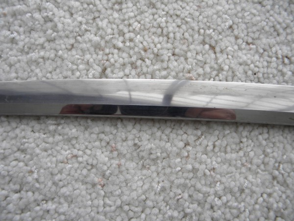

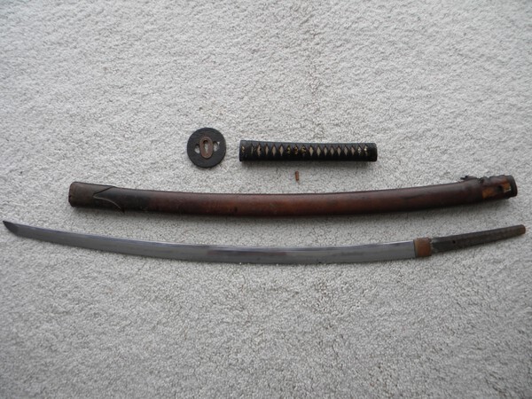

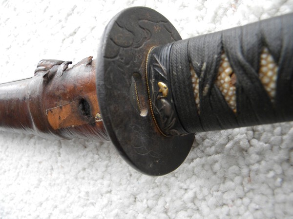

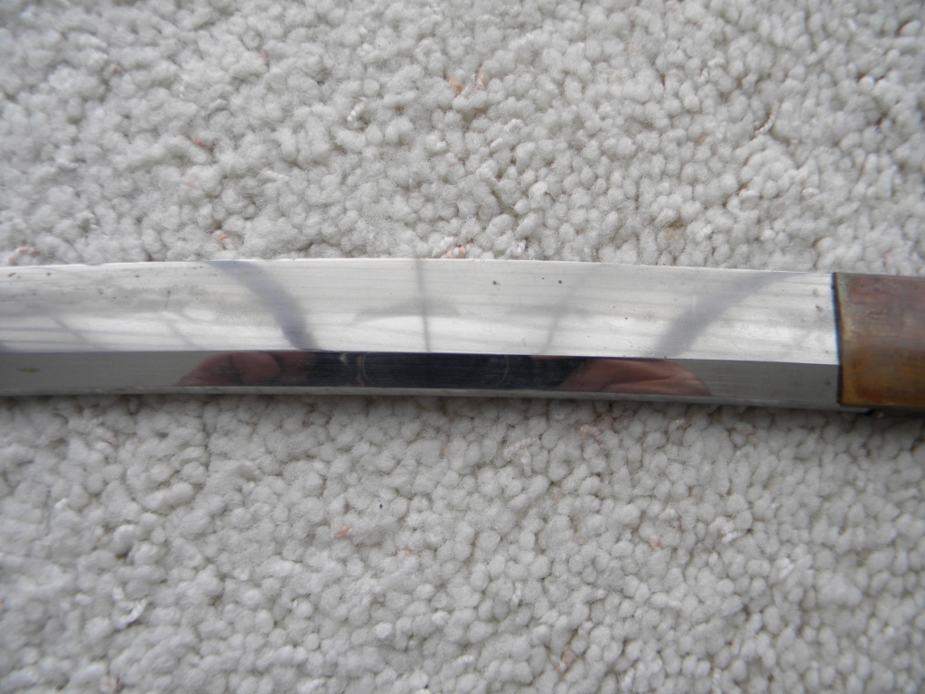

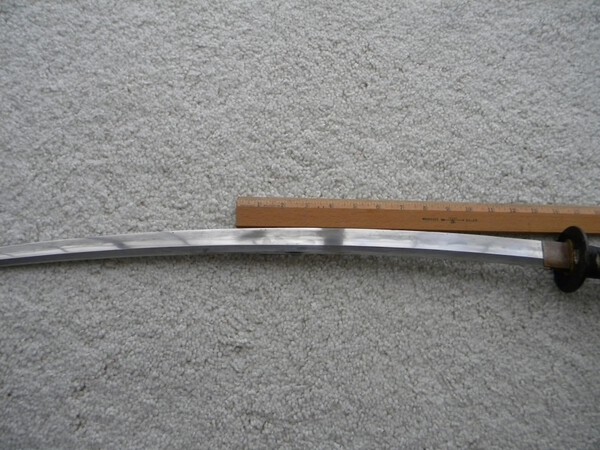

Blade 2: This is the katana that my dad purchased in the Philippines. My mom says that he got it from the Filipino who killed this Japanese officer. She says that only the officers had katana; given to them by their families. Usually the best katana owned by the families were gifted to them and, as we know, they were expected to die; or return only in victory…Bushido.
The katana seems to be in “good” original condition. There are blemishes and what look like stains (could be blood) and the Ha has some small nicks. Unlike the other katana, this one was oiled occasionally and kept indoors:
- RayM

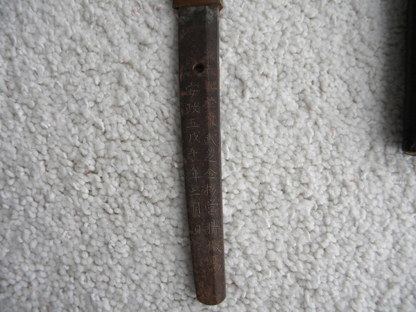

I believe the signature of the second sword is following.
Omote: 源元興於東武芝金杉営精鍛焉 / 安政五戊午年二月日
Ura: 太々土壇場同年三月十三日於千住 / 山田吉利門八後藤利影試之
Smith is Minamoto Motooki and sword is made in 1858. I struggled a bit with the cutting test and when I had it almost correct I found really similar cutting test on another Motooki sword that is NBTHK Hozon: http://www.sword-auction.jp/ja/content/as151023-%E8%84%87%E5%B7%AE%EF%BC%9A%E6%BA%90%E5%85%83%E8%88%88-%E5%AE%89%E6%94%BF%E4%BA%94%E5%B9%B4%E4%BA%8C%E6%9C%88%E6%97%A5%E8%A3%81%E6%96%AD%E9%8A%98-wakizashi-minamoto-motooki-cutting-test
Unfortunately I am not well versed in cutting tests. I am getting some help from Aoi's English literation of the cutting test on their site. It seems that on the sword posted in here Yamada Yoshitoshi & Goto ??? as the test cutters. Taitai is a cut through torso at shoulders in Yamada terminology. And I think the cut was on earth mound dotan.

Re the second katana: Up to this point I have assumed that the officer had been killed in battle by the Filipinos. However, the physical evidence on the katana itself may point to a different scenario. That is, at his request with his own katana, the Japanese officer may have been executed by the Filipino after capture and trial.
If you are a bit squeamish DO NOT READ FURTHER.
One could imagine a scene where the Japanese officer is kneeling, blind folded, head bent over. The Filipino is standing just behind and on the officer’s left side; the Filipino being right-handed. The katana is swung down and slicing right to left, top to bottom, through the neck muscles just above the heavy spinal bone and through….BANZAI.
This would have been consistent with the desire for a ritual death; in keeping with the samurai tradition. Afterwards, the Filipino had no desire to keep the sword; which is why my dad was able to buy it…cheap.
If you look at the photos below, the visible blemishes have symmetry and correspond basically to the outer width of my own neck (4.5 inches wide) which would make that officer just about my height and weight. The two symmetric blemishes are only on one side of the katana; the bottom side, if the sword was swung by a right-handed person.
That being said, I am not a forensic expert and people can have their own theories. My dad never documented this katana and is no longer here to confirm or deny….
