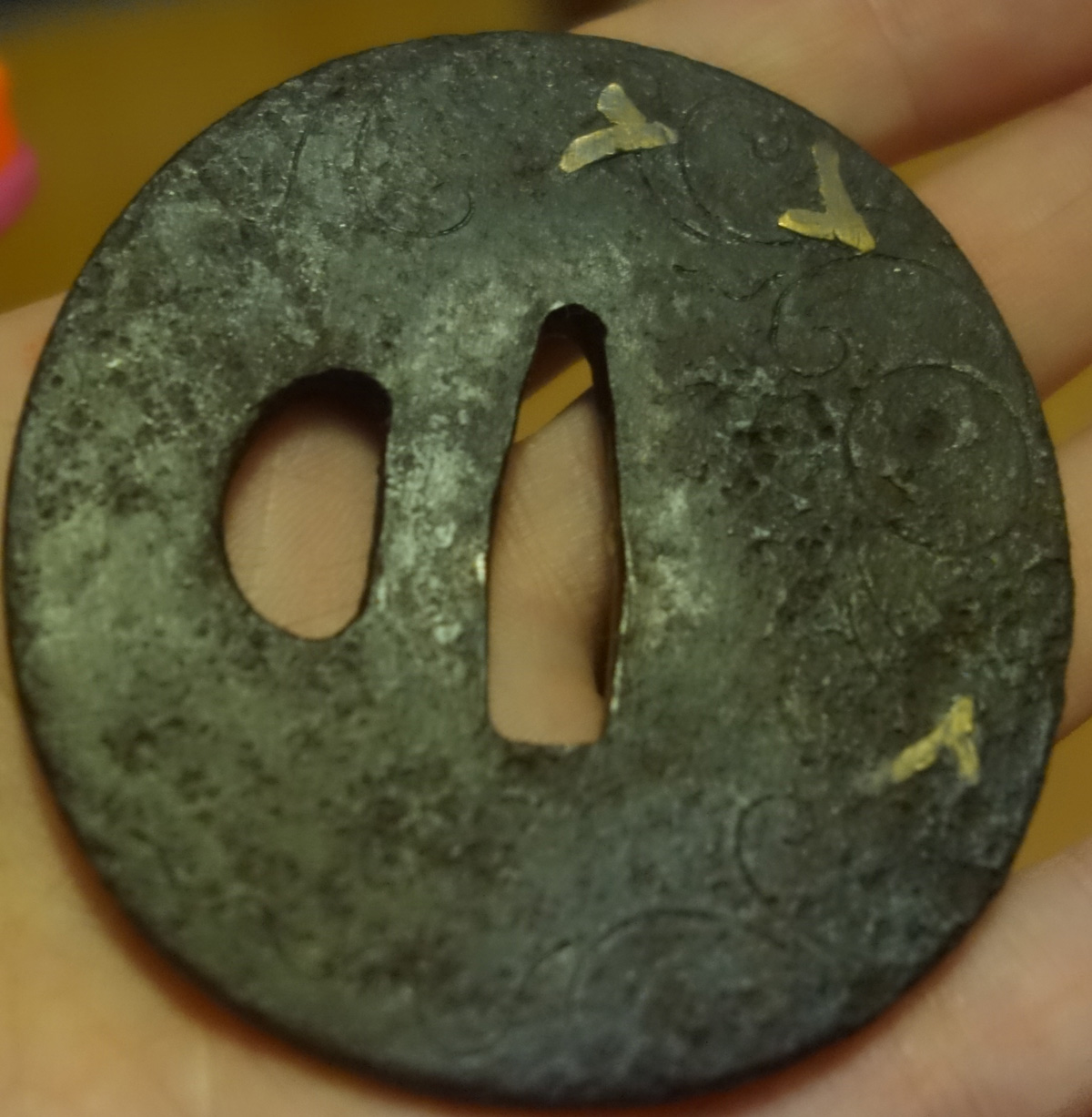

TheGermanBastard Posted July 29, 2019 Report Posted July 29, 2019 I have this Heijano Tsuba and wonder if it is an earlier Type and if the some of the inlay work is missing or wheter it was supposed to be tht way in the first place? Quote
FlorianB Posted July 30, 2019 Report Posted July 30, 2019 I think it’s a later work, which isn’t as elaborate executed as older ones. The kiku blossom on the back side is missing (the empty circle). Maybe the tendrils should have been filled with brass wire, too, but either all has gone or it was never completed.However the carved tendrils make a nice contrast to the filled areas so take it as a study piece.Florian Quote
TheGermanBastard Posted July 30, 2019 Author Report Posted July 30, 2019 @ Chris, no I do not think that there is fire damage. "Just" poor condition due to corrosion. @ Florian: Thank you for your remarks and pointing out the missing Kiku blossom! I had missed this. I suppose this is just a simple work in poor condition then. Whetter the inlays got lost or did not get ever added in the 1st place is to remain unknown. The disappointing result is however the same in the end Quote

Henry Wilson Posted July 30, 2019 Report Posted July 30, 2019 The deliberate absence of inlay would be the requisite of a relatively high level of wabicha aesthetic. I think it would have been wasted on and misunderstood by the target customer (hey, I'm not buying this the inlays missing!) to be honest. So I would say that the Inlay was there but it got lost sometime. As far as categorising things go, the tsuba above have a brass colour inlay to be sure, but are they Heianjo zogan? I feel they are lacking something IMO. I would say Shoami based on what I see and my reptilian intuition. 3 Quote
Henry Wilson Posted July 30, 2019 Report Posted July 30, 2019 The second one Heianjo zogan, but the first? Quote
FlorianB Posted July 30, 2019 Report Posted July 30, 2019 If we assume, the tendrils should have been contain brass wire, a later Heinajo-style attribution is acceptable. We can only speculate, why this Tsuba shows the todays appearance, but with all due respect I would be careful to connect a decent quality with wabi-sabi aesthetic.There has been a discussion about this subject a time ago ( http://www.militaria.co.za/nmb/topic/26501-which-of-your-tsubas-best-embodies-the-wabi-sabi-aesthetic/?hl=wabi-sabi ) and a lot could be learned from this great thread about it. Florian Quote
Henry Wilson Posted July 30, 2019 Report Posted July 30, 2019 Thank you for the comments Florian. with all due respect I would be careful to connect a decent quality with wabi-sabi aesthetic. This is very true and something I am quite aware of. My point is that relatively speaking, the first tsuba's condition and quality would be more indicative of lost zogan rather than a deliberate design feature IMHO. 1 Quote
