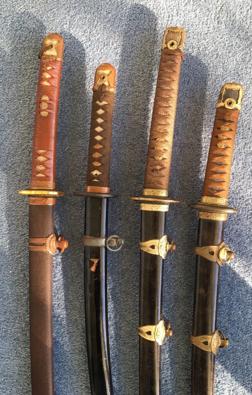

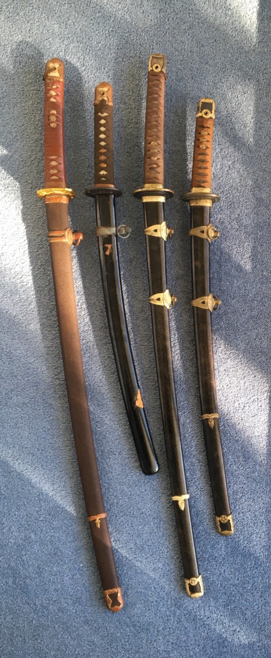

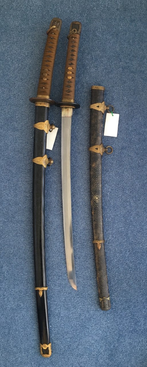

IJASWORDS Posted August 12, 2019 Author Report Posted August 12, 2019 It happened in the IJN as well . A wakizashi length Kai Gunto. See photo against standard length sword. Must be from a submarine crew. Only joking , but I have seem them marketed this way . 4 Quote
PNSSHOGUN Posted August 12, 2019 Report Posted August 12, 2019 Interesting that the handle is the same length as a normal sword, I would say wakizashi size swords in full or slightly smaller size mounts are more common than these miniature examples. If the officer had money they could get anything mounted however small or large they wanted. 5 Quote
IJASWORDS Posted August 12, 2019 Author Report Posted August 12, 2019 John , some examples of shorter swords with shorter handles , both army and navy . 4 Quote
vajo Posted August 12, 2019 Report Posted August 12, 2019 What the nakago says Michael? Btw a nice waki and the koahirae looks very good. Quote
